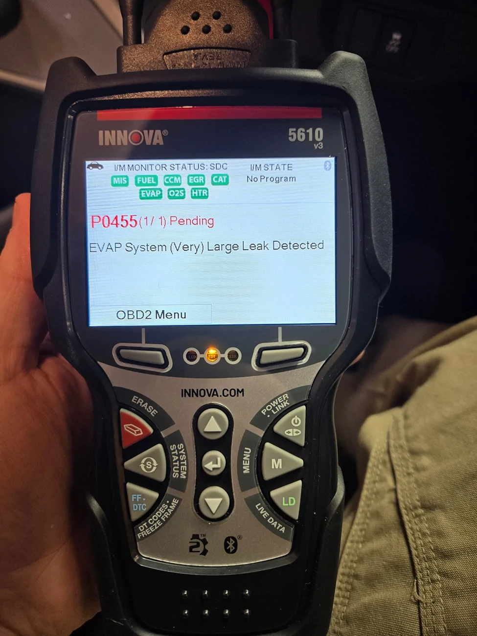

This is what I'm seeing. Haven't looked into it further. Just did the check over my lunch break. Description seems very concerning though. Besides the pops issue, car ran fine otherwise this morning when I drove it.

did u get the string of warning messages on startup about rev matching, cruise control etc etc being disabled or whatever? it's like a whole slew of various systems that get affected by it. i'm pretty sure all of us with these cars have gotten it at some time, typically pretty early in the car's life. i got mine at 4 - 5k miles i think.
either way clear the code and drive it for a bit for everything to reset. if it comes back i would take it in for servicing. they never came back for me.

Not serious unless it comes back, which is why it's pending...it's waiting to see if it throws that code again. I think the evap stuff is usually related to leaky gas caps/fuel filler necks, etc. I dealt with an intermittent one on my wife (and eventually son's) Equinox. I'd recommend clearing it and driving for a while to see if it comes back. Might just be an anomaly.
