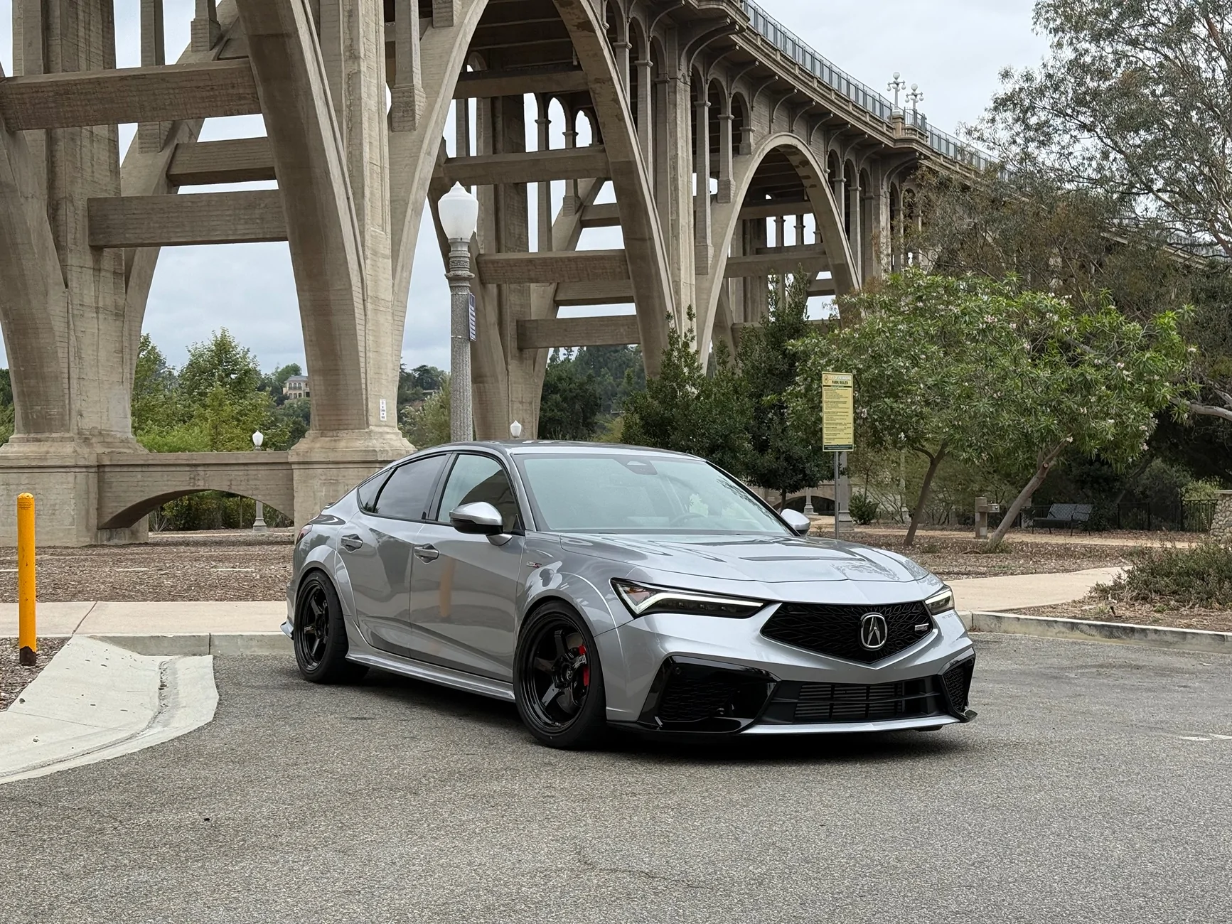

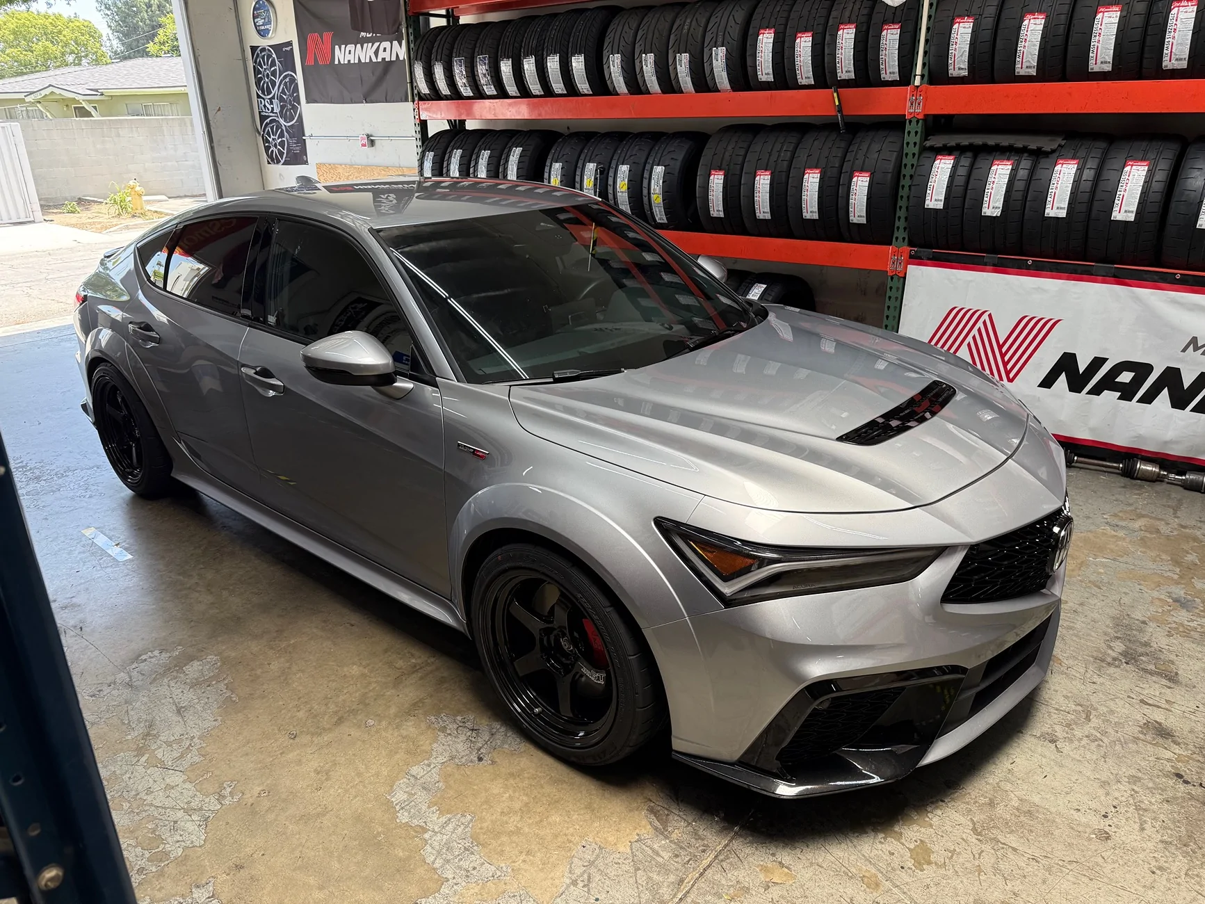

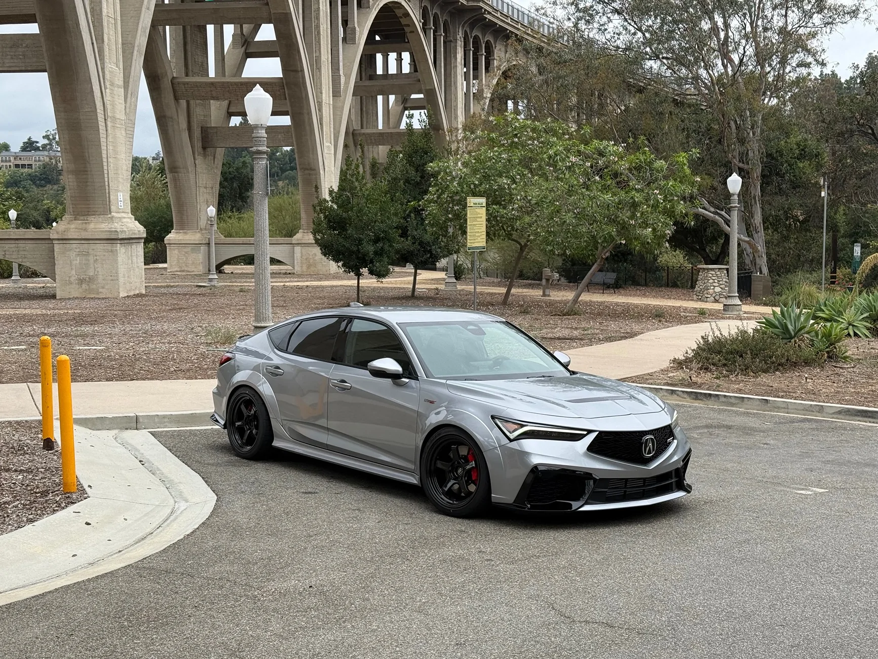

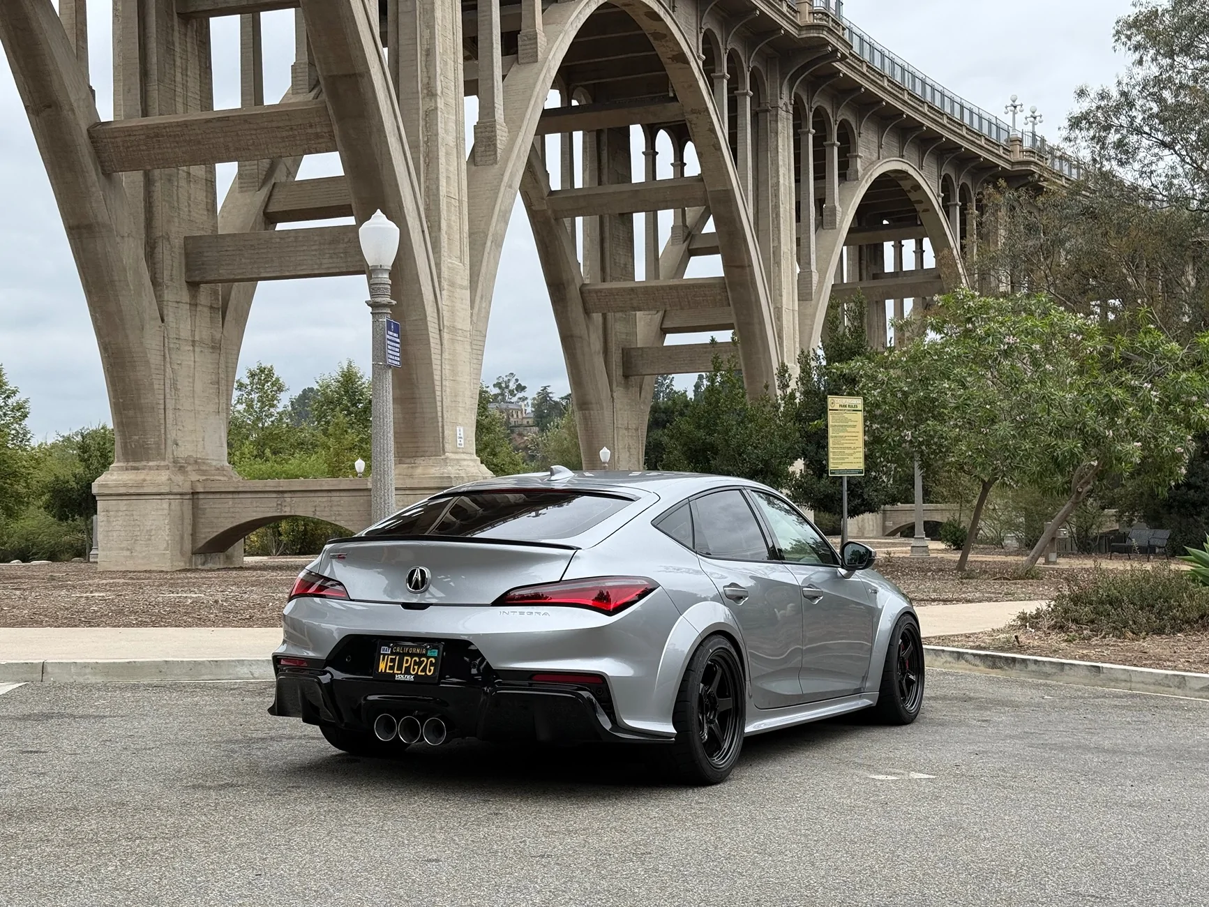

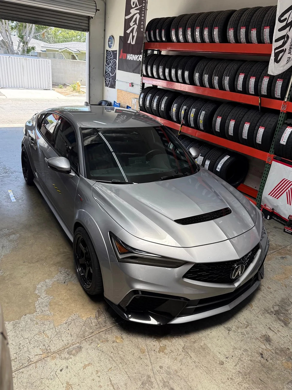

Wheels/tires on! I ended up just going with RT615K+, 275/35/18. I should be able to get similar mileage out of them and the canyon/track performance will beat the PS4S or ECS02. Plus they were cheaper than PS4S and equivalent to the ECS02. I'm loving the black on silver color scheme. The wheel gap is killing me now, so springs will be coming soon.

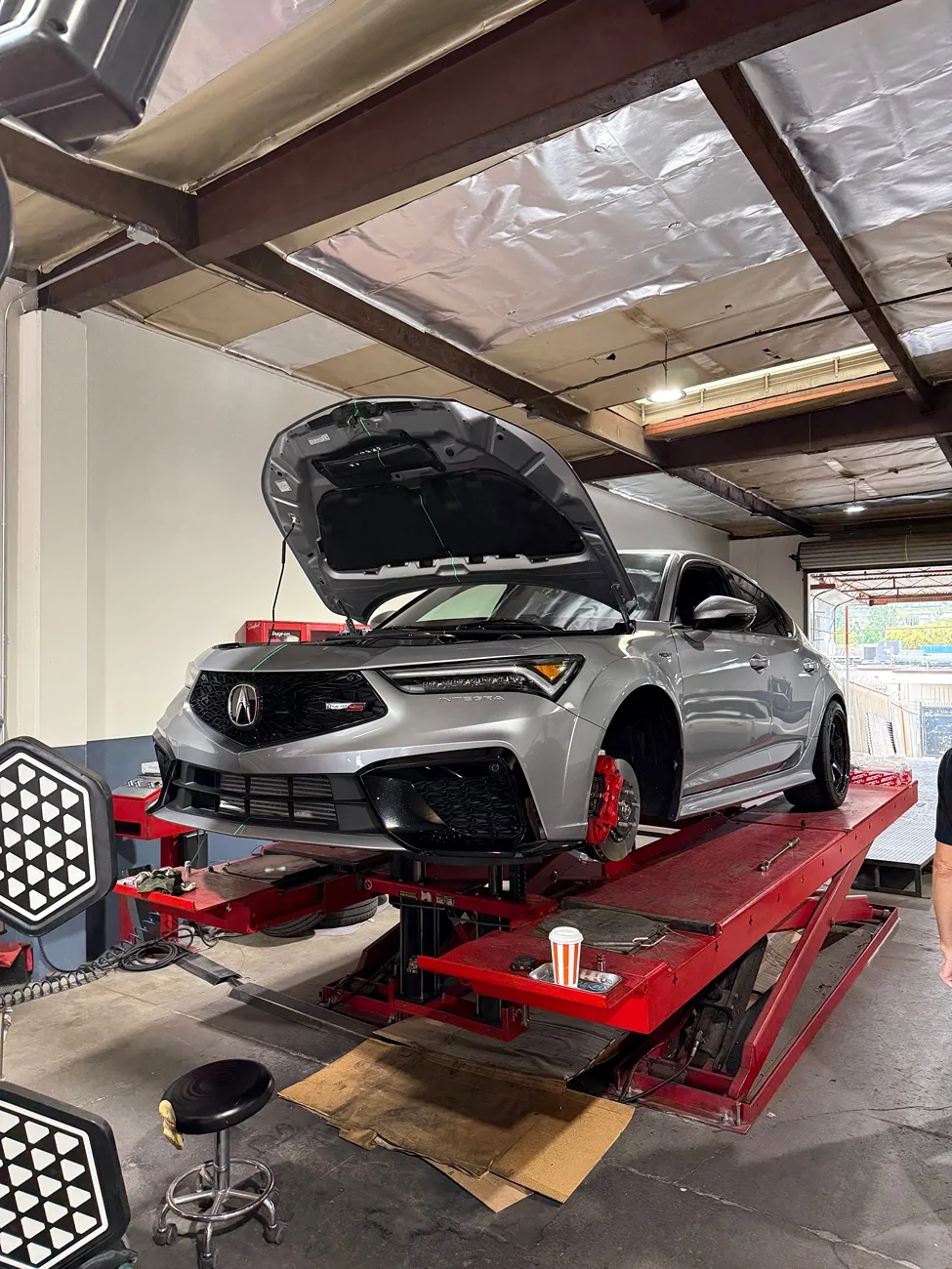

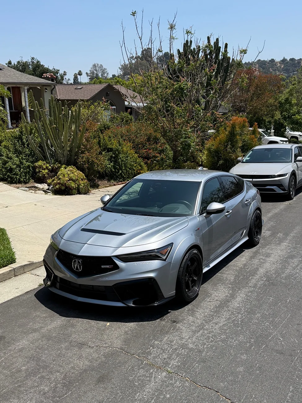

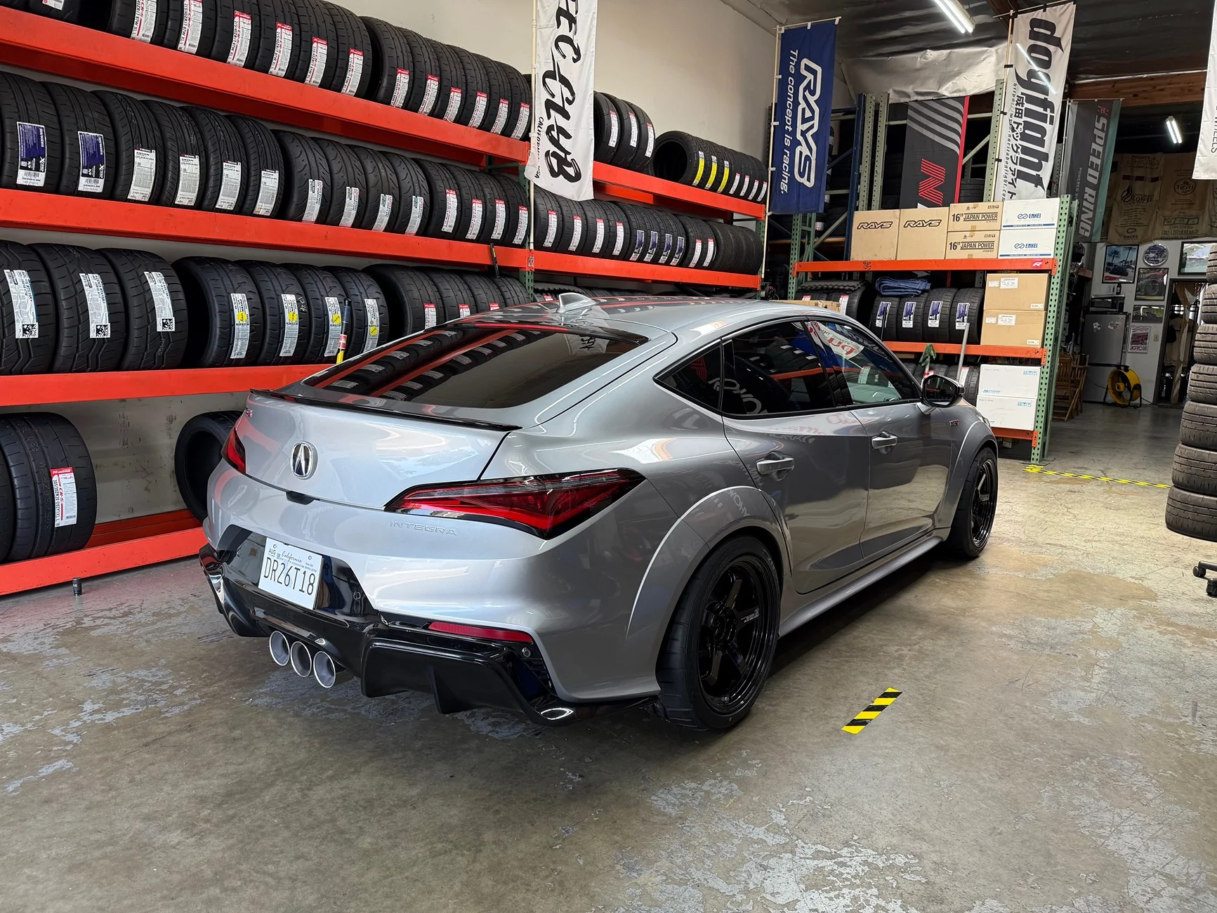

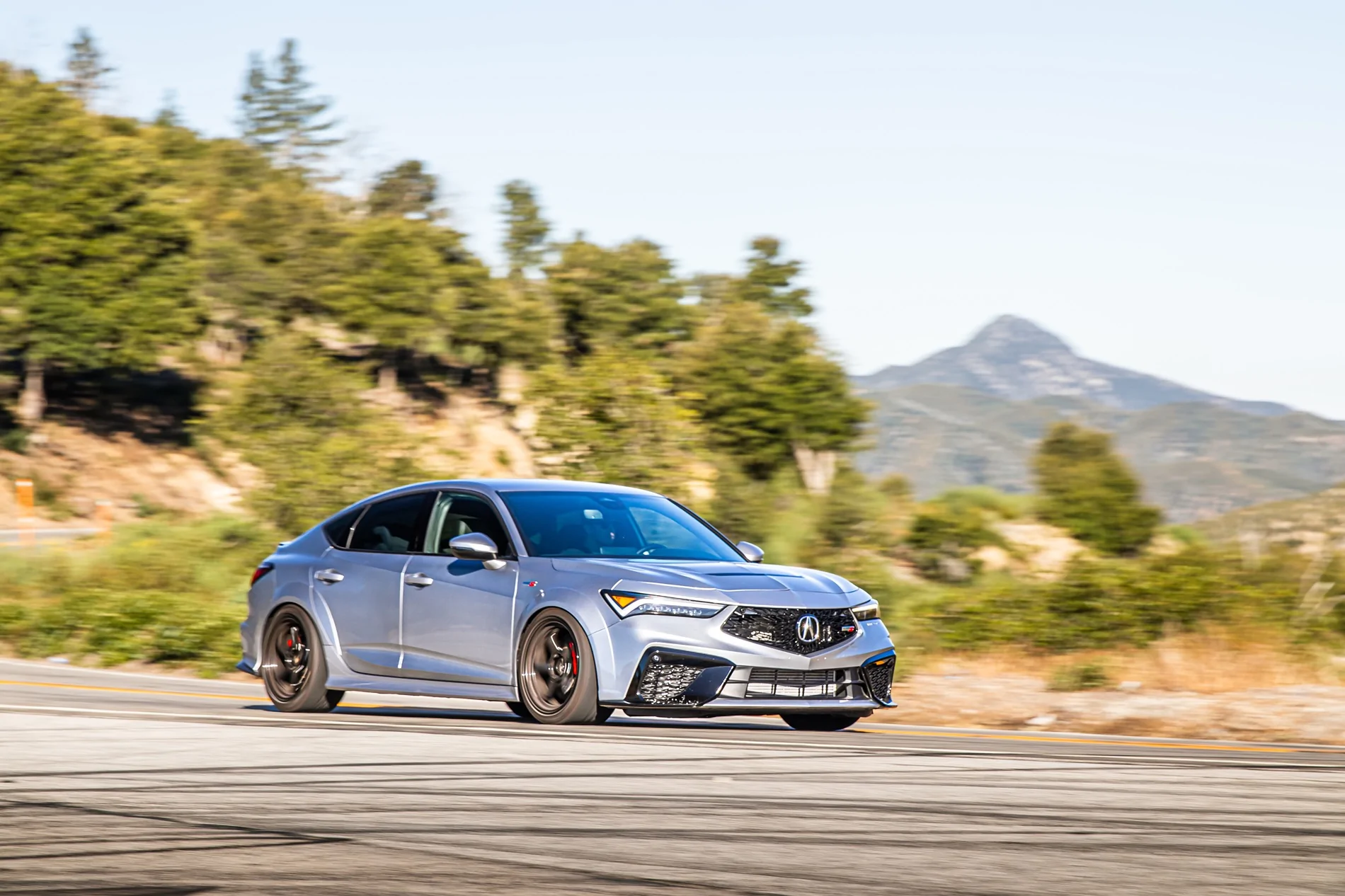

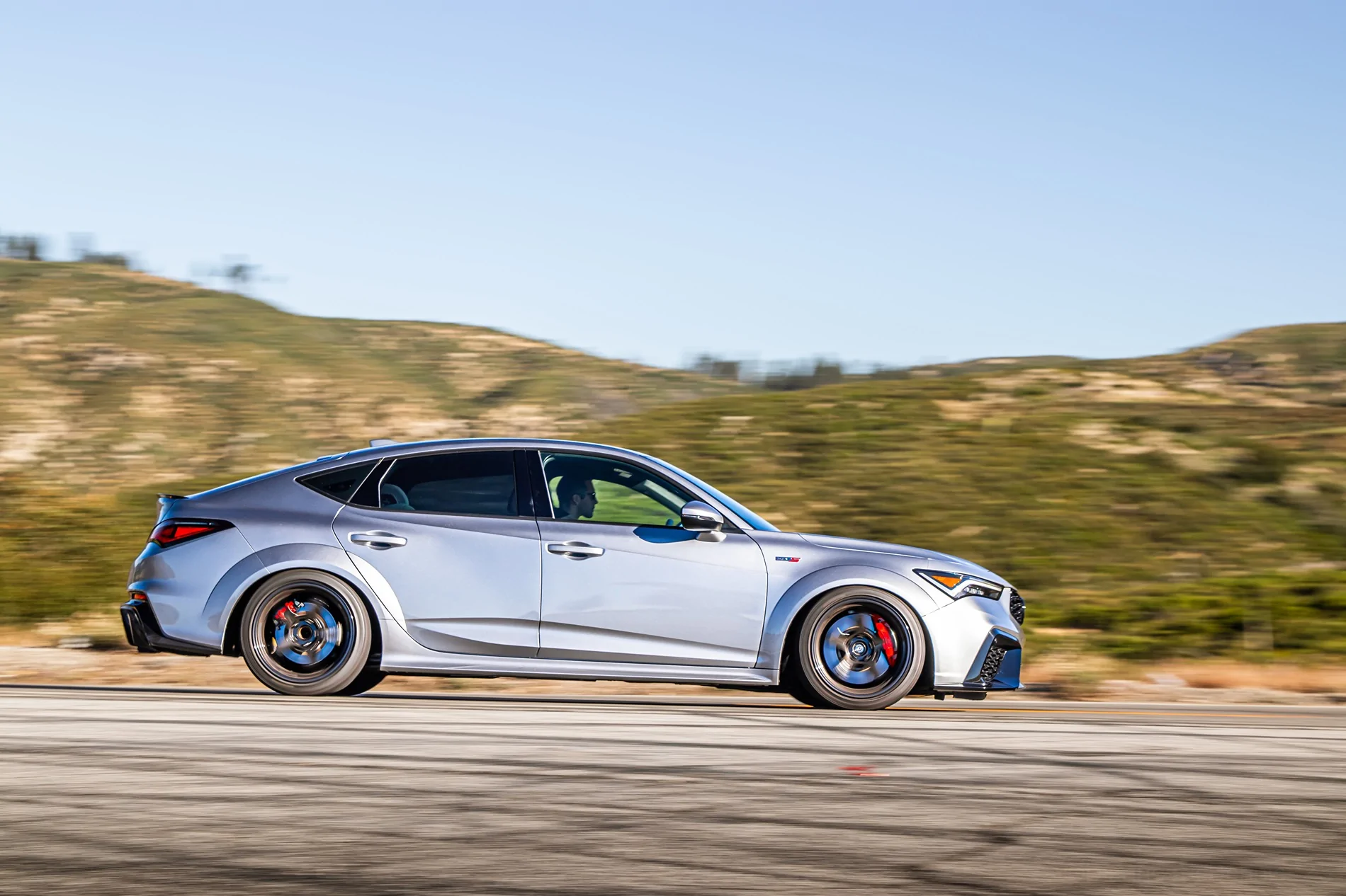

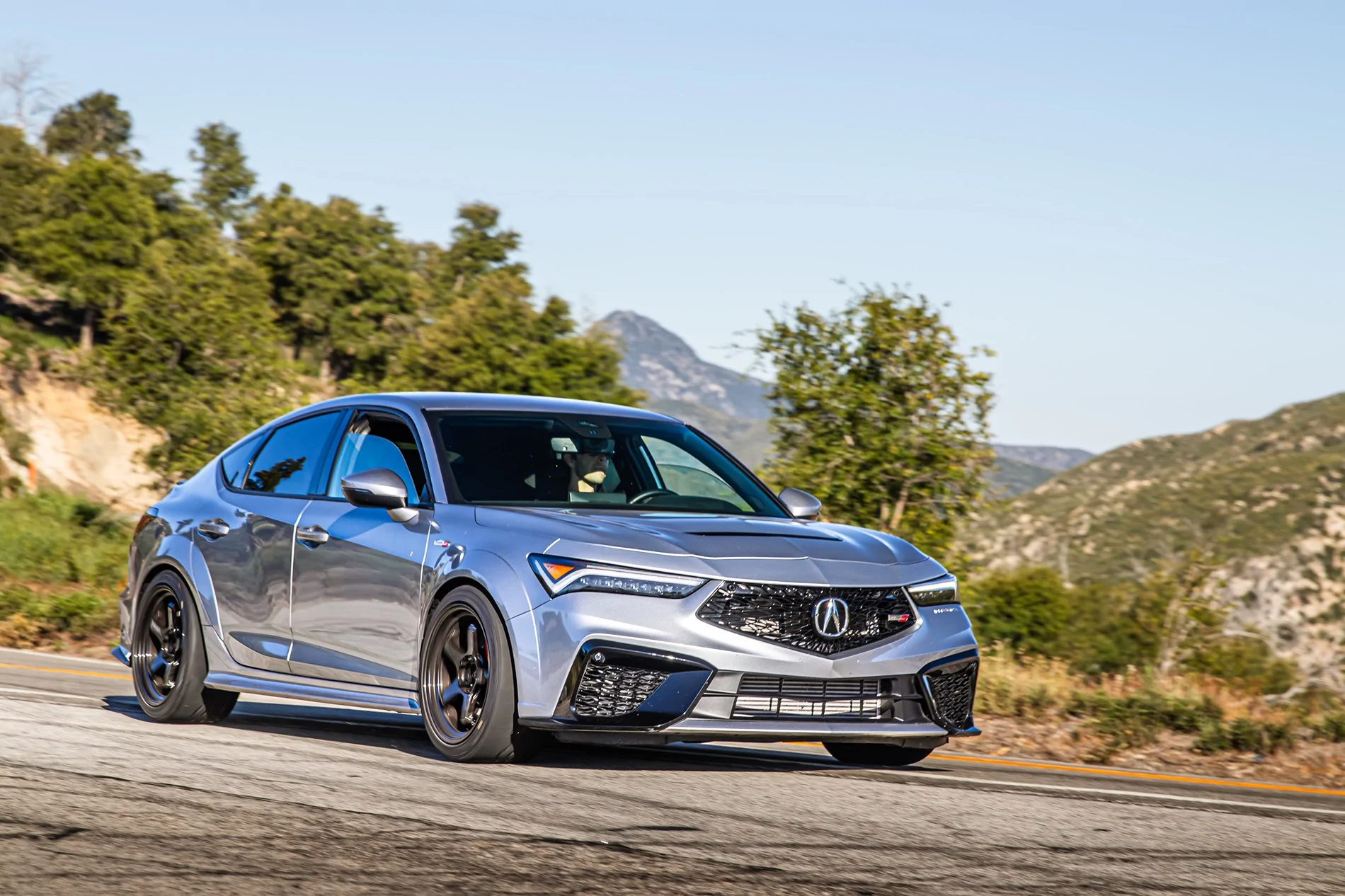

Got my Eibach Pro-kit springs installed. I went with Whiteline camber ball-joints up front and SPC arms in the rear. -2.5* front, -2* rear camber. The ride quality is great. Equal to stock if not a touch better matched for the OEM damper settings. Definitely not too stiff. The added negative camber up front made a huge difference in the canyons. It really feels like the OEM+, dailyable set up that I was shooting for.
