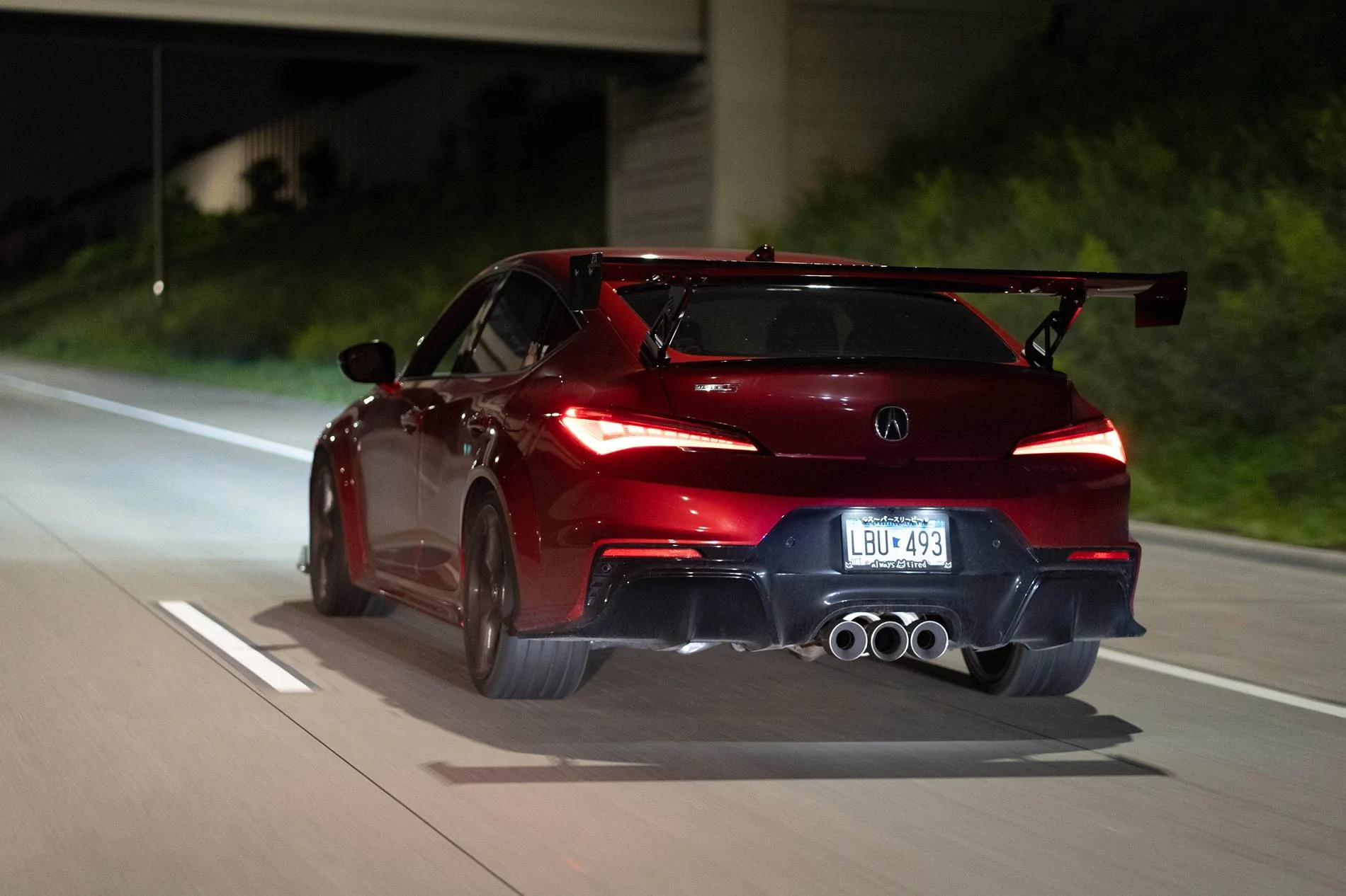

I have the APR GT250 wing, I can't say enough good stuff about them. (other than the wing install manual is a bit goofy)
Do be warned tho. They are functional wings, so you do want a bit more front down force to balance things out. Or you will feel the down force in the rear.

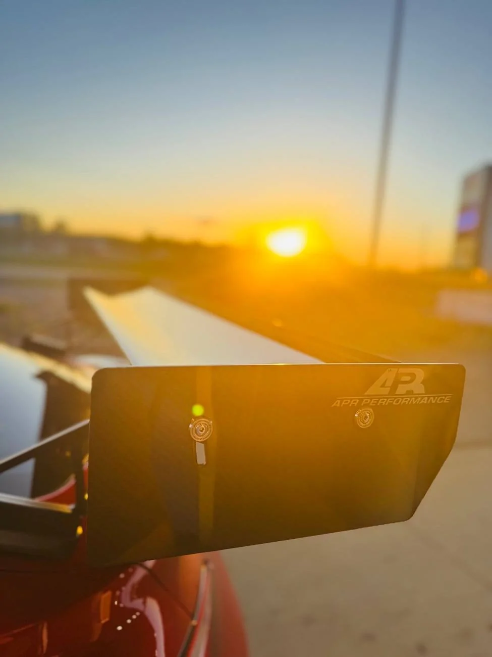

The gt250 wing is VERY efficient. It generates over 150lbs at 80mph and over 350lbs at 120 mph. It respectively generates 30 and 65lbs of drag as well. You can add a gurney flap and make it even more efficient with minimal drag addition.

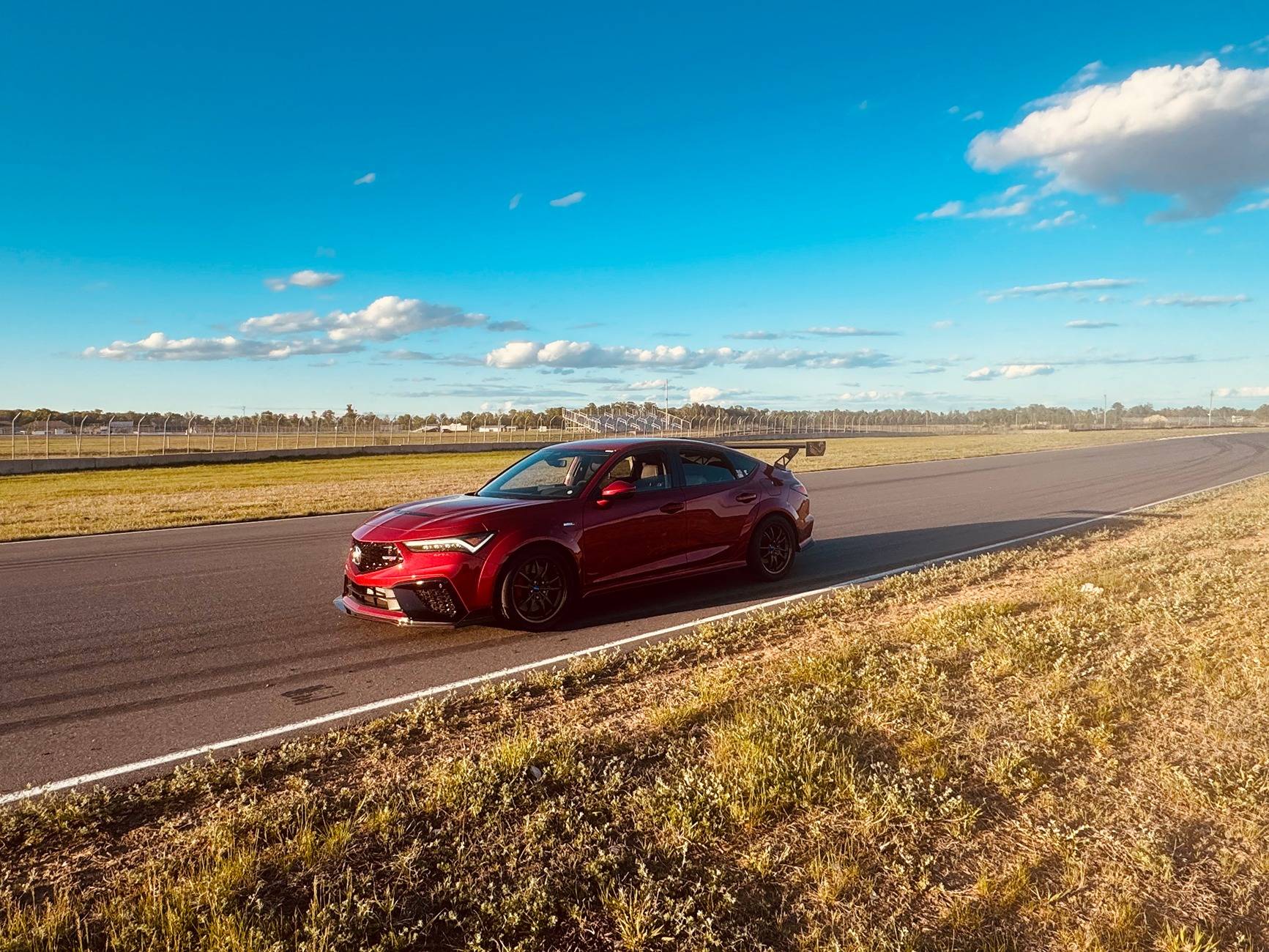

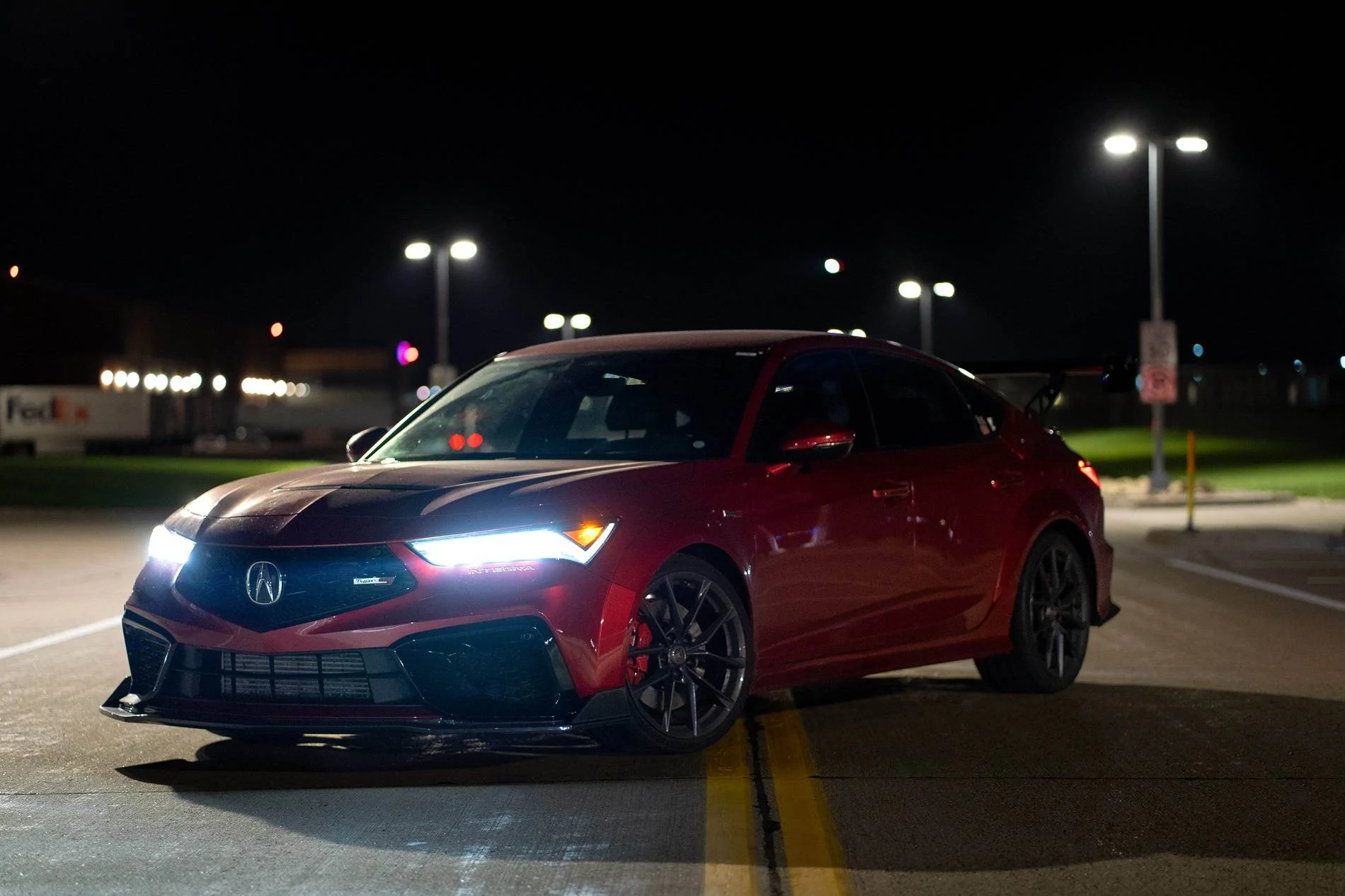

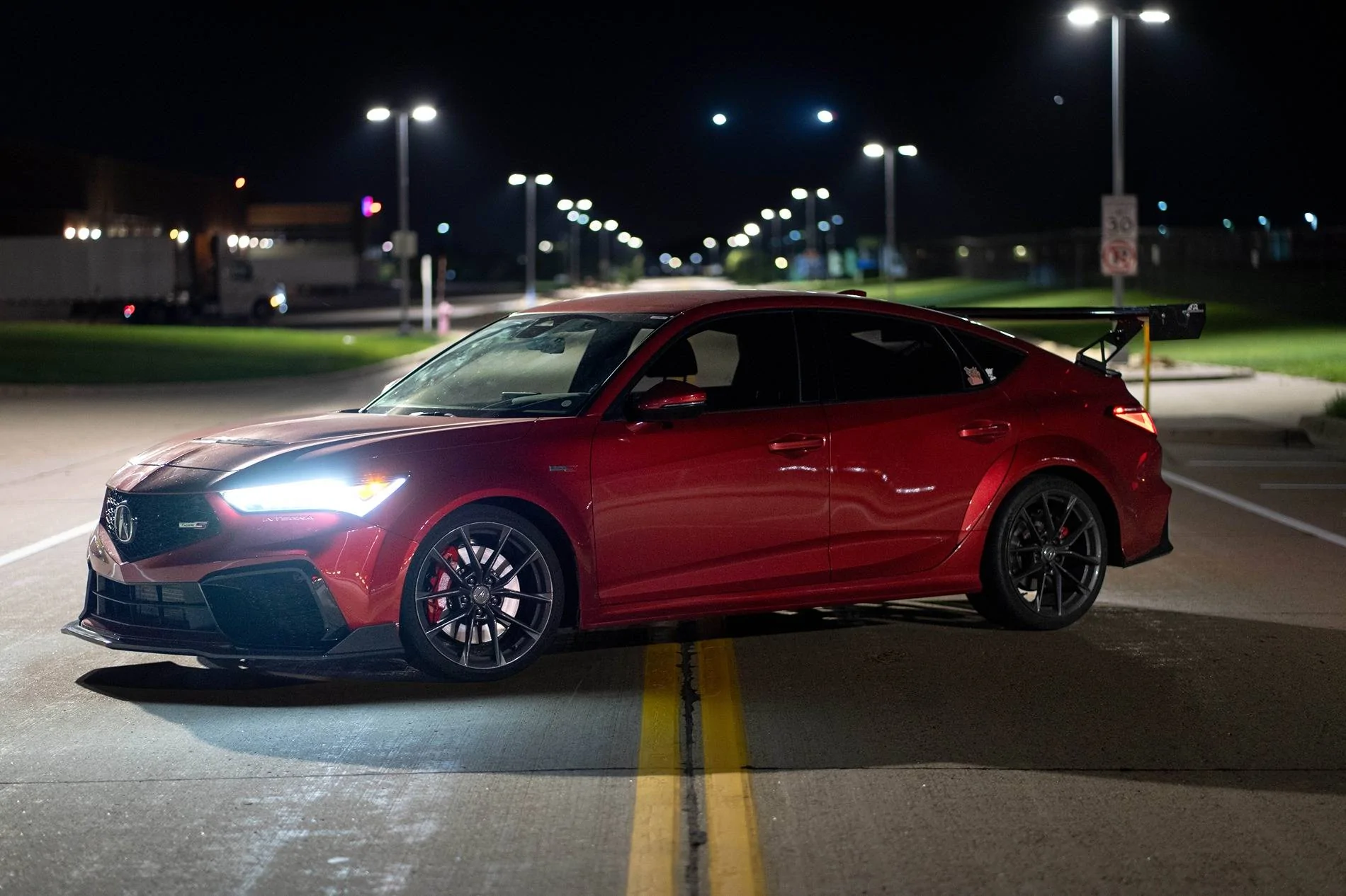

The figure you provided was for 15 degrees of angle of attack. I am using the default setting of 5 degree and the down force is about less than half of what you said. And I still do feel the front end is a lot lighter than I used to when I took the apr front airdam off for autoX. The wing came wiht gurney flaps as you can see in the photos.
And as setup wise, you do not need a lot of down force in the rear for a FWD car. You need a bit of rear end grip mostly for high speed corners stability. And as powerful as TCR cars go, they almost never go over 13 degree of attack angle on the wing. And GTC-250 wing is used in TCX America too. So you really don't need the "reasonable splitter back to the axle, 4" extension, air dam, a fence, and preferably diffusers that dump into the wheel wells at about 8" wide.". Unless you are pushing for some unholy amount of horsepower.
And to my knowledge. After doing a track day with this setup and some trackcross events. I feel the car is pretty balanced. The only reason I brought up the front end aero is to note OP if they do go this route they would want some balance.
