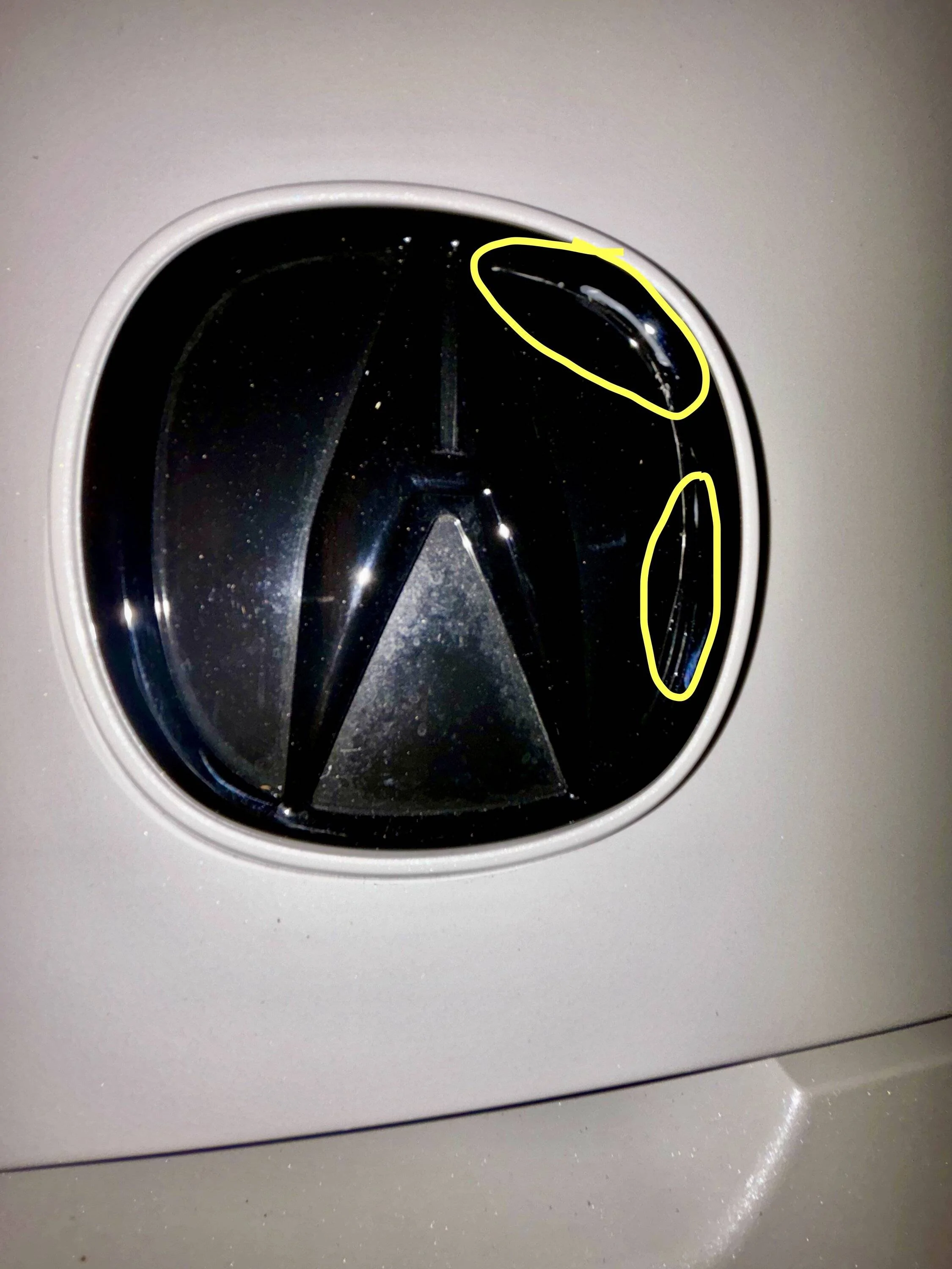

It's strictly adhesive--use some nylon fishing line on a nice warm day and it'll come right off.might be a stupid question, but how does the base part of the emblem come off? Do you need to remove trunk panels or something to access clips or is it just secured with adhesive?
Be ready for it to 'pop' off when you get the last of the adhesive, or lay a blanket down so you don't knick it on the driveway/garage floor.
