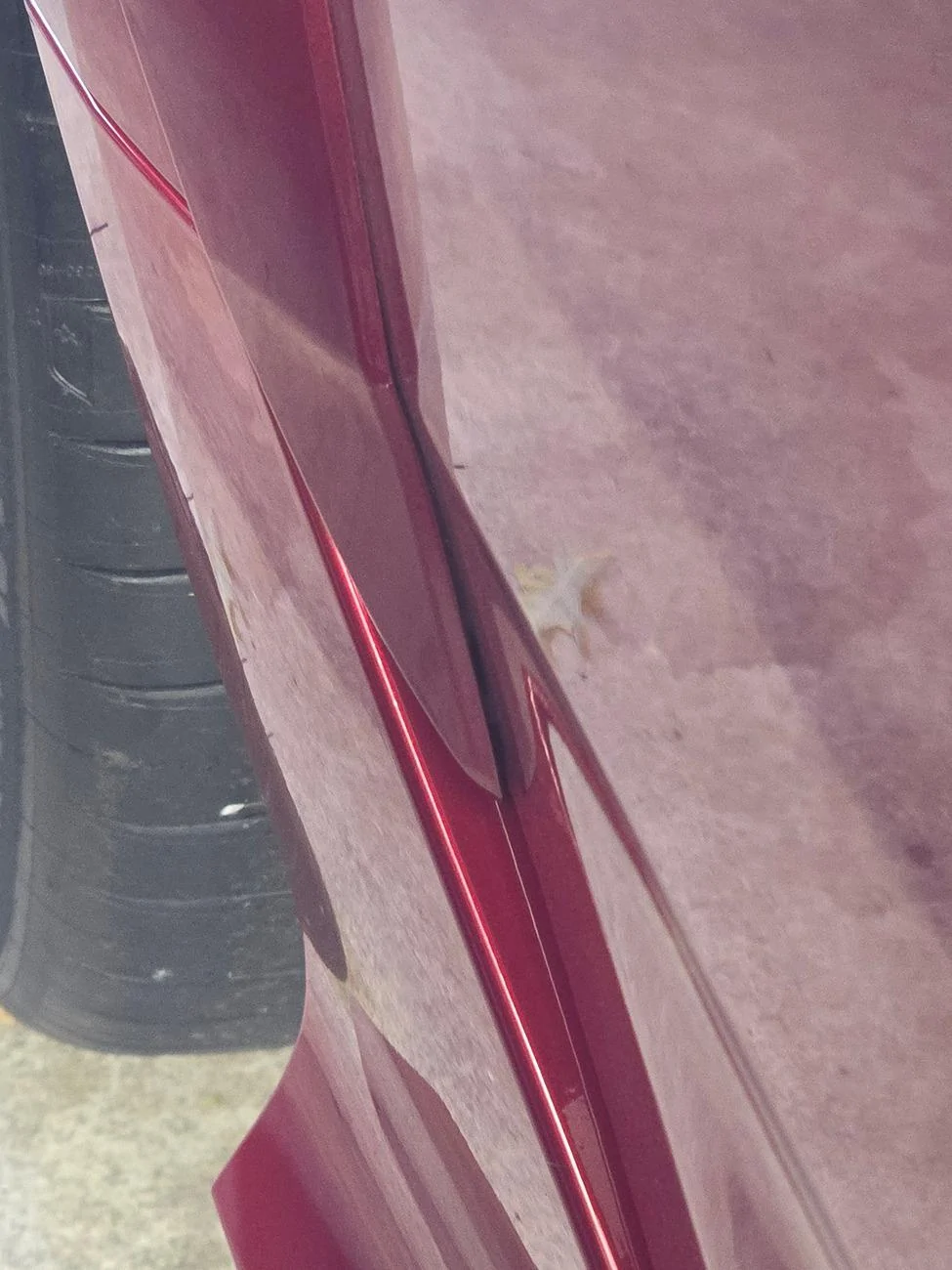

I took my car in today for a rattle under the infotainment screen and I gave them the civic tsb. They argued that tsb existed before the car was made and brushed me off like I was crazy. Well, then they ate it later and had to own up to fixing it under the same response as that tsb, ?.
They also looked at the seat belt rattle and claimed they couldn't replicate it, but took it apart and felt taped every area they could. It's noticeably snugger and doesn't make me want to punch the thing while driving over chip sealed roads now. Still rattles, but now it's the actual mounting loop where it's a design problem and will always rattle there, no matter what.
And for my fender that's peeling away on the passenger rear door, they ordered a new fender piece and will be replacing it in a week or so.

624
466
I didn't, but I took one for you. It's worse in person than it seems in photos.
Gotcha. I have some issues with paint flaking off on mine. I was looking online for the fender piece as I was almost tempted to get it on my own and have my PPF guy fix it at the time.
1,425
963
Yeah when I was detailing the car initially I found MANY areas of poor paint application. Some areas are a solid mil thinner than others on the same panel, some have paint defects under the clear coat, dust under the paint and/or clear, and even areas where the paint under the clear gassed out so there's a pinhole.
I would not be surprised at all in a few years to see paint flaking off or UV degradation.
I'd say call the dealer and make them fix it. If it's flaking, they owe you a whole new trim piece, not a repaint.
