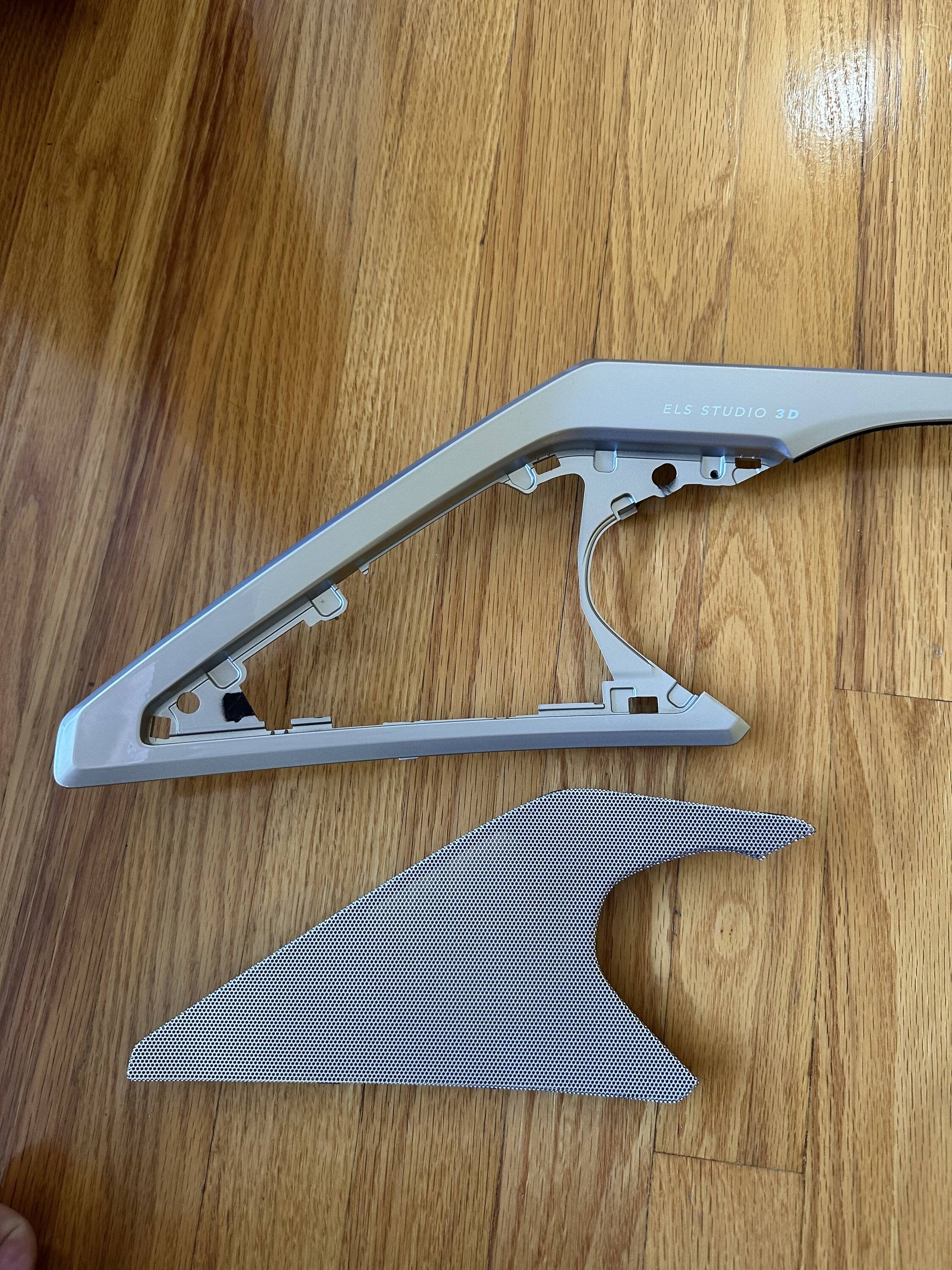

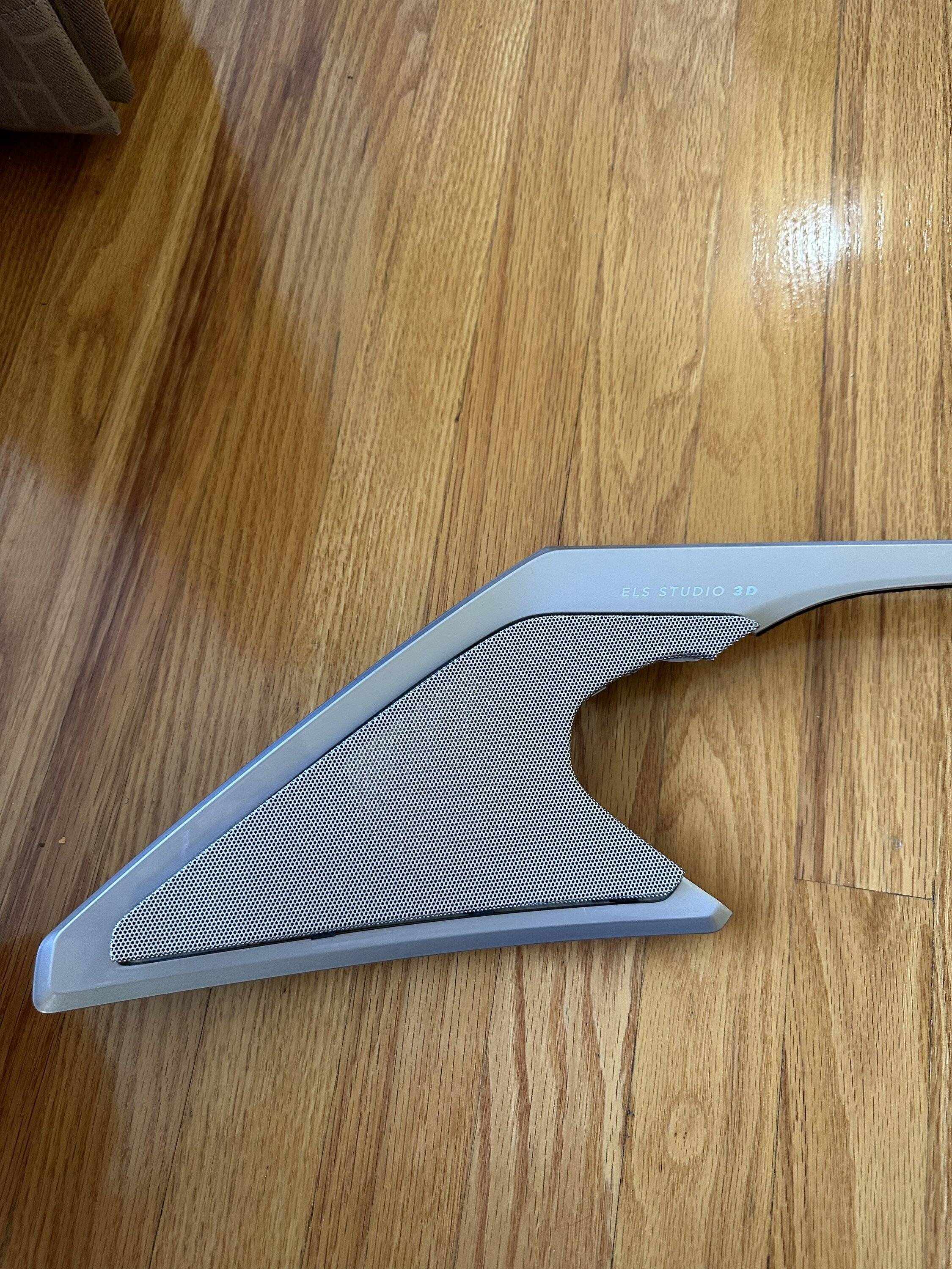

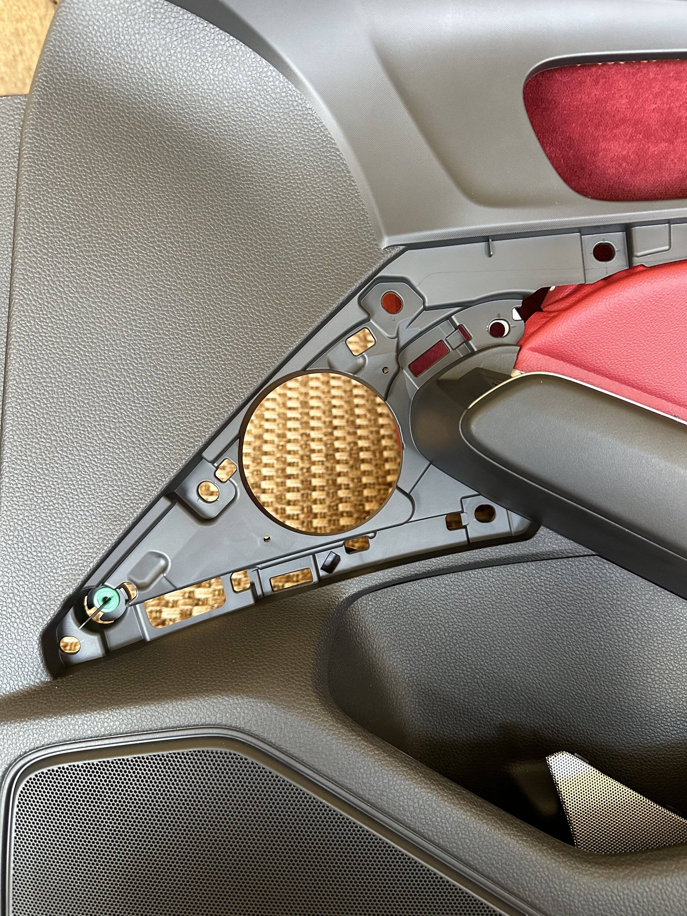

I think this may be the culprit…
The silver mesh cover is a separate piece from the rest of the silver trim and I think their normal clip style connections cause vibration. I took mine apart and put some double sides tape in locations that looked like it would tighten up the tension between the two pieces. Too soon to tell if its stopped the rattle.
Need more driving, especially in colder weather.
I just figured out this is probably the source of my passenger side rattle, and I saw you posted the door panel removal video, but can't I just pop/pry off the silver trim piece and mesh cover without taking the rest of the door panel apart? Or will I end up breaking something?
There is no way to release the clips from the front side of the part. So you will have to take the door panel off.
Bummer! I figured that might be the case but wanted to make sure. Thanks for the info.

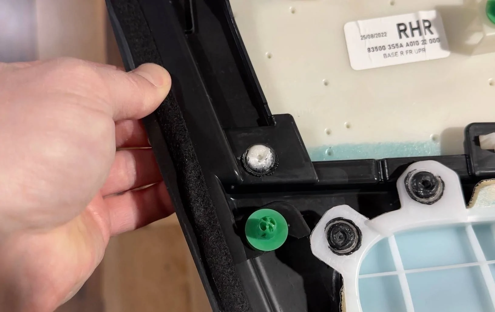

Last weekend I took the passenger door panel off looking for a rattle that went away when I pushed to the rear of the door handle area. I mostly noticed it on warm days while taking right-hand sweeping corners. I discovered that a "plastic weld" (white nub in the middle of the photo, above the green trim clip) that holds the upper trim piece to the panel had cracked, allowing the panel to flop around. I epoxied it back together and I haven't yet heard the rattle when I would have expected to. Another of MANY annoying rattles that I've been trying to get rid of.
Good find!
