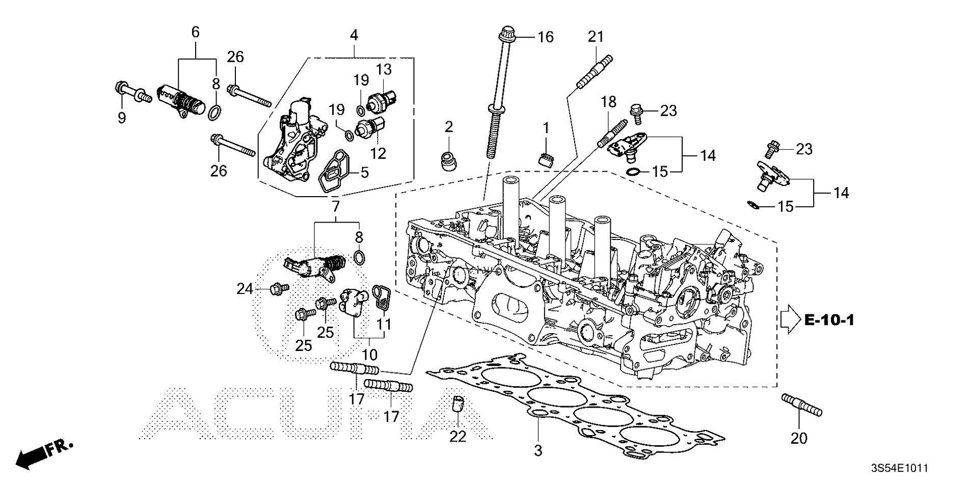

Acura Integra P0013 code after bolts ons IMG_4173
in the photo it’s #7 and #6. Those are the VVT actuators and that’s what the P0013 is referring to. Don’t remember off the top my head but off the diagram I’d assume #7 is the exhaust one which is what the code is referring to.
When was your last oil change ? As dirty or old oil can sometimes make these solenoids stick and get stuck or clog the screen filters on the solenoid

The exhaust VTC solenoid is located near the left front side (passenger side) of the engine, you would have ran into it (or been able to see the connector for it) when installing the inlet pipe. When installing/removing the vtc exhaust solenoid the inlet pipe has to be removed also. If you can remember disconnecting any connectors
