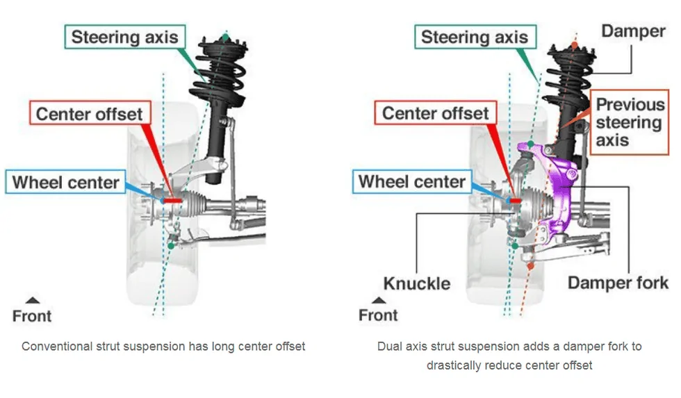

To understand how the Type R mitigates torque steer, you need to understand tire scrub radius and the kingpin (or steering) axis. The kingpin axis on something like the Civic Type R extends from the highest pivot point (the upper balljoint) to the lowest pivot point in the suspension (the lower balljoint). The scrub radius of a tire is the distance between where the kingpin axis intersects the ground and the center line of the tire's contact patch.
In high-torque front-drive cars, the goal is to get these two points very close to each other, without overlapping—a car with zero scrub radius can have a lot of tire squirm and handle strangely. Many modern cars, especially those that are front-wheel-drive, actually have negative scrub. This type of setup usually requires less steering effort and often helps to counteract torque steer in cars like the Civic Type R.
Acura Integra Old R&T article about Type R front suspension set up and effects of aftermarket wheel and tires civicvsctr-png-1545854072
Compared to the standard Civic, Honda was able to bring the steering axis closer to the wheel center line in order to minimize the tire scrub radius in the Type R. That angle is narrower because the kingpin axis is much closer to being parallel with the tire center line.

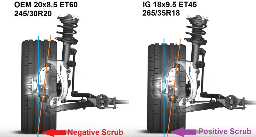

Using the excellent suspension calculator at Racing Aspirations gives us a rough estimate of what the stock setup on the Type R looks like compared to the 18-inch setup shown above, as well as another popular wheel and tire combination for the Type R: the 19-inch front wheels and tires from the Acura NSX.
We know some measurements for the Type R's factory wheel and tire, along with track width and factory camber settings, and we'll estimate the other measurements to get a general idea of how each wheel and tire combination works. We will start with -2 mm of scrub radius for the factory setup, a 20x8.5 wheel with an ET60 offset and a 245/30R20 tire.
Acura Integra Old R&T article about Type R front suspension set up and effects of aftermarket wheel and tires scrub-comparison-1545928175
If we enter the details for the Desmond wheel and Advan tire shown in this Instagram post, we see that the 18x9.5 ET45 wheel and 265/35R18 tire combination alters a lot of measurements. The ride height goes down by 7 mm and the track width increases by 30 mm. Our scrub radius goes from -2 mm to +11 mm, a pretty significant change that's highly likely to induce extra steering effort along with more torque steer.
Going to the option of the 19x8.5 ET55 Acura NSX wheel with its stock 245/35R19 tire seems to be a better option, though it's not optimal either. Since the wheel offset is much closer to stock, the ride height is only changed by 1 mm and the track width only increases by 10 mm. Our scrub radius is again positive, but this time it only goes up to +4mm.
