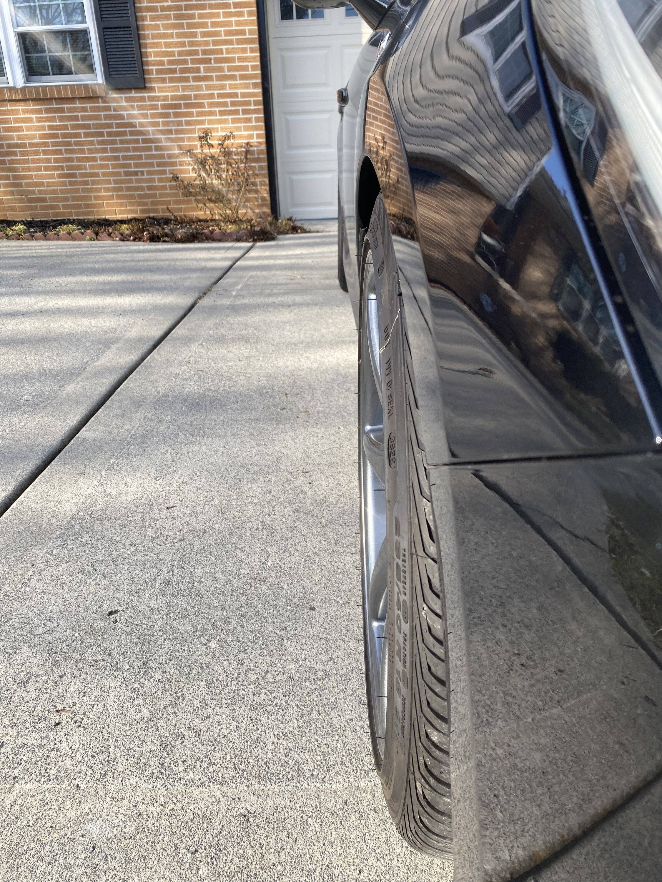

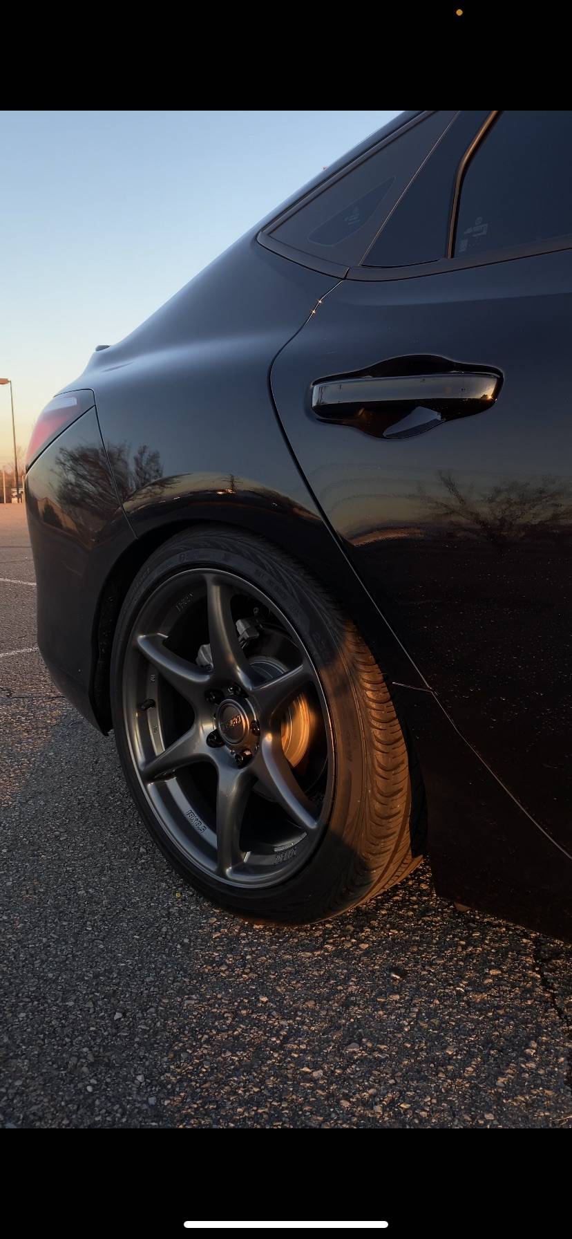

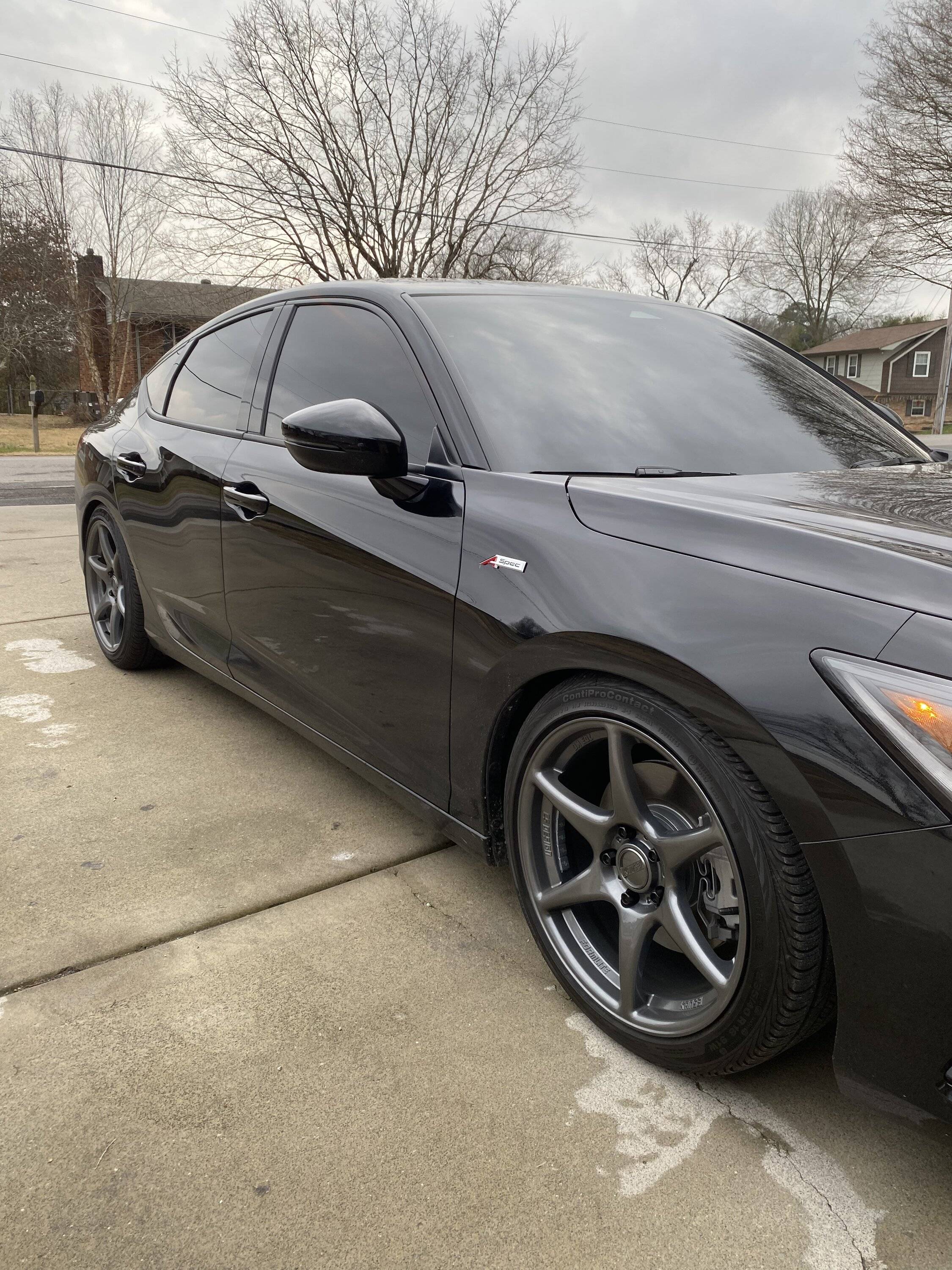

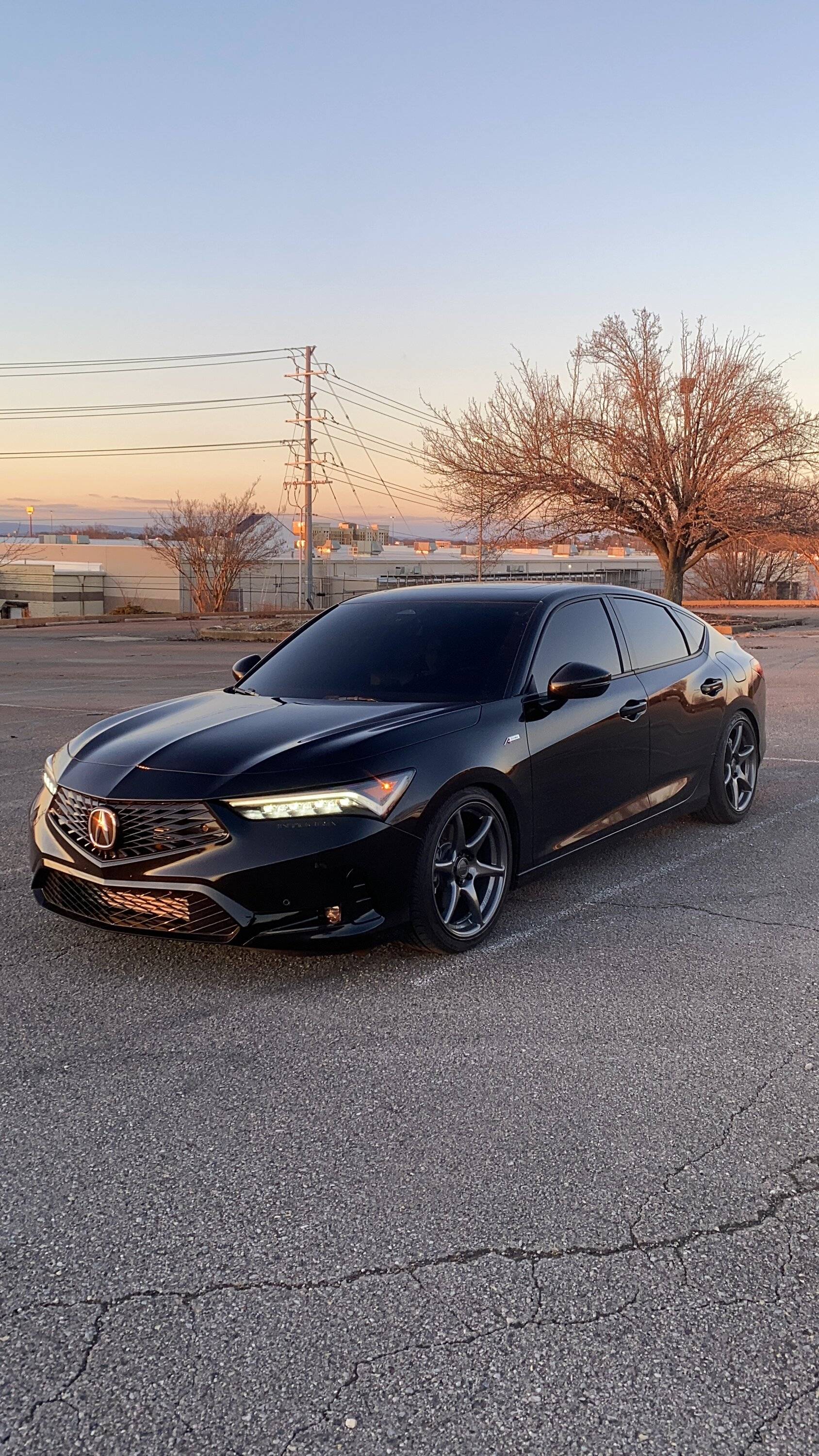

Sitting on Eibach lowering springs, about a 2 inch drop.
Kansei Tandem Wheels 18x8.5 +35
On the stock 235/40/18 tires
Fitment is nearly flush and gives a good stance. You can go for a slightly wider wheel if you want it to be extremely flush , but otherwise these specs are good if you don’t like poke

Looking good man, indeed 8.5 +35 is a good fitment for these cars. Not too aggressive but fills the fenders nicely

Niiiiice. Looks great!
The safe part of my brain wants to just stick with the tried and true 8.5 +35, buuuuut JDM wheels start getting deeper "faces" once you get into the 9 - 9.5" widths and that's also very tempting.

Loving the look! Are you on sportline springs? Also, are tires clearing the fender? Im looking to for for a 18x9.5 35 offset, but not sure about fender clearance. Thanks for you help.

Yea I’m on the sportline springs from 10th gen civic si. the tires clear, no rubbing or anything even on bumps. You’ll probably clear with those specs you are going for, just don’t go with a fat tire and you’ll just have some wheel poke

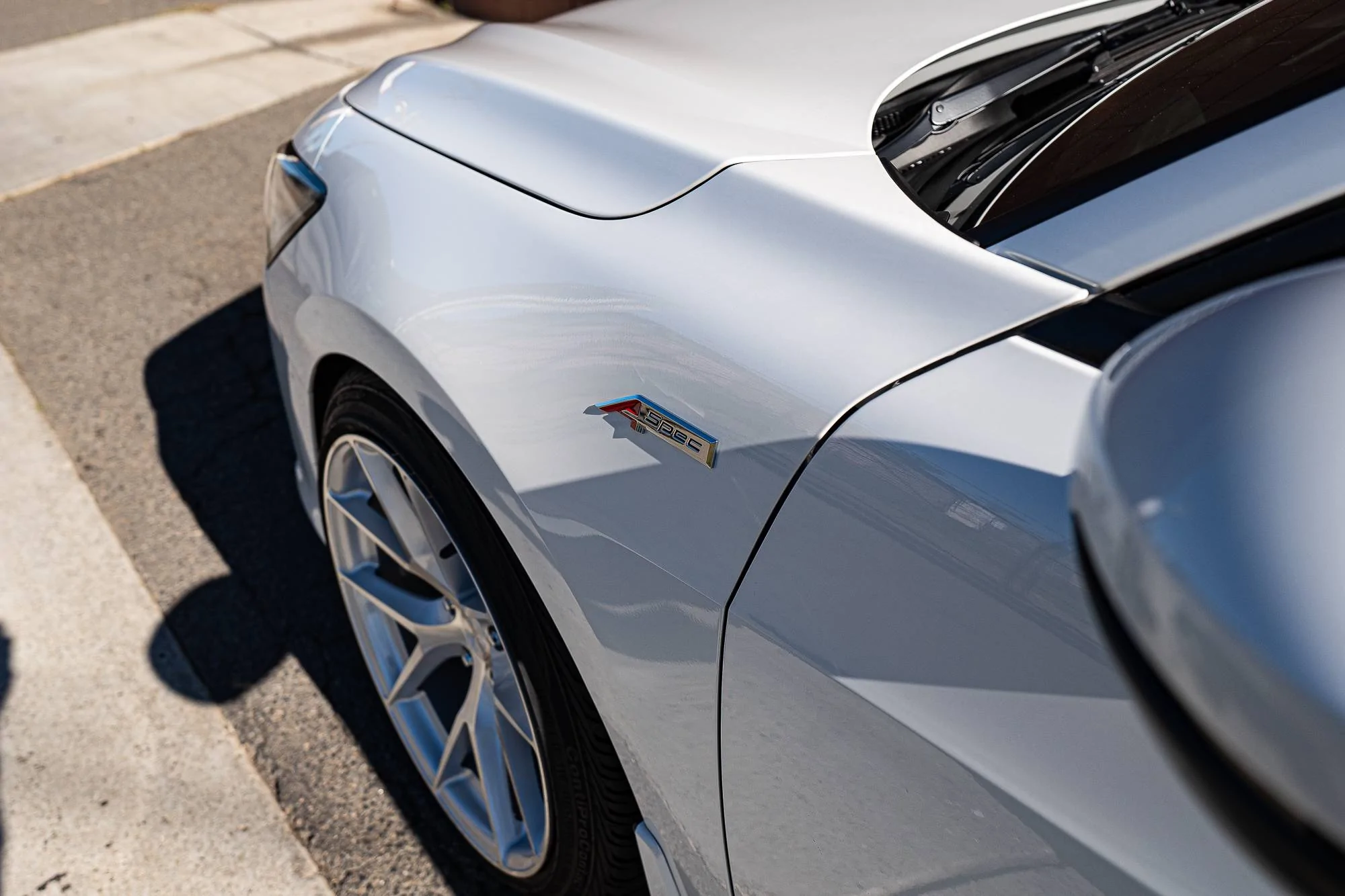

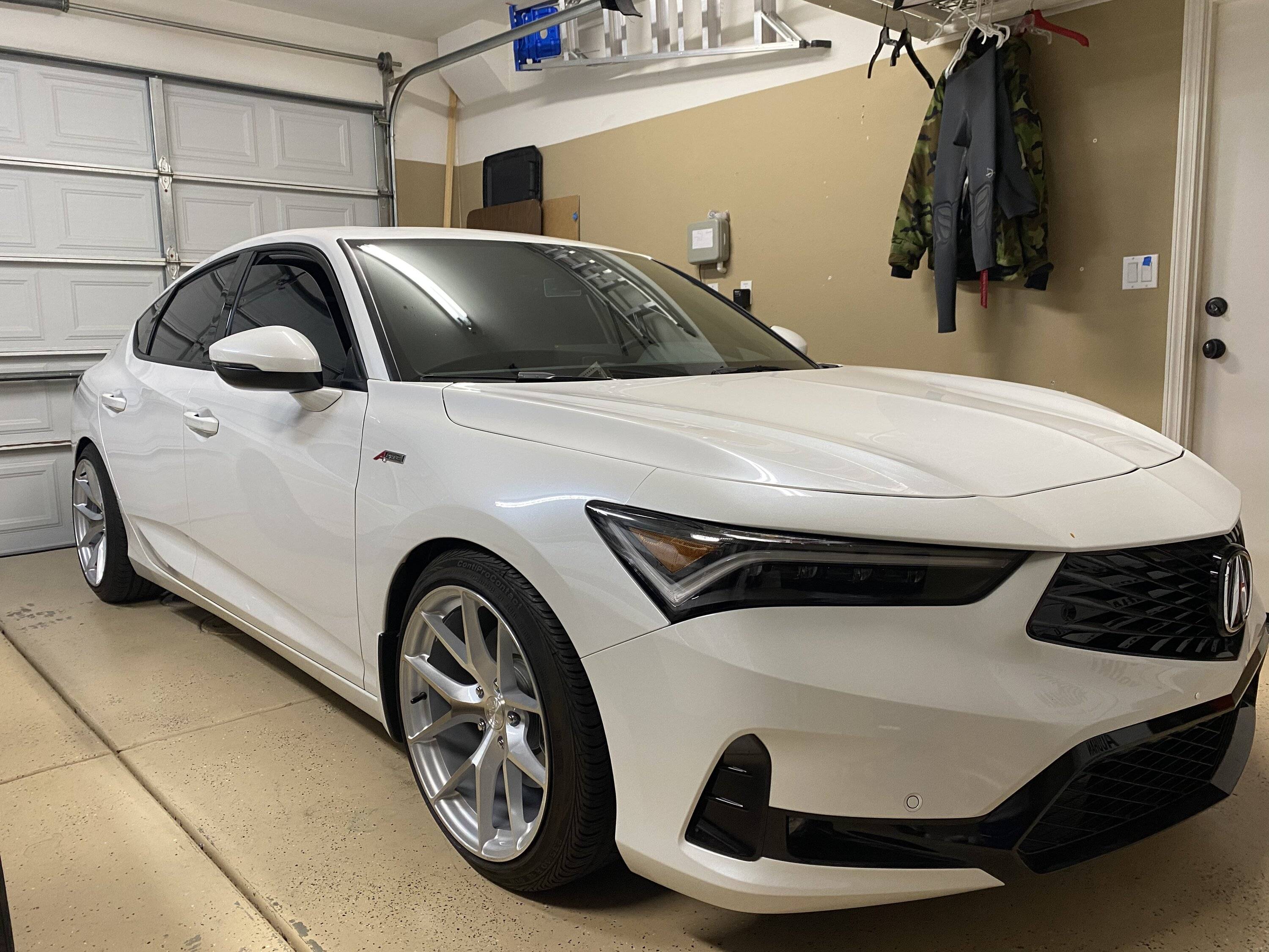

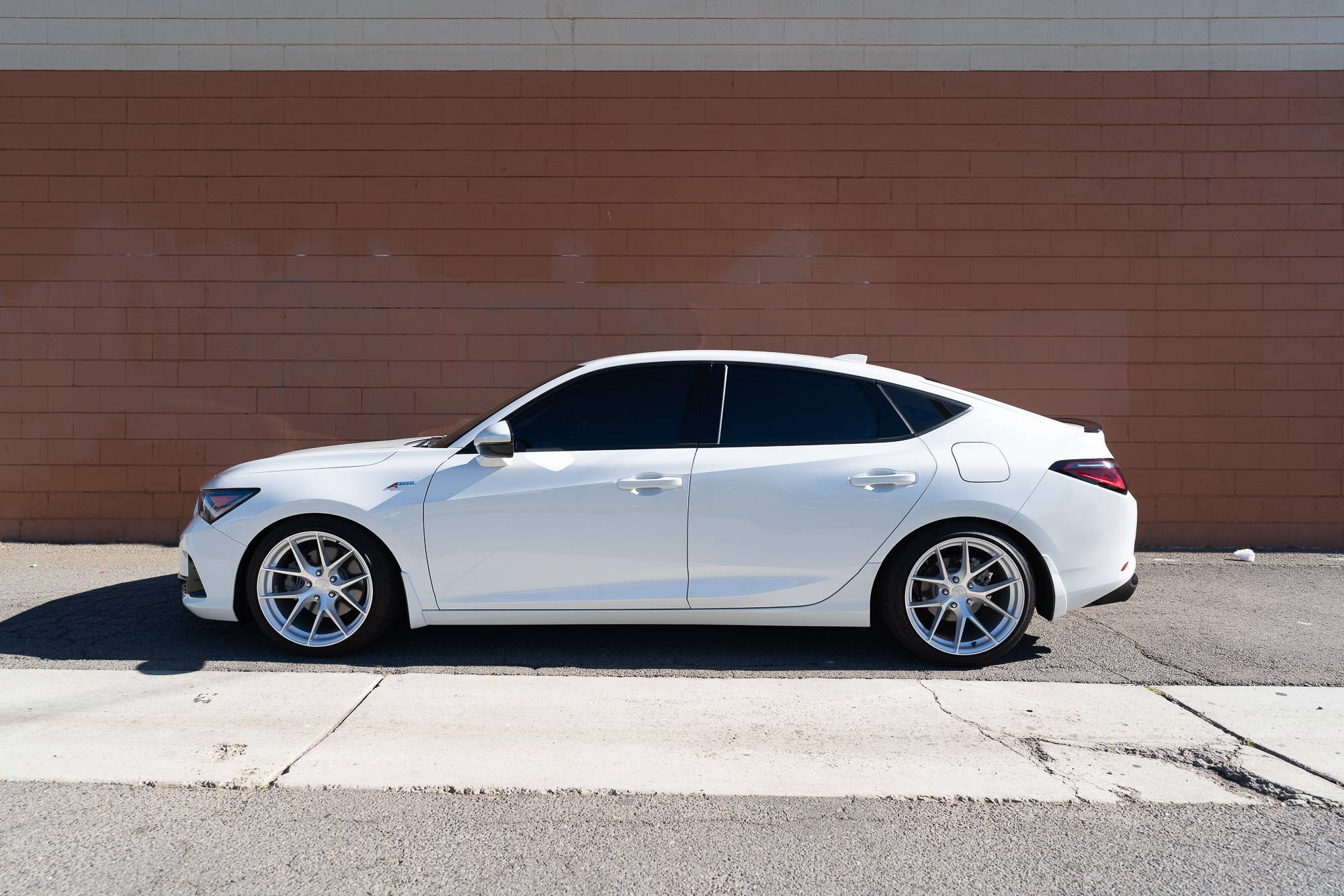

Confirm fitment…just got my wheels. 18x9.5. Sticks out about 1/4-1/2”…..depend on how you look at it. Otherwise, fits. Suspension: Eibach ProKit.

Throw a few degrees of camber at it and the poke is cured!

Offset?
