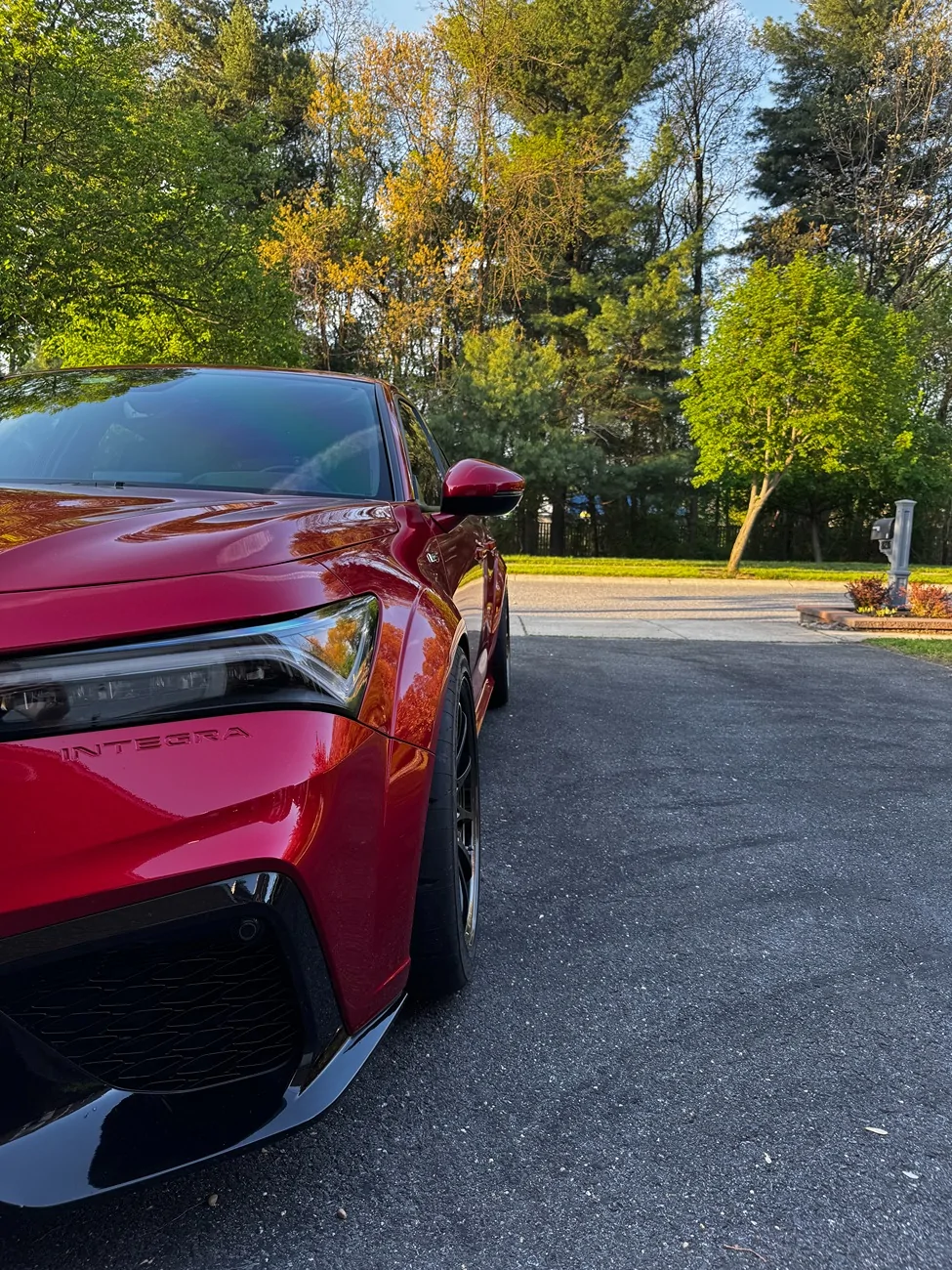

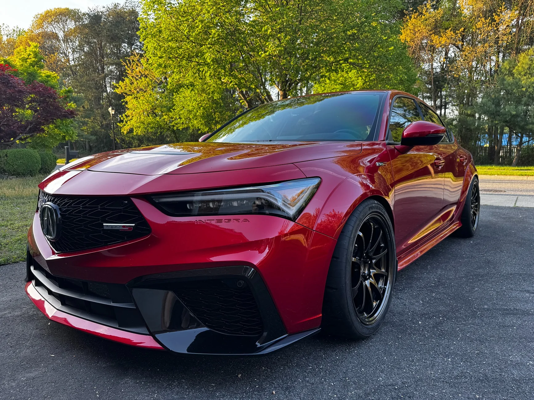

Case in point, I have 18x10 +40 on 275/35-18 Bridgestone RE-71RZ and it just barely rubs. Not a mm to spare, but the RZ are still new and pretty much everyone is reporting they are wider than the RS model they replaced. WAAAY wider than an equivalent summer tire like a PS4S. I also have aggressive front camber at -3.5 degrees. It rubs more in the rear where the camber is still there but not as aggressive at -2.5. I don't think I could get any more aggressive than this setup.
