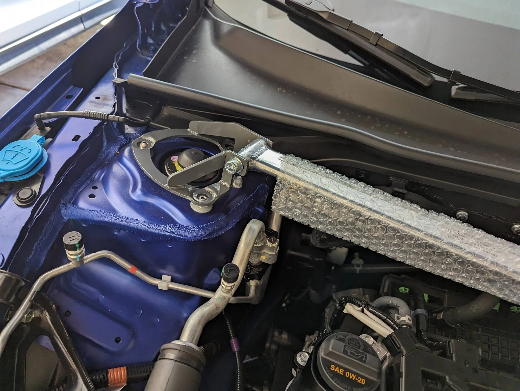

Hey all, New to the group. I was wondering if anyone knows if the 2022 Civic and 2024 Integra have the same measurement distance from strut tower to strut tower. I ordered a Megan Racing Strut Tower Brace and the place I got it from says it's a fit for the 2023 and 2024 Integra but I don't want to unwrap it if it's not going to fit right. The description doesn't say Integra on it. I actually called Megan racing and they said they don't make one for the Integra but that the company could have done their own measurements...

I was going to get the DC sports strut brace direct and I reached out beforehand and they advised me the 10th gen civic braces wouldn’t fit, however, the 11th gen’s would. Our engine bay and engine itself are essentially an Si’s setup

Bolt pattern didn't line up. I'm sending it back. I had a suspicion that this one was for the 10th gen. Oh well...
Damn :/ I’ve heard good things about 27Won’s brace. You can also upgrade it to include a brake brace as well.

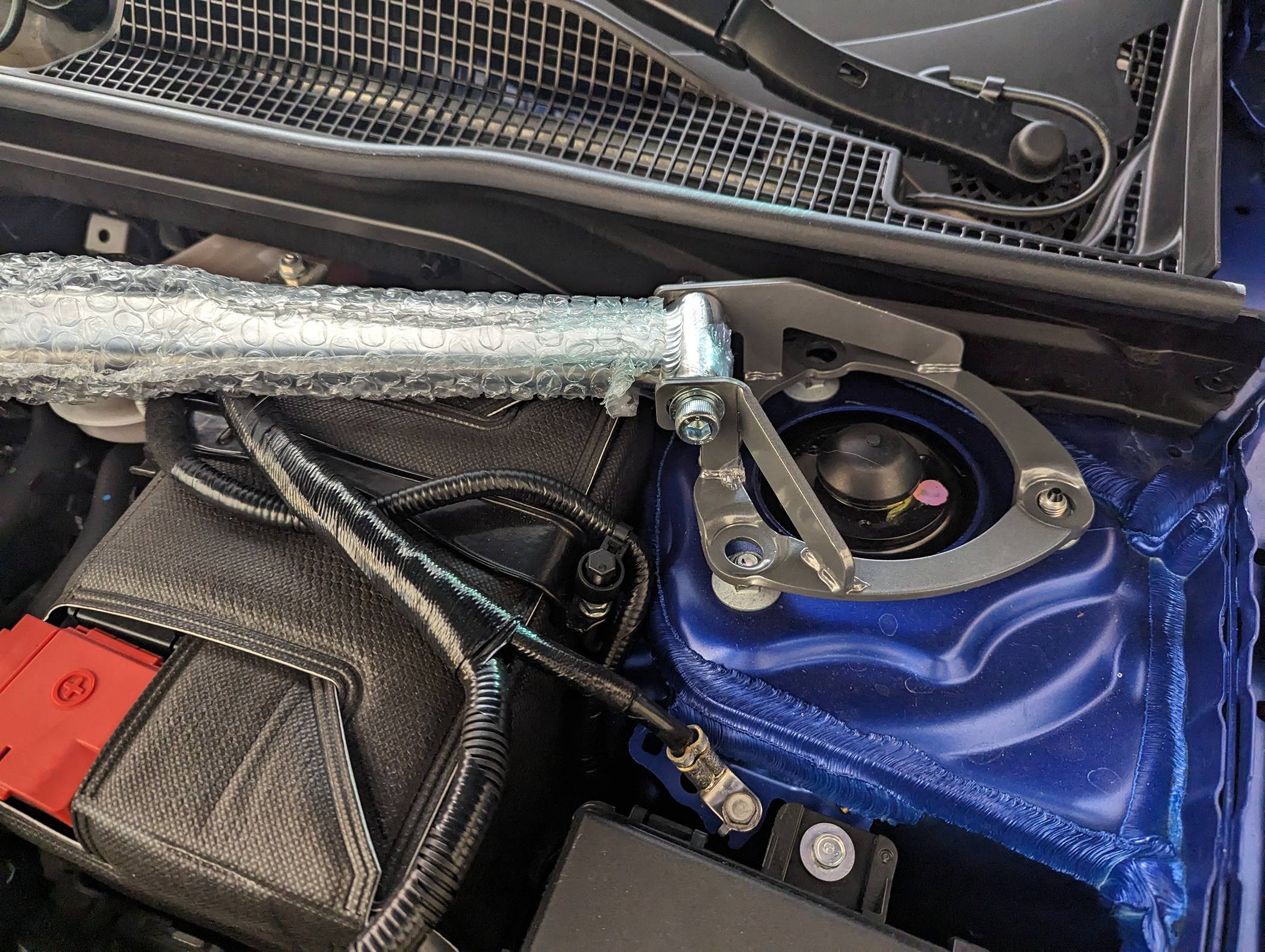

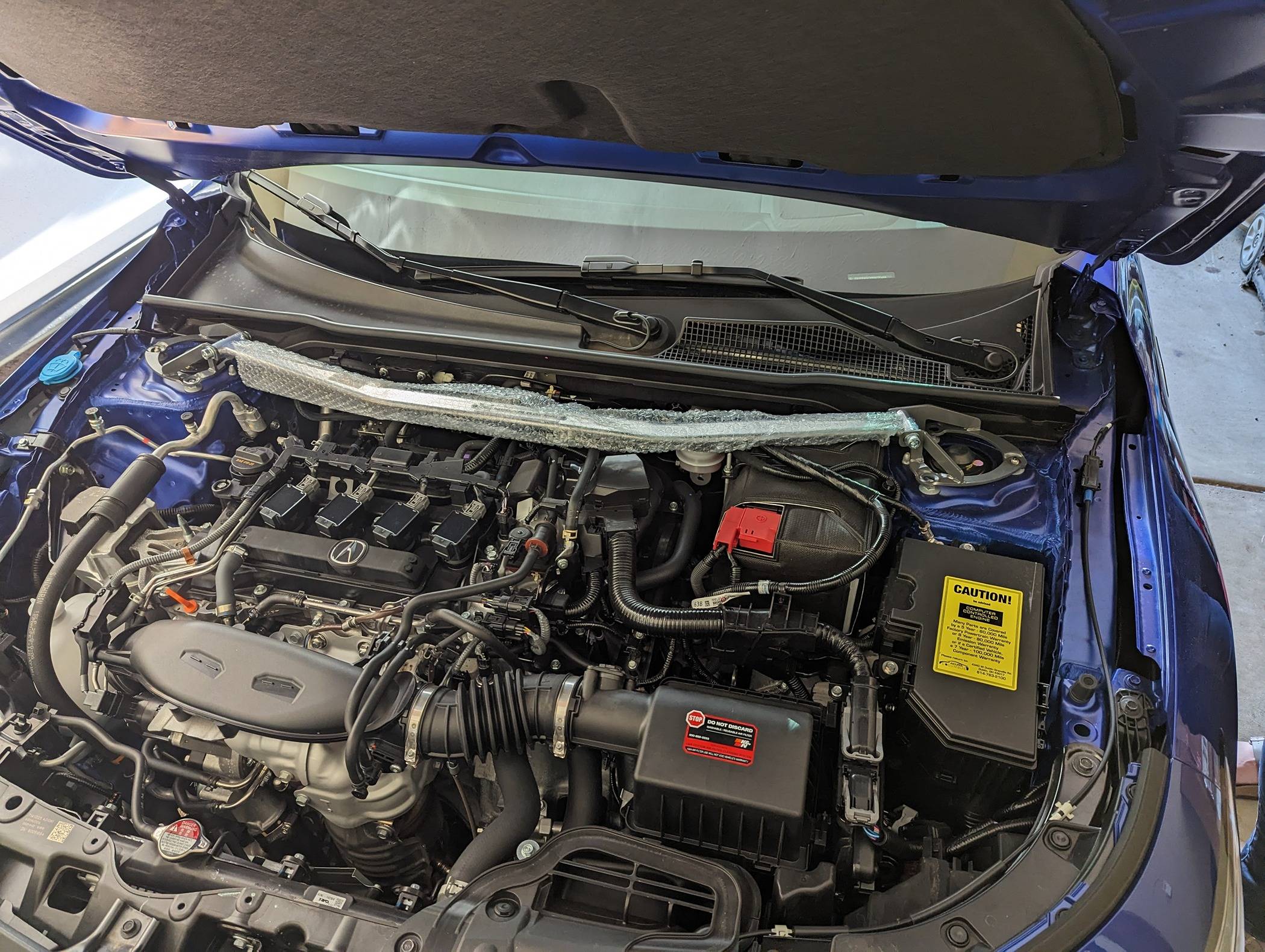

Well....I was wrong. They had the brackets installed backwards. Now I just need to figure out how to clear the battery cables. Does anyone else see any other clearance issues besides the battery cables?

What is up with that giant caution sticker? Is it supposed to scare you away from working on your own car? I get that dealers are desperate but that's just silly.
For the 27won strut tower bar (also meant for the 11th gen civic) to fit, you have to fold down the battery blanket top flaps to get enough clearance.
You can see it in the first picture here: https://www.civicxi.com/forum/threa...ster-cylinder-brace-for-the-fl5-type-r.51450/
