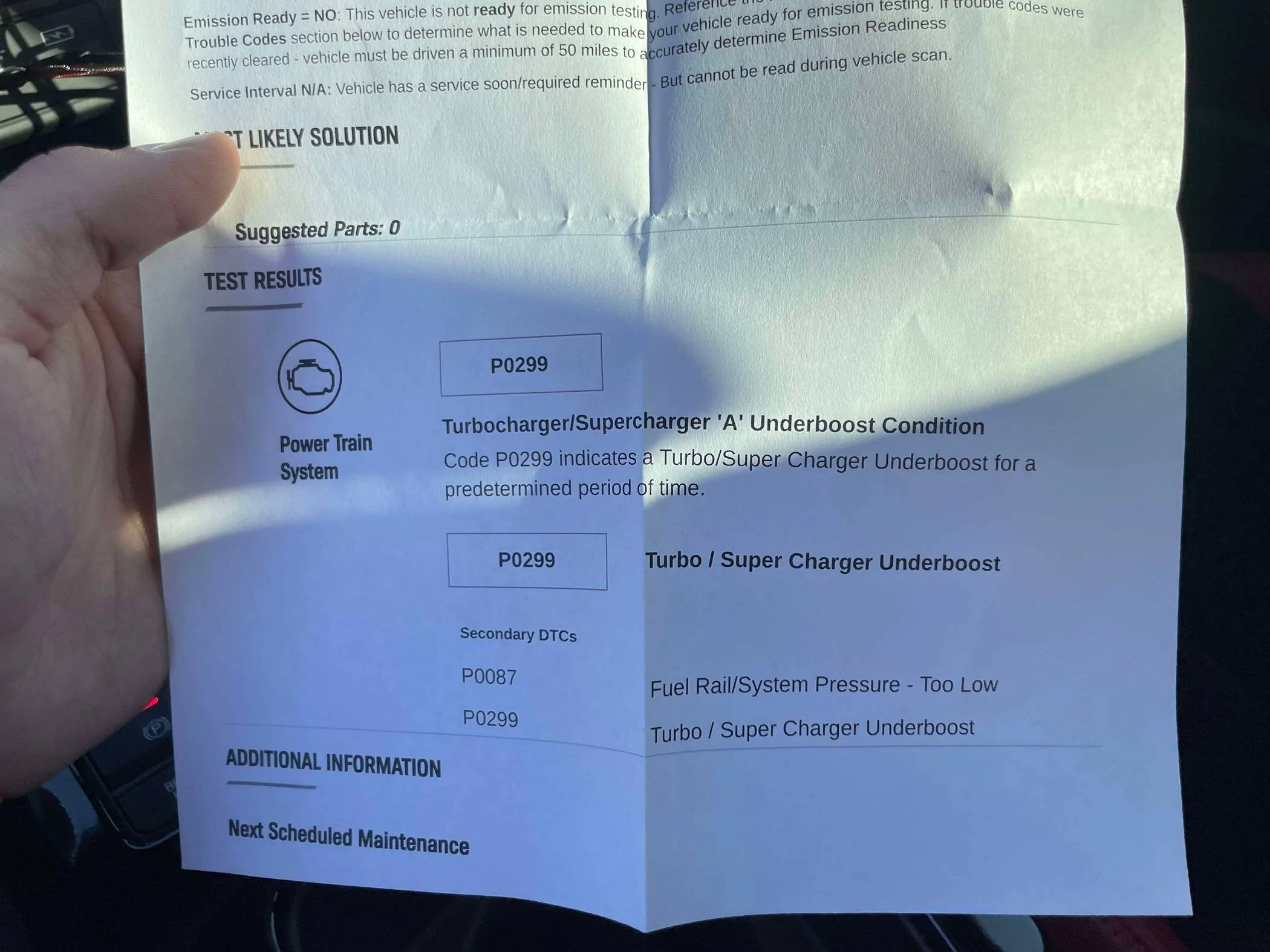

30 minutes into the 40 minute "happy hour" session at the end of the day (previous sessions had been 20min each), I was cresting the hill at the end of the Carousel and felt the power stutter. My first thought was traction control (which I'd fully disabled), but then the dashboard lit up with failure lights and I nearly forgot to brake into the hairpin as I tried to understand what was going on. I couldn't accelerate out of the hairpin - the car seemed to be limited to 10mph or so (I never looked at the actual speed), and I limped back to the pits.
I was at 5 bars of engine heat, and it was the hottest part of the day, and I'd run longer than in any previous session, so I first suspected limp mode being triggered by excessive temperature (oil or otherwise). Once I drove around the pits a bit and power cycled the car, limp mode went away but the check engine light remained, along with a message about a fuel system issue and a rev match issue. Shortly thereafter, my fuel indicator went from two bars to one bar - I hadn't realized I was at such low fuel until I got into limp mode, because I'd filled up less than 70 miles prior.
I'd stupidly left my OBD scanner at home so I went to an AutoZone to clear the codes and to see this:
Acura Integra Limp mode ends my first track day ever errors
I did some hard accelerations after clearing the codes and the light hasn't returned - so I suspect the turbo underboost was secondary to the fuel pressure fault, i.e. I had a brief moment of fuel starvation due to the G-forces of the track and it triggered both of these codes.
Some chance remains that I blew a leak in the turbo/exhaust system but I suspect the G-induced fuel starvation was the real culprit. I'm back at the track tomorrow, and we'll see if the issue recurs!

Yeah... you go through fuel VERY FAST when you're pinned at WOT for 20+ minutes at a time.
And fuel starvation is a thing in these cars. The hardcore FL5 guys fuel up between every session. For a 30-40 minute session I wouldn't even attempt it without at least 3/4 tank...
Pay attention to see if you still get the "pops and bangs" from the exhaust in sport+ mode. Many have reported that goes away after getting these codes or similar. As far as I know it requires a trip to the dealer to completely clear it up; there may be a software update that provides a more permanent fix but someone else who's gone through it will have to chime in. @ender_ong went through it a good time ago, I think @StingertimeNC has too but can't remember for certain...
Also, getting the coolant temp past the 4 bar mark seems to only happen on the track on very hot days- but so far no one has reported an actual overheating situation, which gives me hope. I actually don't think the FL5 overheats either, as I think every occasion where this has happened to folks has been attributed to an aftermarket bar and plate intercooler blocking airflow to the radiator.

Yes, I had the Low fuel rail pressure thingy last time at the track. Reset the code myself and nothing since. I'm chalking it up to fuel starvation for just a split second. Maybe got some air in the line or something and that threw the car into limp mode. What I didn't realize at the time, is that the car won't rev past 3k rpm's, but if you keep shifting into higher gears you can go faster. I think I was in third gear and limped in at about 35-40 mph. Had I just shifted to fourth, then 5th I could have gotten in much faster.
I filled up between most sessions but once I still had 3/4 of a tank at least and I think that's when it happened. I would fill up after every 30 minute session just to be safe.

Almost certain fuel starvation. Ideally, try to keep your tank above half all the time on track if at all possible. If that’s refueling every session or two, just do it.

Hi all, sorry for not updating sooner.
The code reset held - no new codes, and I kept my car topped up between sessions the next day. I set an even faster lap, so I have no fear that the fuel starvation caused any lasting damage.

Final note on the fuel - it seems like the gauge is pretty inaccurate on the track. I was shocked at how much fuel I was adding between sessions, well over half a tank when the gauge was showing over 3/4 full.
