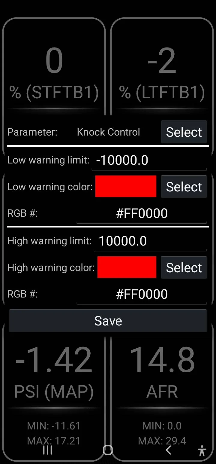

@RB2490 since your set up is like mine, 1.2v with the tunerview app. How can I see the k.con values in the app. None of the screen layouts have it.
So open ktuner and click layout you would like to use.
Acura Integra Ktuner for 2023 Integra is live! Screenshot_20220823-142413_TunerVi
Then on one of the parameters click and hold the screen until you see this menu
Acura Integra Ktuner for 2023 Integra is live! Screenshot_20220823-142435_TunerVi
Then where it says parameter hit the select option and then choose which parameter you would like to monitor

Ok. I’ve done that but didn’t noticed the parameter at the top ?‍♂

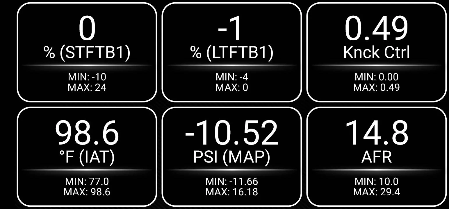

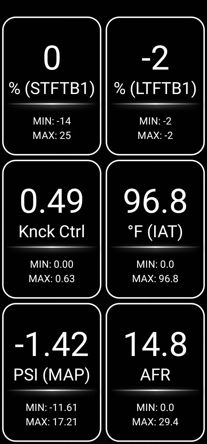

Does fuel quality affect fuel stft and ltft. And when I mean fuel quality I don't mean 91 vs 93 I mean gas station vs gas station. I'm only asking because during pulls using Valero 93 my k.control will go from .49 to .62 in one pull ND come back down after like 5 mins. LT fuel trims were -4. I switched to shell because it was like 60 cents cheaper and now my K.control doesn't move from .49 during 1 or two pulls and the LTFT went to 0. STFT now stays 0 during partial or WOT

Different fuels contain different additives and even different levels of ethanol, so fuel trims may adjust based on those inclusions.
Figured! I guess shell is my new gas station and it's cheaper because my numbers are way better now and knock Control never changed after pulls.
Acura Integra Ktuner for 2023 Integra is live! Screenshot_20220824-062905_TunerVi
I've been stuck at -3 , -4 for the longest. Today after a decent drive I'm at 0, -1 and knock control stayed .49 after 2 pulls
