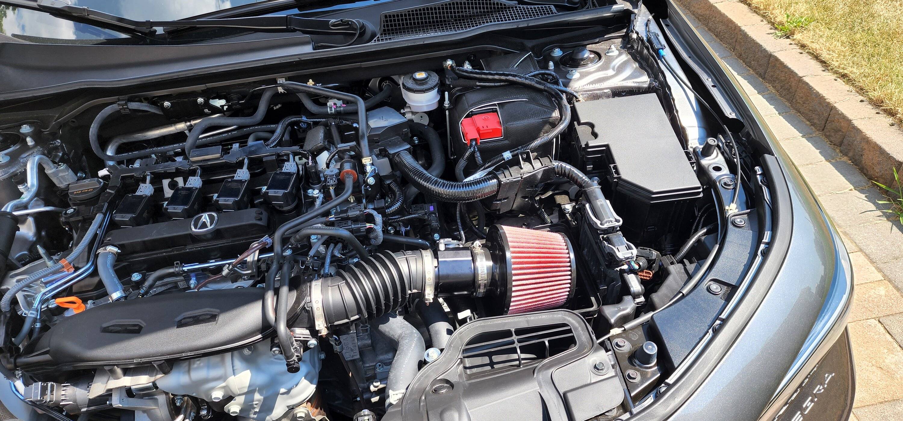

Acura Integra Ktuner for 2023 Integra is live! 20220825_130855
Acura Integra Ktuner for 2023 Integra is live! Screenshot_20220825-124130_TunerVi
Finally did my little intake. Sounds good and a long drive in traffic fuel trims looks okay pretty much similar to stock. Air fuel ratios during pulls seem to sit around 10.7 which was better than the low 10s I was getting before. Today it's 94f and without an airbox a short ram suffers in this car. Knock control did shoot up today but nothing insane. Waiting for 3d printed box to finish and then once I know it's perfect I'll print out a nice one with logos and stuff.
