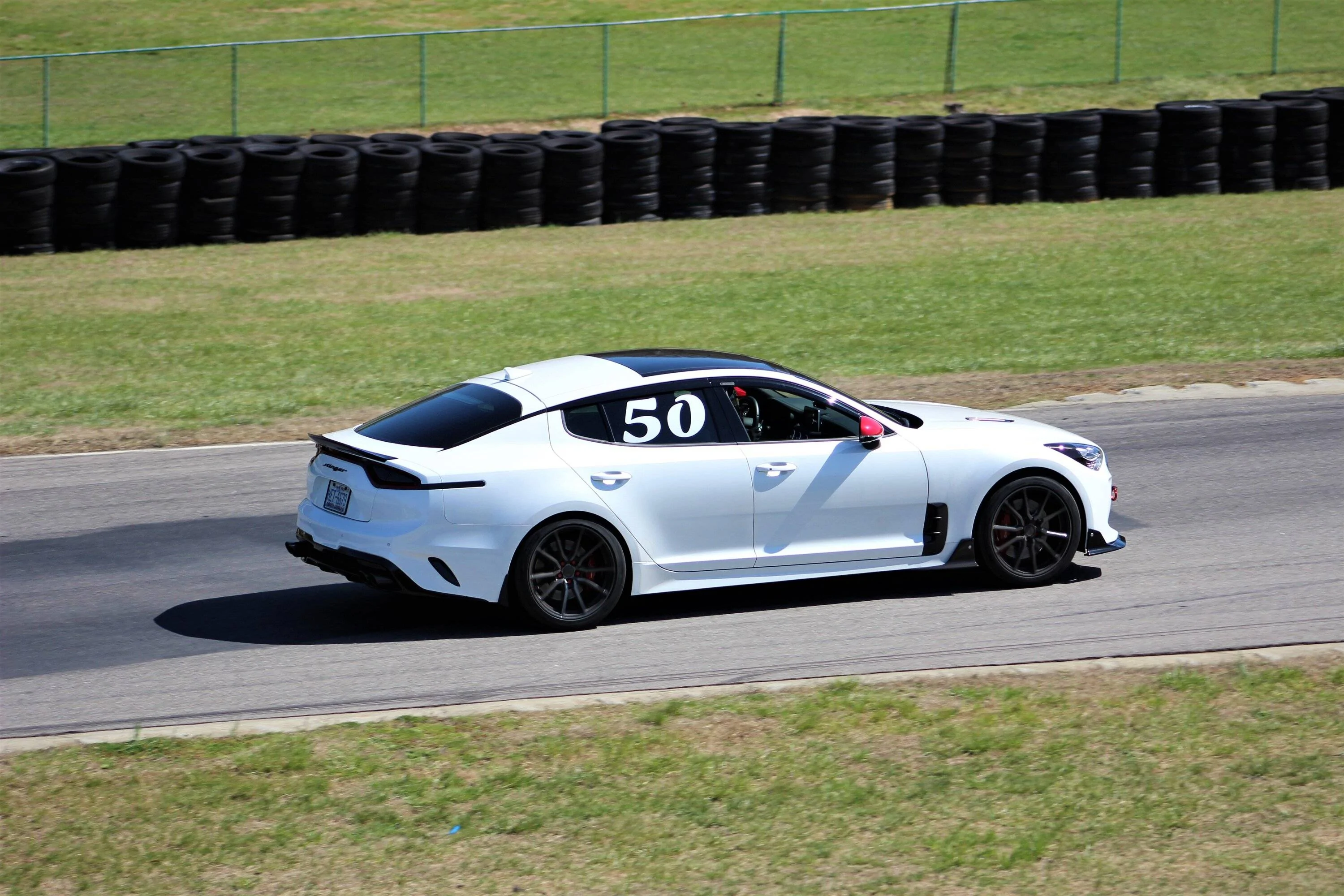

The Stinger was awesome and I was pushing probably 475 HP at the wheels and over 500 tq.
Loved the car.
After I purchased the car I went to the track and fell in love with it. Did as much as I could to make it trackworthy.
Ultimately I wanted a lighter, manual car that was track ready right out of the box. Plus my true love has always been JDM. Love hot hatches, etc.
1,451
1,214
Acura Integra JB4- Burger Motorsports wallpaperstinger
That's the current ride. I'll miss her but I can't wait until next week. Wife wouldn't green light me having both. LOL.

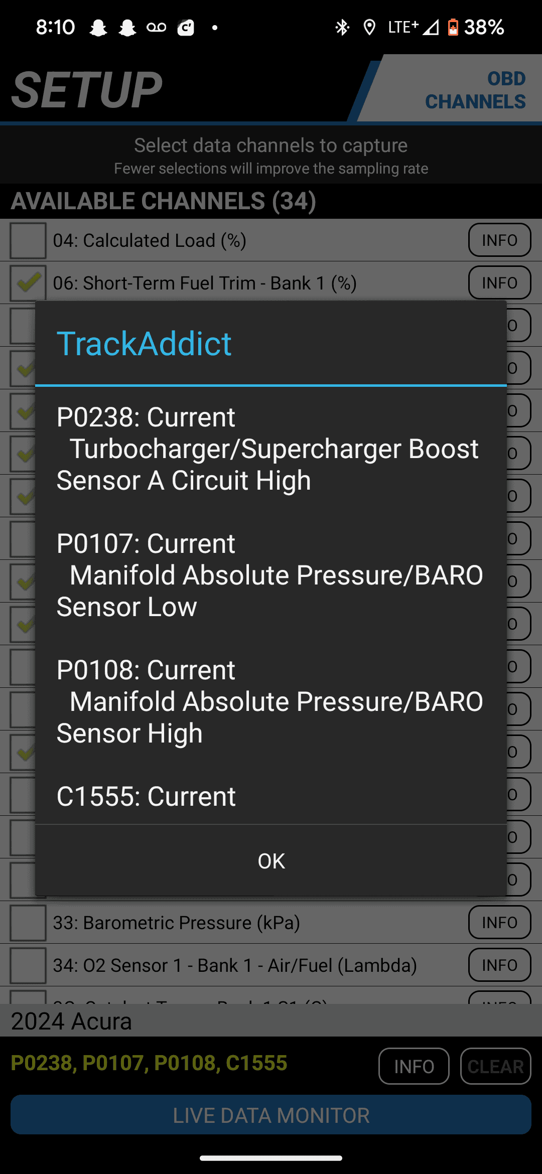

Ive been using it since Aug 18, my experience has not been ideal.
It works, it boosts a bit higher, and it pulls a bit harder at certain points through the torque curve, however, the car has averaged 0.4 sec slower on the 1/8 mile (track addict and draggy numbers, map 1 and 2).
I talked to Terry, he suggested I dial back boost in first (tire hop is horrendous on map 2), but the next day I went out to the car, and it wouldn't start! Took about 20 mins, and finally it fired up, and the MIL came on and car went into limp mode. JB4 reported no codes through the app.
I took it right out, plugged in my MX+ and there were 4 codes: P0238 P0108 P0108 and C1555
Terry says it sounds like the JB4 didn't power up, he's asked me to open it to verify the wiring layout, which I'll likely do tomorrow.
MIL went out on its own, I cleared the codes and it seems ok ever since.
I'm going to continue troubleshooting, but this was my first and I'm thinking it's my last piggyback tune.
There has also been a noticable lag, almost a hiccup when going WOT in 3rd, which can be seen in the logs as a huge momentary spike in trims and afr, but not a drop in fuel pressure.
It's a quick n dirty novelty for a bit more power, but I get the feeling it's completely untested on DE5, and there's not too much data available from FK8 or FL5.
I saw Flashpro is out now, really wish I'd just waited.
Acura Integra JB4- Burger Motorsports Screenshot_20230920-201015
