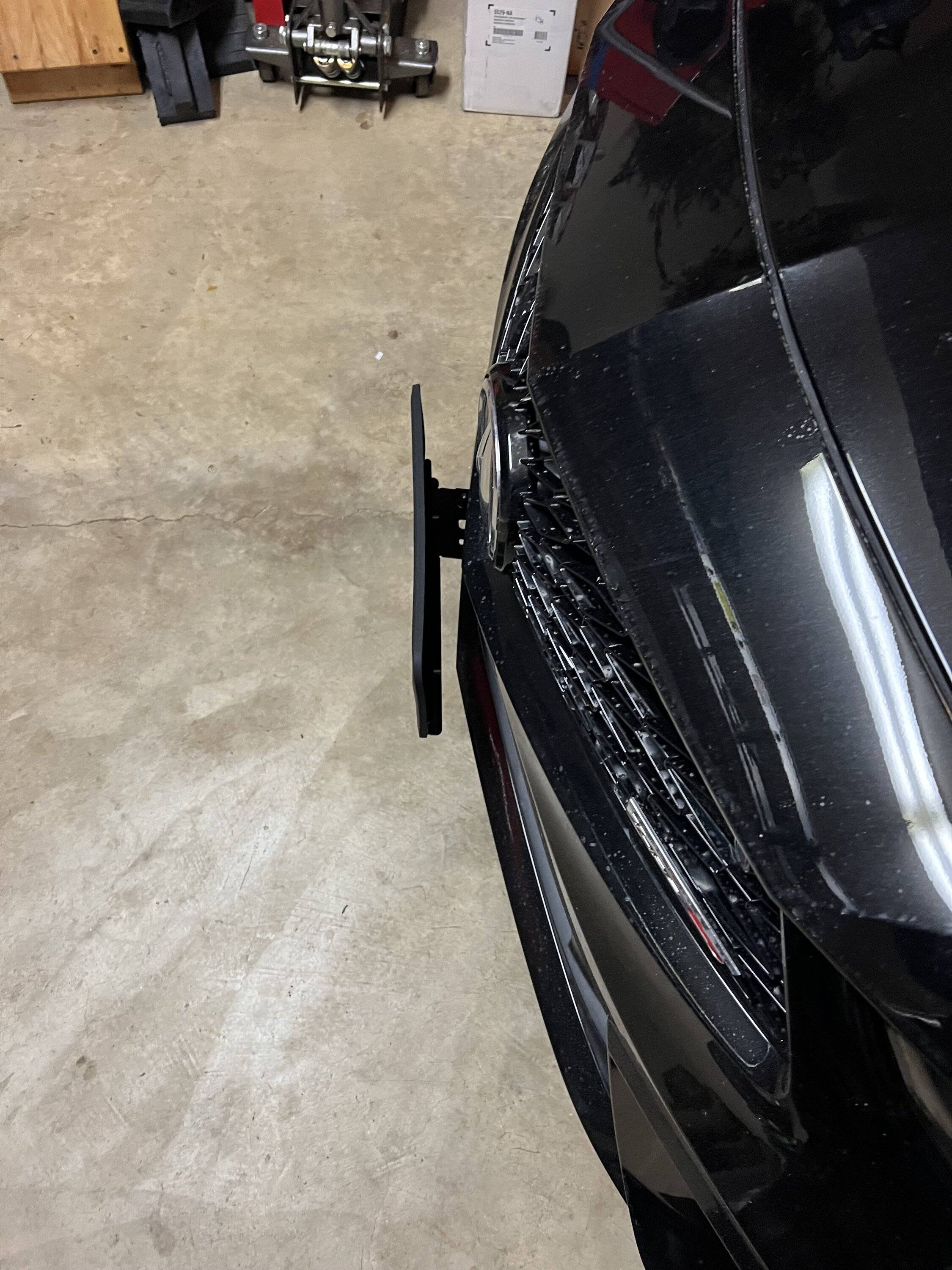

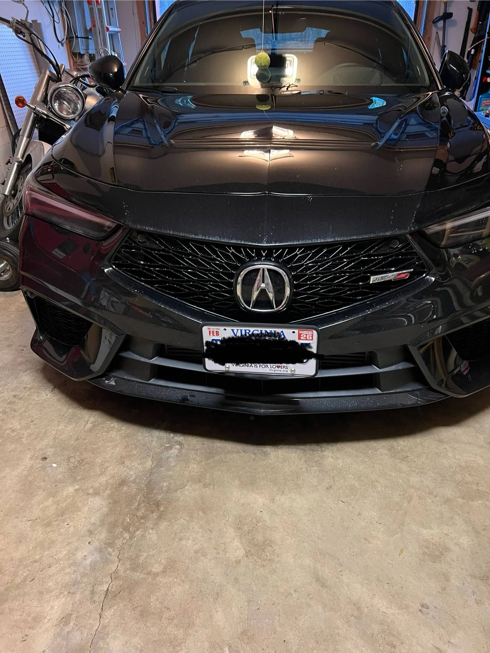

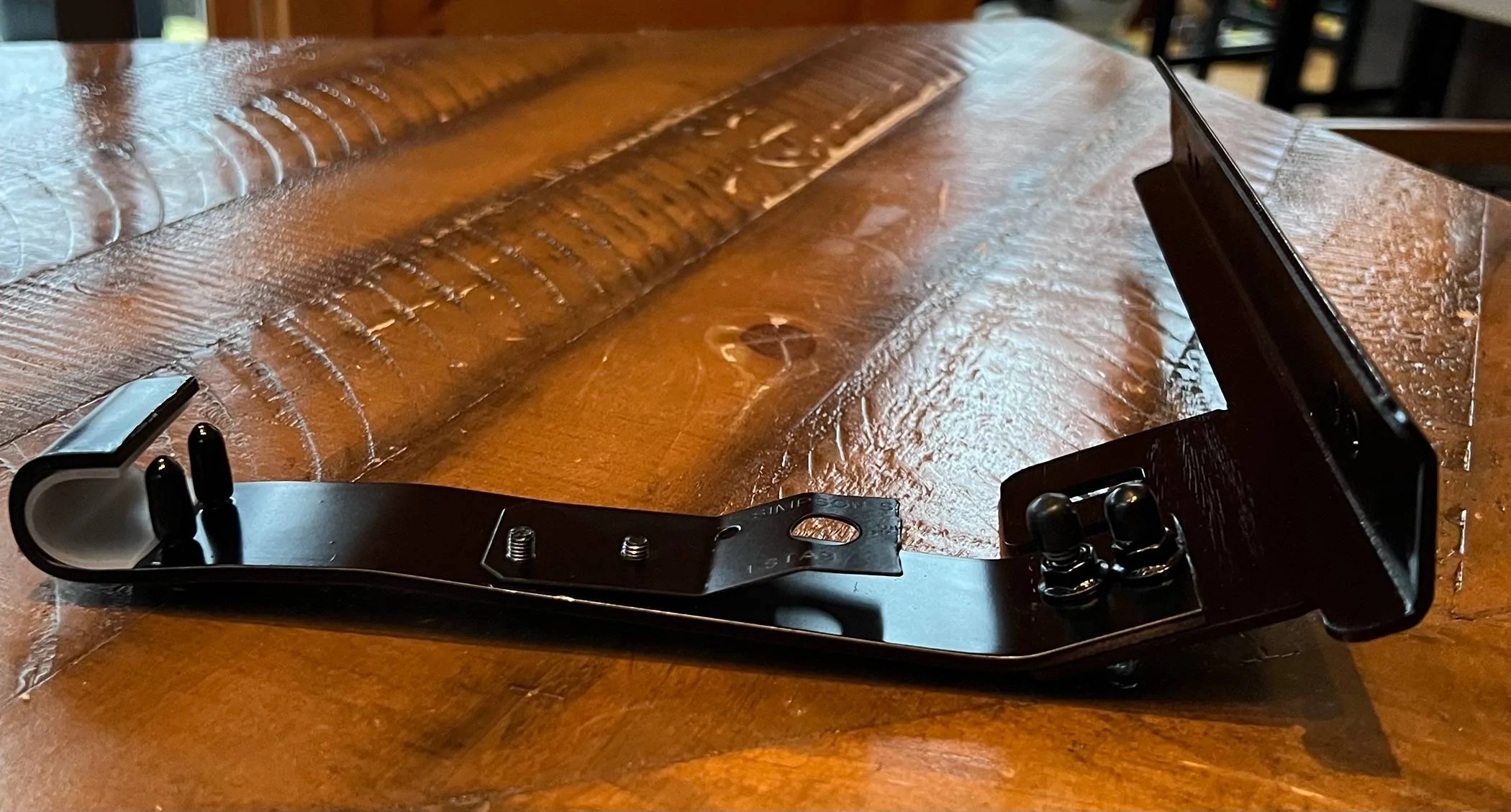

Decided to design and build my own no-drill solution. Seems to be holding up pretty good, and doesn’t block any appreciable airflow.

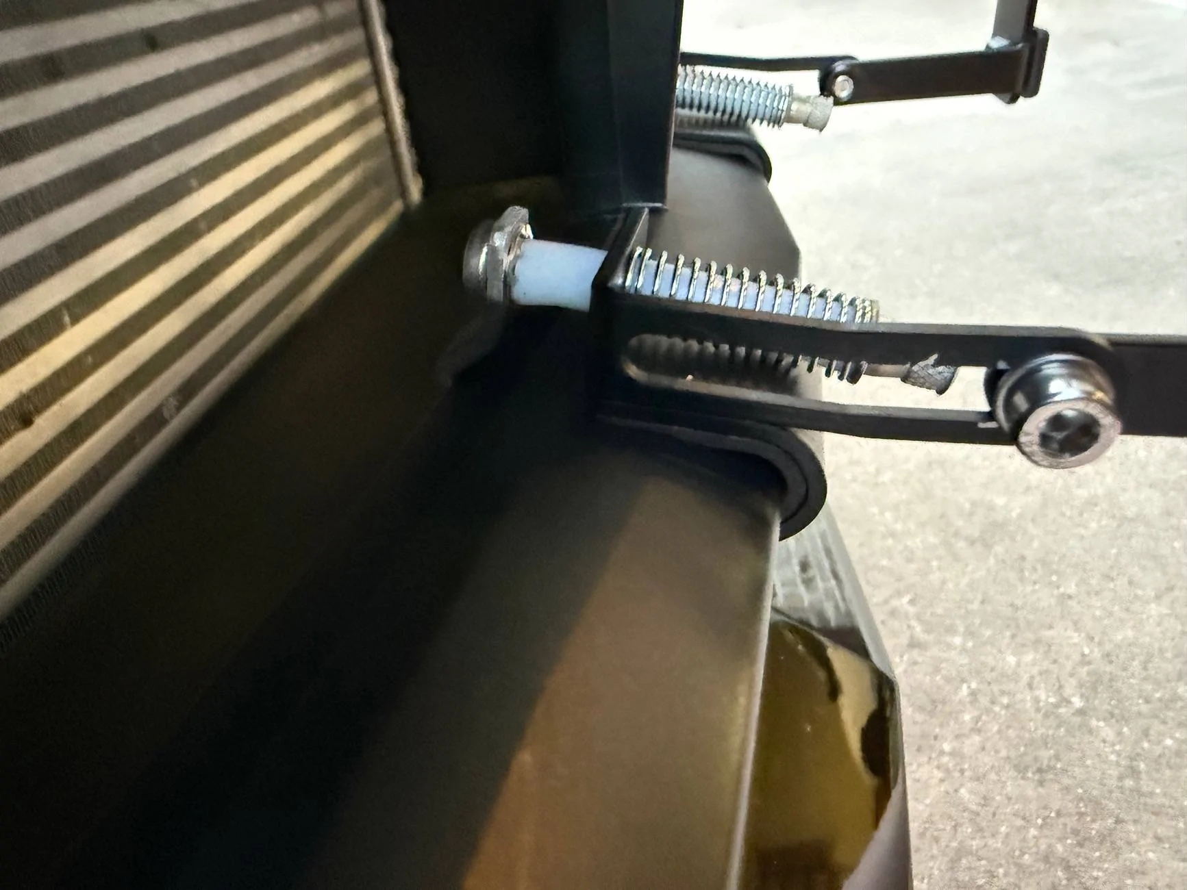

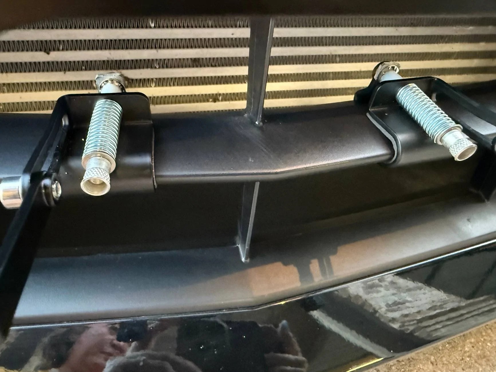

looks good, how is it mounted since it's not drilled?
There is a solid aluminum mounting surface above the stock intercooler I’m using. I have a J-hook style connector that wraps around the aluminum with hex head screws to prevent forward or backward movement. I have some thin rubber to prevent metal-to-metal friction. Pictures show more detail.

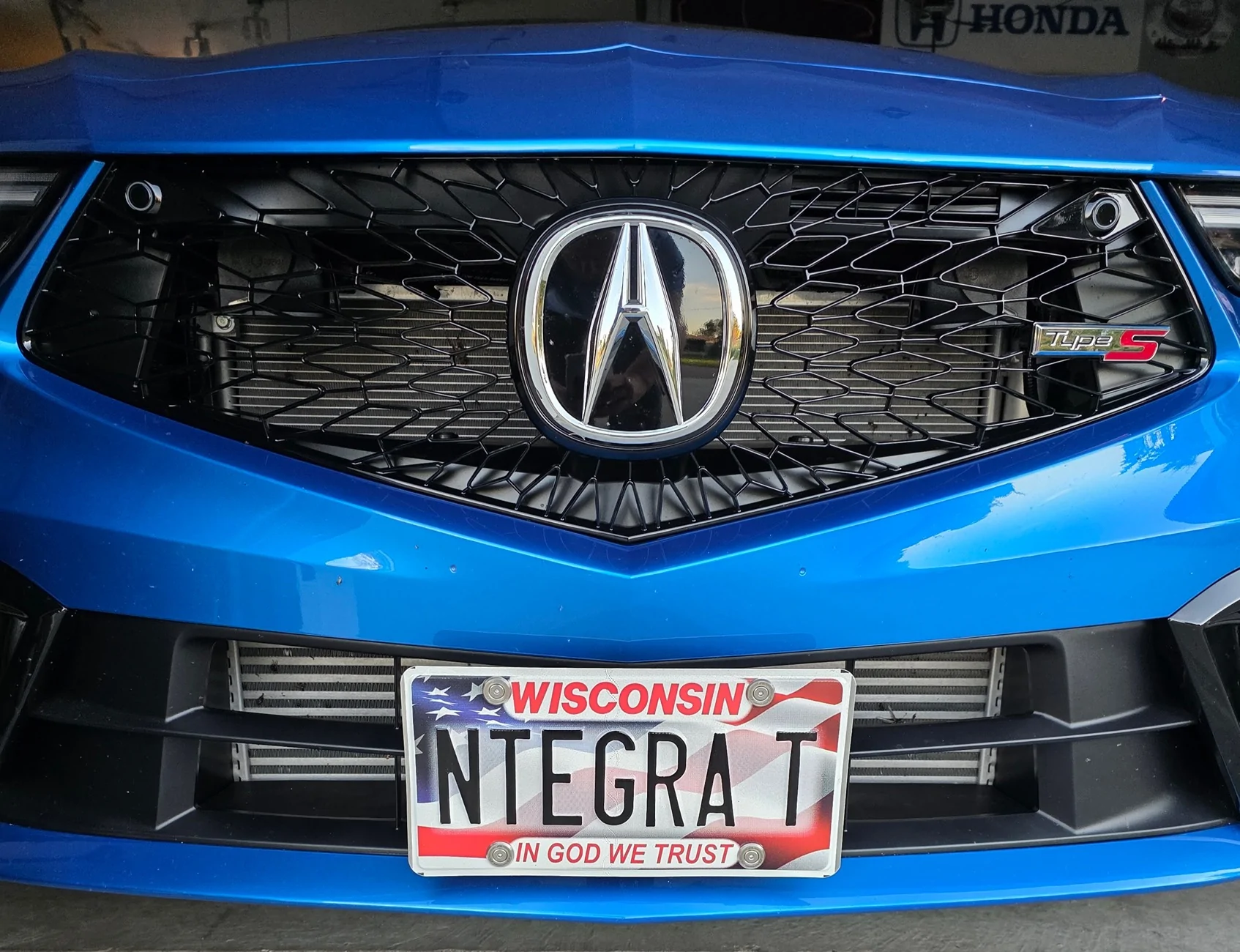

Just ordered this...
https://kollektivwerks.com/collecti...-drill-center-mount-license-plate-holder-copy
We'll see what it's like when it arrives. It was $158 total shipped.

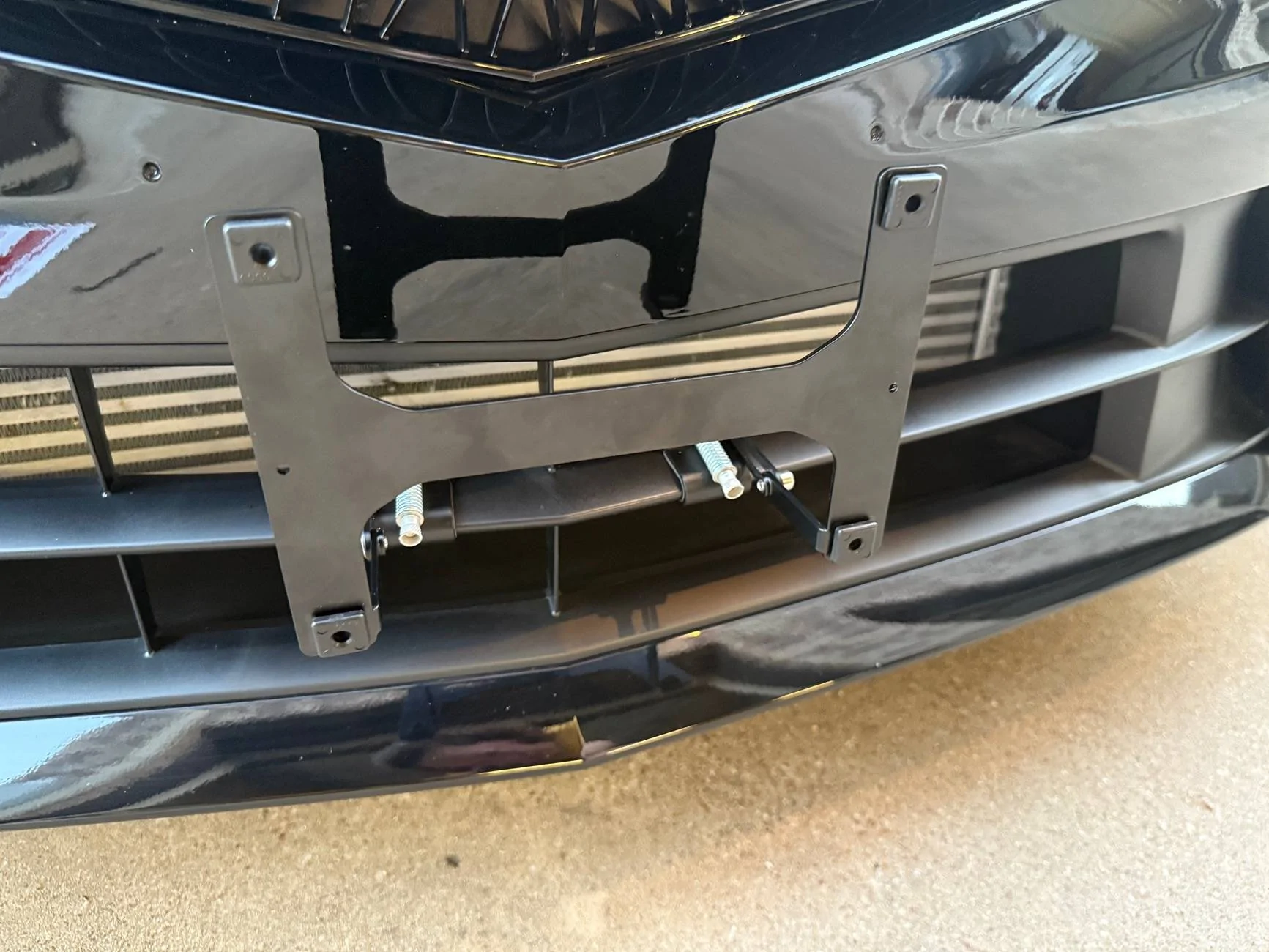

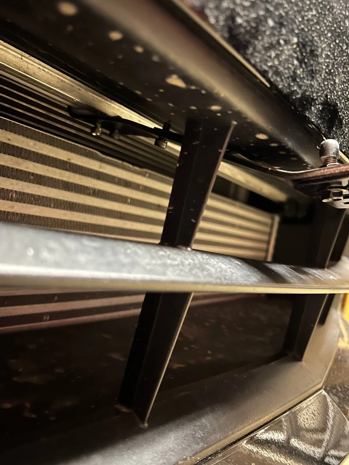

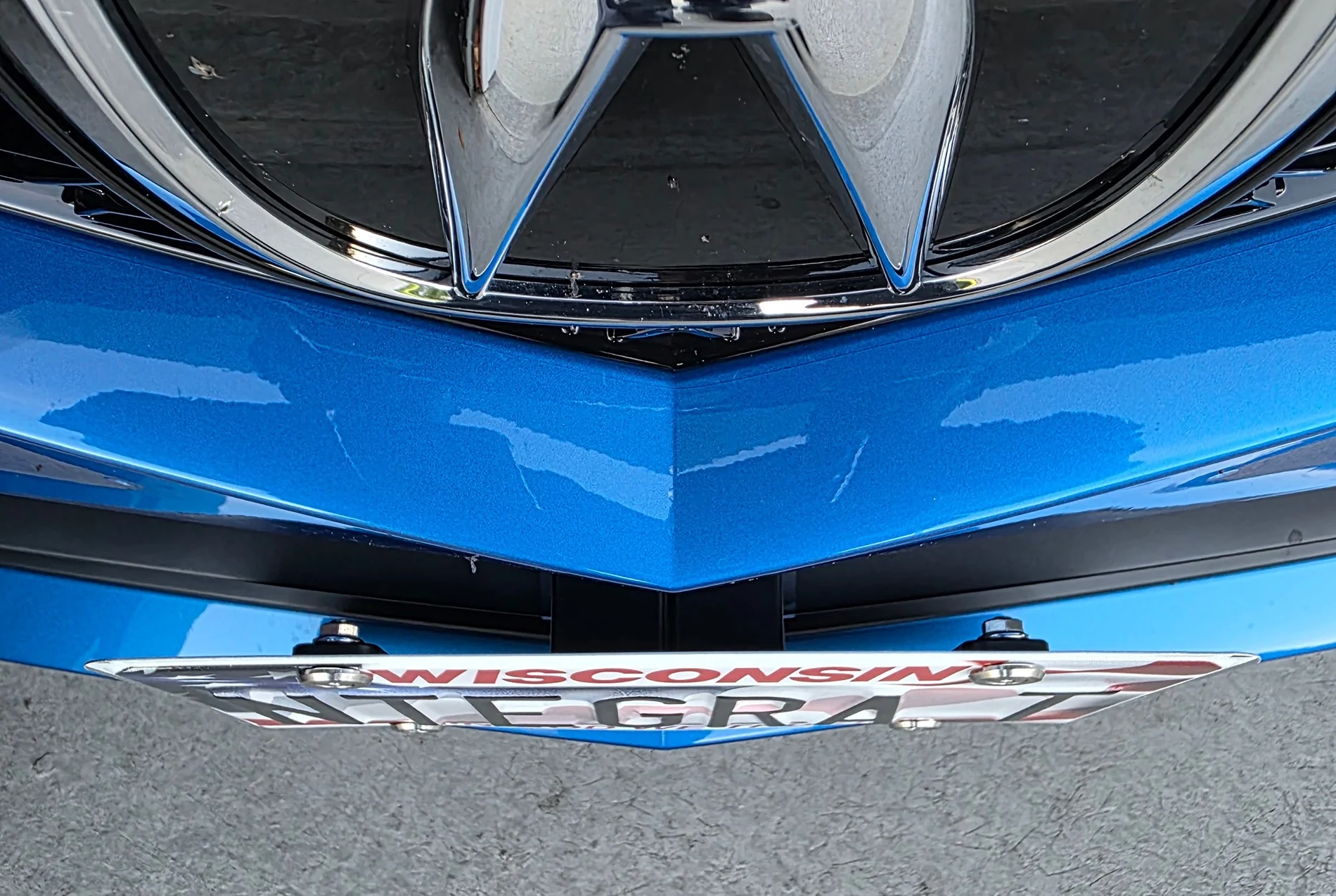

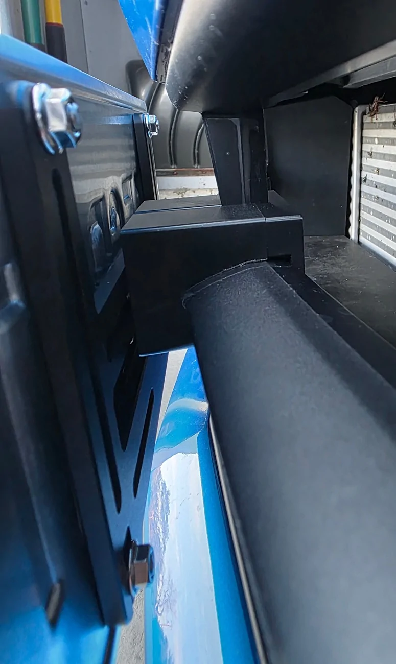

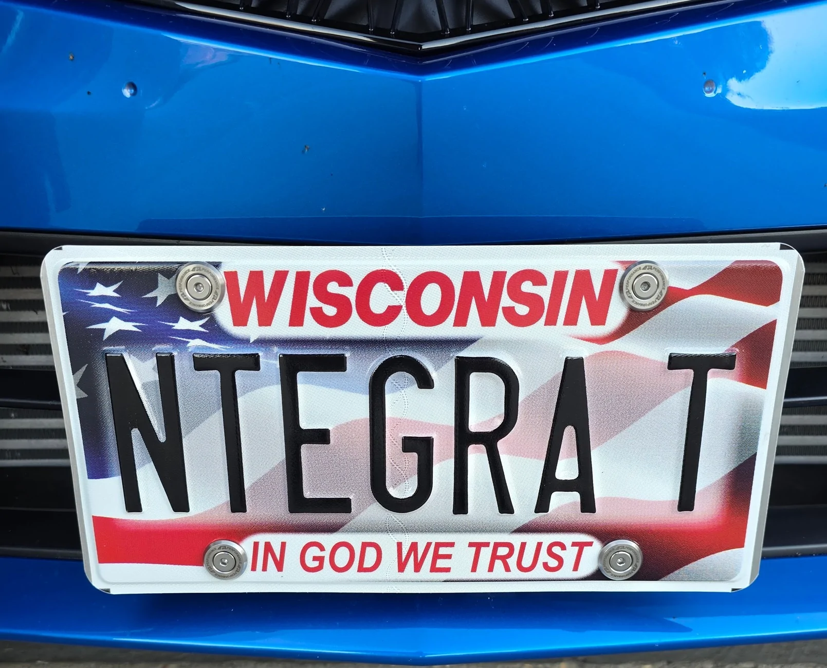

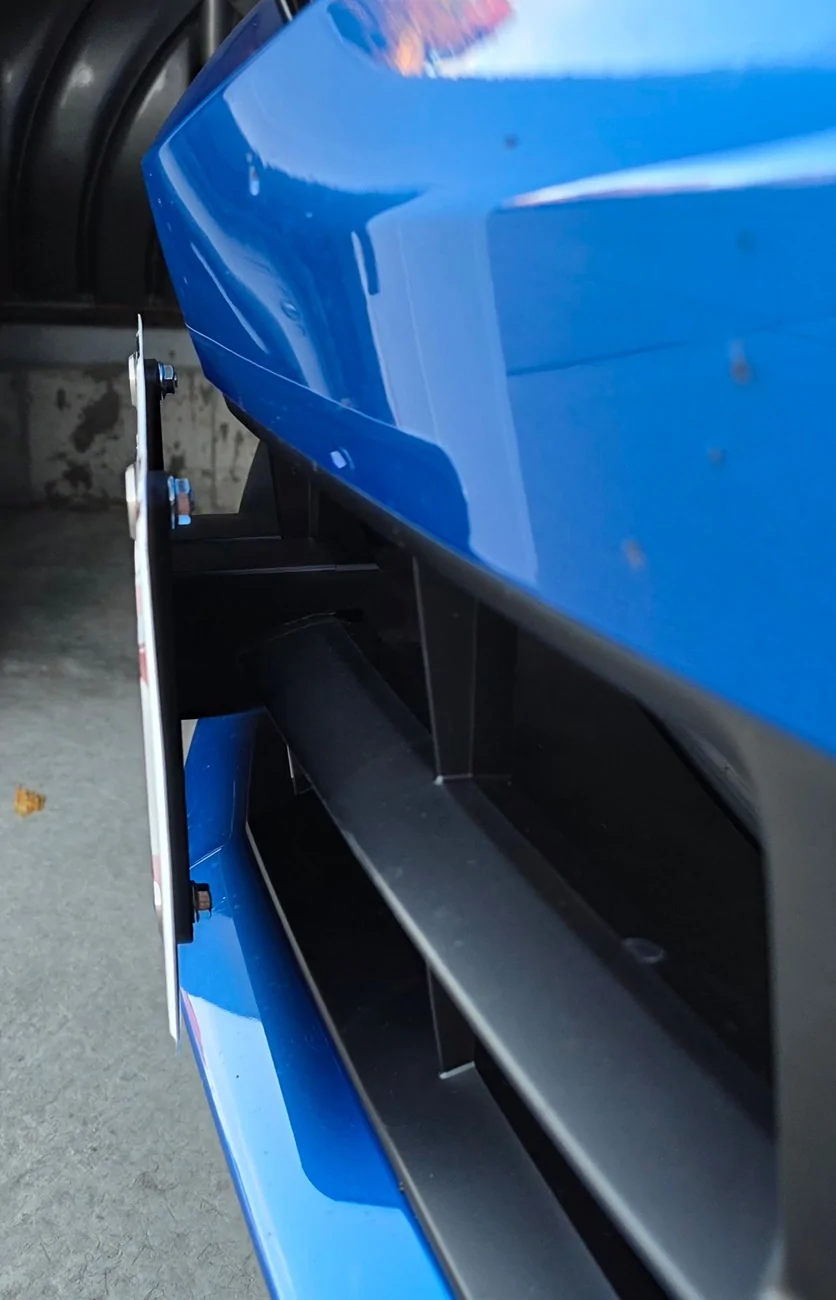

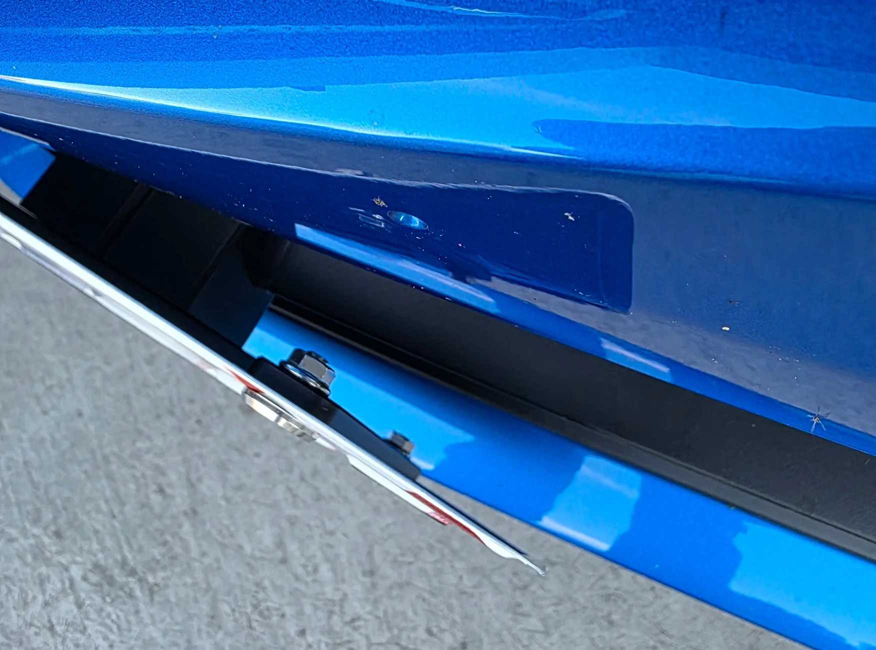

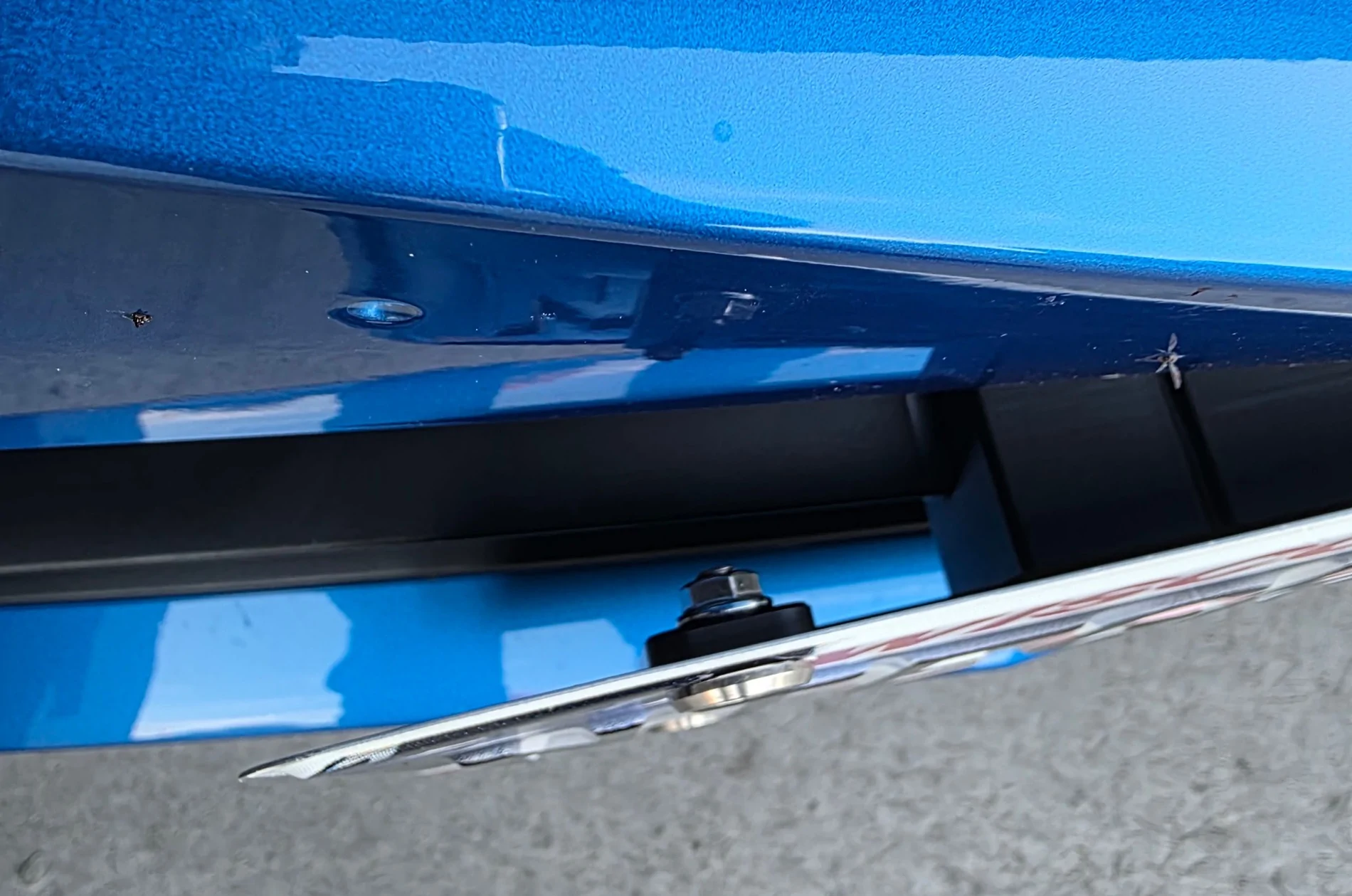

10/4/26 update... I like it very much. I used it pretty much as it came but I added some foam on the back side where it's sandwiches together around the center part of the grill to make sure that there was no slop or play whatsoever. I also added some rubber weather strip on the back side of the license plate exactly where it meets to the aluminum black anodized frame simply so there was some vibration protection. It's probably fine without that but I tend to be a little on the overkill side. I also decided not to use a license plate backing plate to add stiffness because the only thing it would help with was the very sides and so I didn't want the added plate because of that so we'll see how things go. I used my own APR Performance fasteners because I like how they look and I cut them down to length so they'd fit properly threaded into the inserts provided. I also added some serrated flanged stainless steel nuts to the backside just for added security. The company also provides 100% stainless steel hardware with this bracket.
If I had any feedback for the company as far as making any changes to it I would probably reduce how much it sticks out from the bumper by approximately 1/4 of an inch to reduce the gap between the bumper and the back of the bracket. I'm sure that at speed the mount will compress and move and flex the grille back slightly decreasing this distance a bit but when I would push it straight back with my hand to where a quarter inch was remaining it was quite a high amount of pressure and I don't know that the bumper would ever see that much compression at speed enough to touch the plate bracket to the bumper. If somebody wanted to modify this and remove one quarter inch from the face of this it looks to be very easily done by simply cutting off of the front face of the mounting block.
