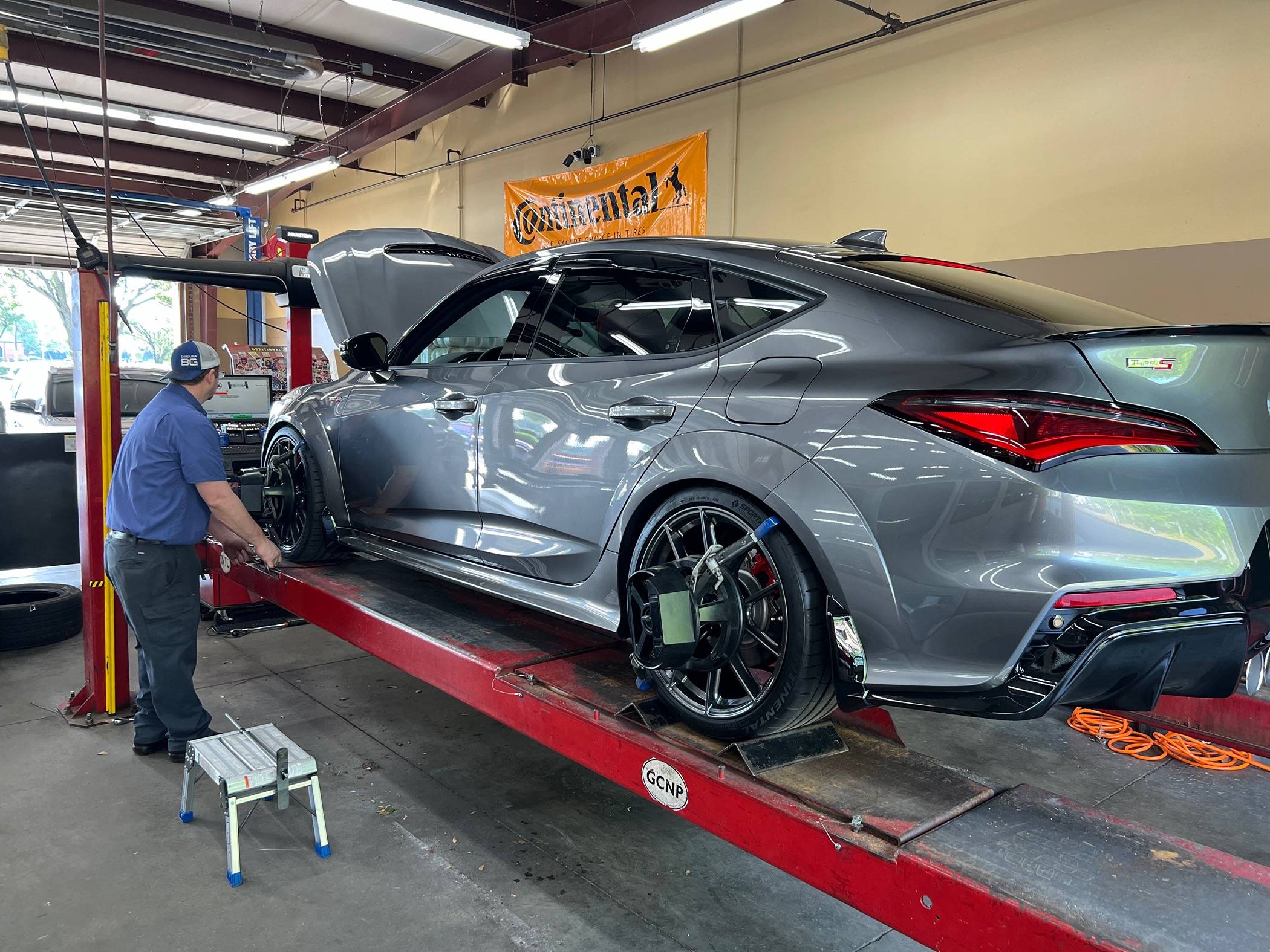

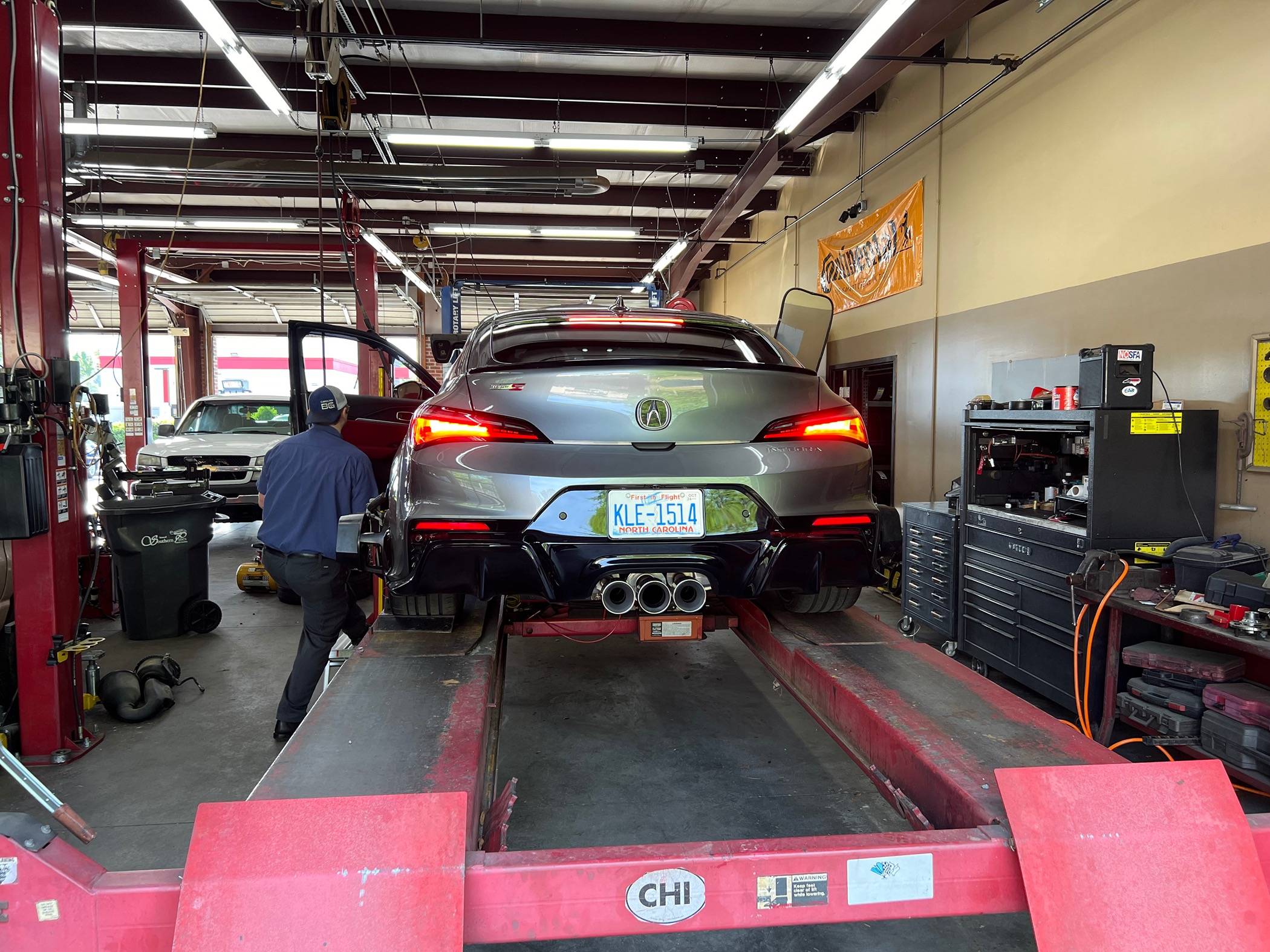

Headed back to VIR in three weeks! Can't wait. Had my first oil change today (Mobil 1- 0W20, full synthetic) and checked all suspension bolts for proper torque, while it was up on the alignment rack. Also removed guide pins from the front dampers to tweak the camber a bit. All we could muster up was -2.1 left and -2.2 right.
Rears are stuck at -2.2. Nothing I can do about that at this point.
Hopefully the Eibach springs and rear sway, along with the 275/30 Conti's will help with body control. Looking for some confidence!!
