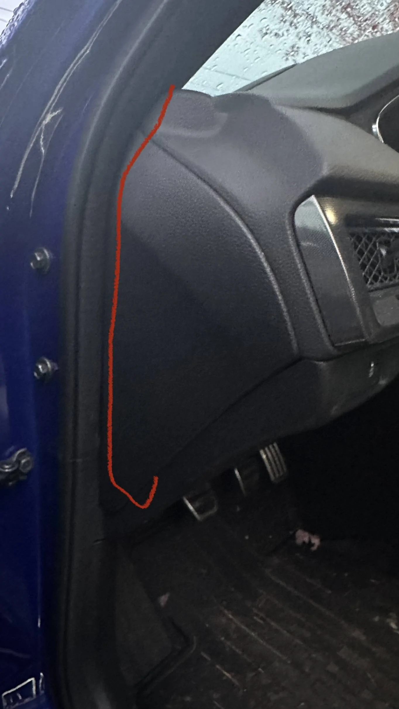

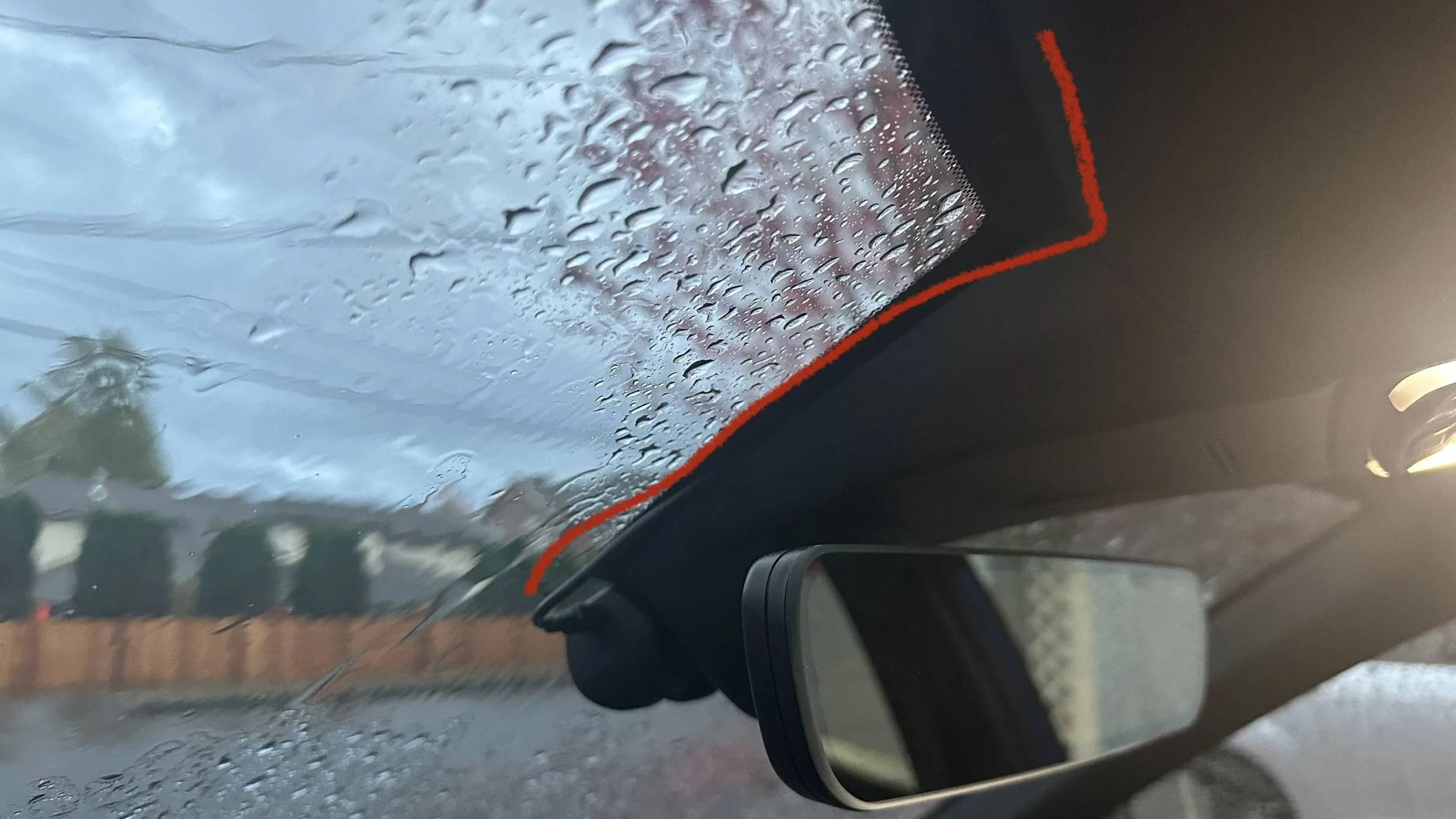

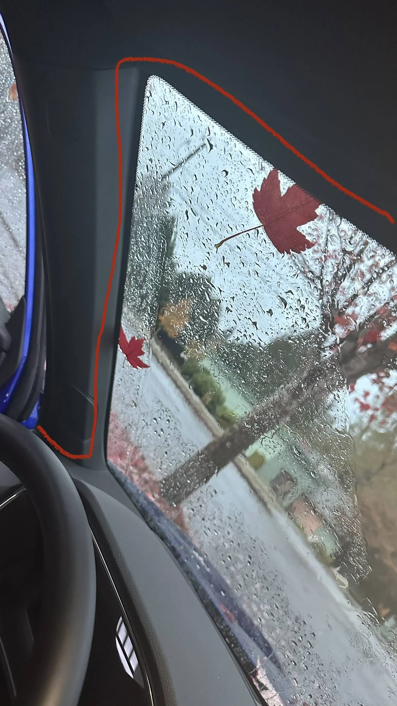

i Have my Dash Cam hard wired from the fuse box with a fuse tap, it is running along the headliner on the driver side to right behind the mirror.
no panels removed just used a small spudger to push the wire under the headliner and trim.
you can only see it slightly as it goes to the camera. basically have to be looking for it to see it.
took me maybe 20/30 min to run the wire.
i have a ddpai dash camera. that i had in my old car.

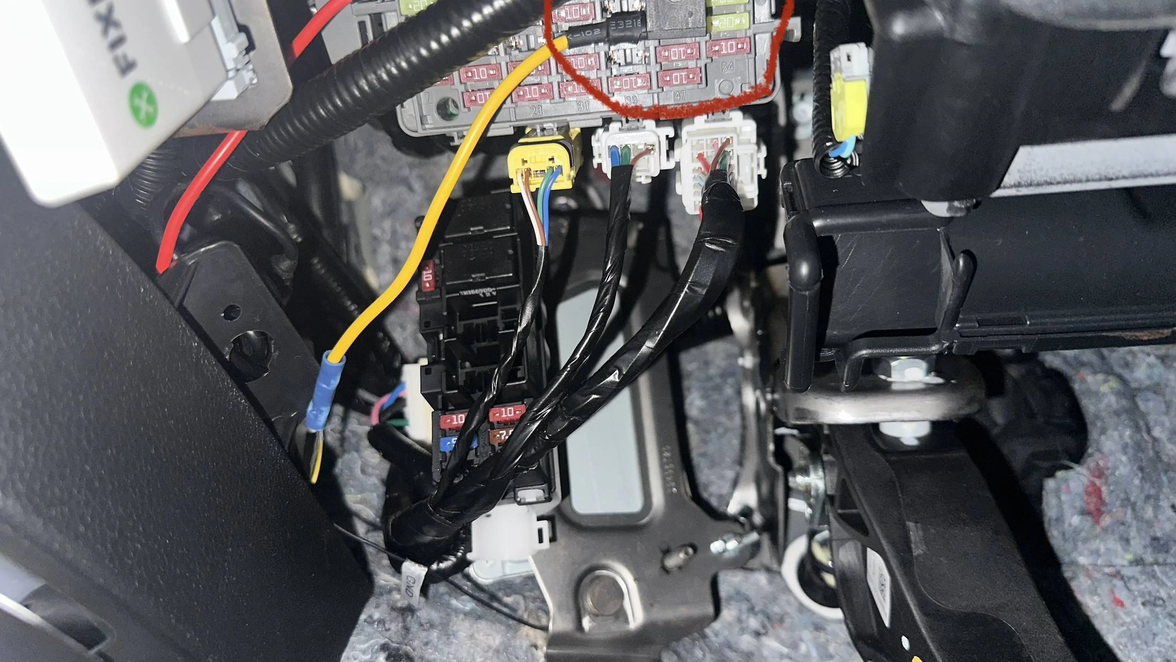

edit: here's a few pictures with a line showing where i ran the cable for mine. also sorry didn't get a great picture of the fuse tap location
mine is tapped twice one for when on and one for parking monitoring if your dash cam supports that.
What fuse did you tap to hardwire your dash cam? What amps for the fuse ?

Figured it out. Got me a circuit tester. If you installed the 2023 Accord Homelink Mirror like I did and used Fuse 18 as part of the harness installation as outlined in the instructions, you can use that for your Constant. Even if you didnt install the mirror, Fuse 18 can be used for your constant. Tested with the circuit tester and confirmed it has constant power to be used for Parking Mode.
Fuse 18 (15A) can be tapped for Constant power
Fuse 45 (10A) can be tapped for ACC
