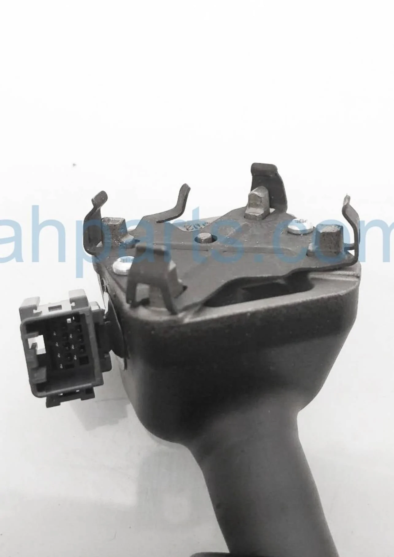

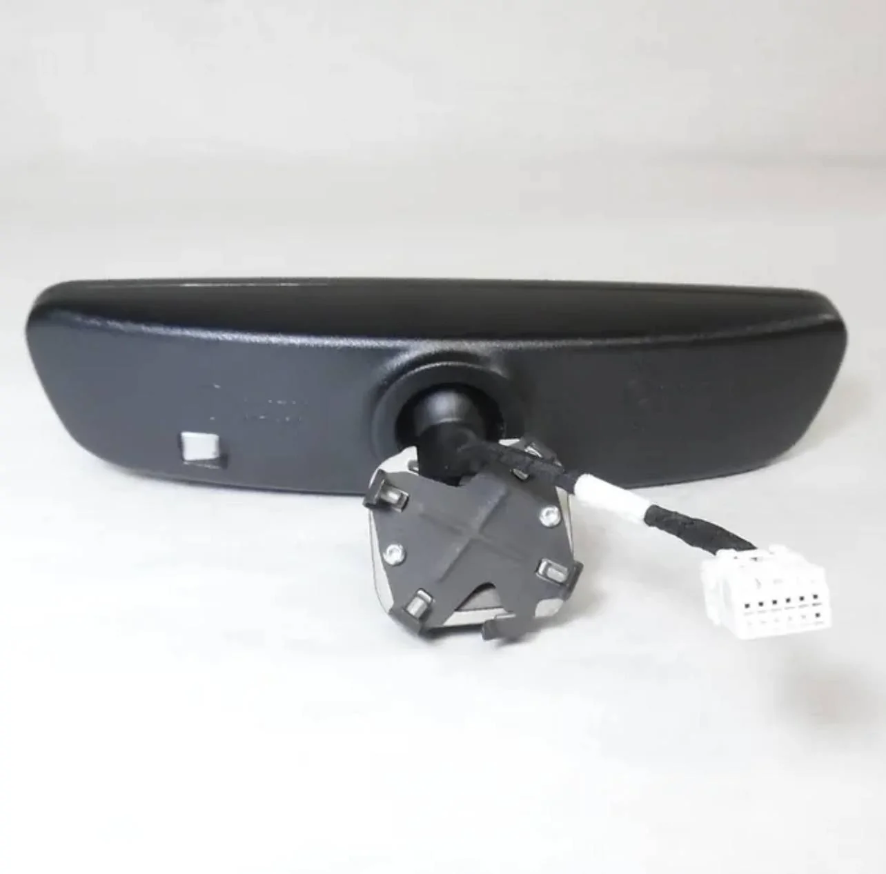

I did a little bit of research today prior to taking stuff apart in both our cars. I found these pics online that show connection types. It seems like the Integra has a 7 pin MALE plug coming out of the mirror. I’m assuming that the A-Spec and Type-S have the same mirror setup.
The other two frameless options that I was considering both have FEMALE plugs directly on the mirror. Not sure if people would want to snip and rewire the plug or possibly buy a whole new harness.
PIC 1: 2023 Integra
PIC 2: 2022 MDX (76400-TYA-A02)
PIC 3: 2023 Accord/CR-V (08V03-3A0-100)

Ok, this helps! So either of the mirror part numbers I posted along with a new harness (08V03-30A-100) will do the trick, correct?
Go back to my post #23 for the correct 2 part numbers for this DIY. They are also on the civicxi thread I linked. I don't know if any other part #s are compatible with them.
