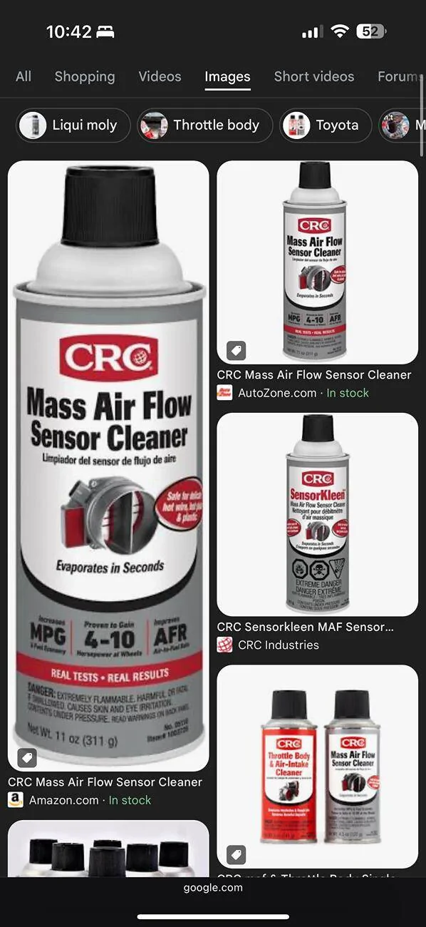

I saw the idea of cleaning the MAF. This is simple and a good idea.
I have read some airl filter charge fluid can gunk the MAF
I had Oil PRL cobra air filter before on my FK7. Car was shaking and idle funky. The K count on my ktuner went from .49 to 1.60. I replaced air filter and it didn’t change anything. I cleaned the MaF sensor even though it I didn’t see any gunk on it and the problem disappeared immediately.

Today I did the idle relearn, removed the catch can, cleaned the maf sensor I even reflashed it back to stock for a bit and nothing changed whatsoever..
I’m at the point where I want to remove my injectors to go get them cleaned but I don’t want to spend any more money on this ā€œguessingā€ game I’ve been doing all along
