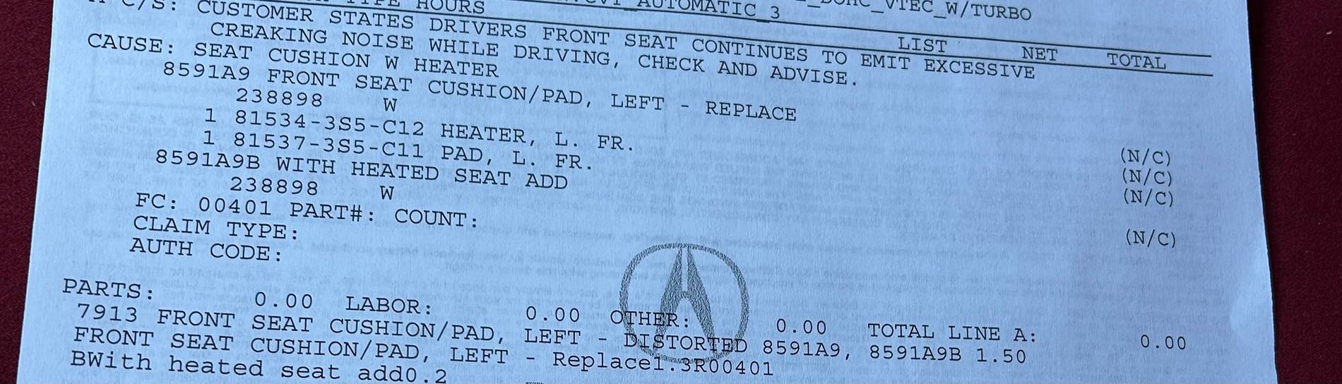

Update again. I picked up the car after two days of it in the shop. Attached are the parts they replaced.
I got the new ADX as a loaner. The interior is a nicer Integra. I think it will sell well given its size.
The service advisor said the tech went thorough with the repair this time and found shoddy work done prior (most likely by the first dealership). I hope it’s gone forever.

See my post above. I just picked up the car and took photo of parts replaced.

Almost a month after the latest fix, so far so good. No squeaking noises from the seat after ~500 miles.

Yours still good? I had them replace the same exact parts from your list about a month back and it was fine for all of a week and now the sqeaking is back and worse than ever. Hopefully yours is good for the longterm but i'm tempted to see if they will just replace the entire seat rather than playing this could be this or that game.

Yeah. At around 11k miles now and still good. Good luck with that. I tried to have them replace the seat at some point and they said corporate had to approve it which they did not.
