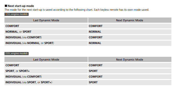

What I don't understand is why it seems to startup somewhat randomly. Sometimes it's sport sometimes it's comfort.
From what I understand, if the car is in sport plus when you shut it off, it will start up in sport. If it's in any other mode, it will default to comfort. At least I think that's the way it works.

I remember reading somewhere it had to do with the suspension setting. My individual mode I have my suspension in comfort and everything else sport+. Mine always starts in comfort, which is fine by me as I prefer to be in quiet mode until I leave my neighborhood.
