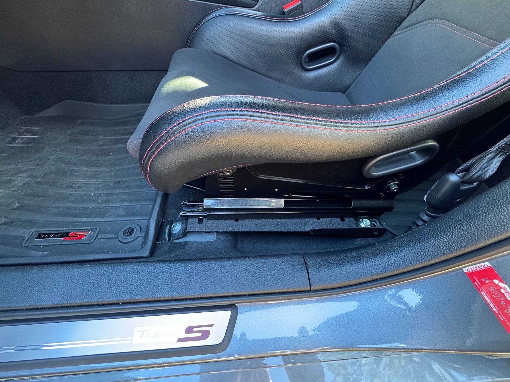

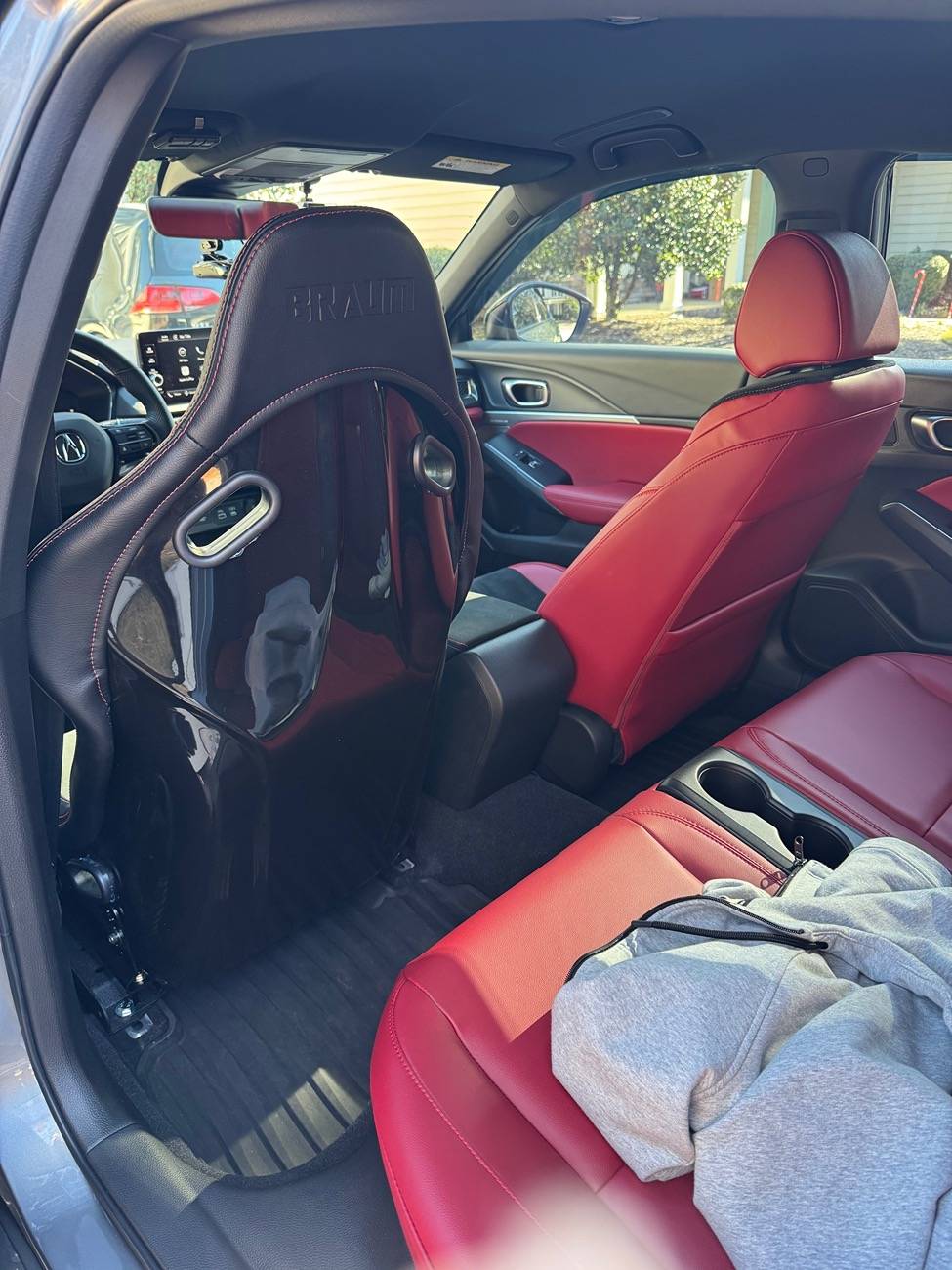

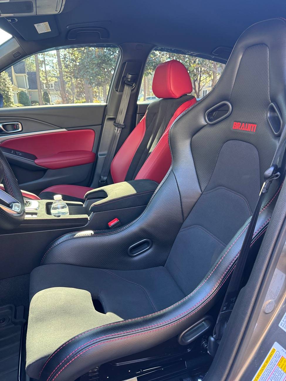

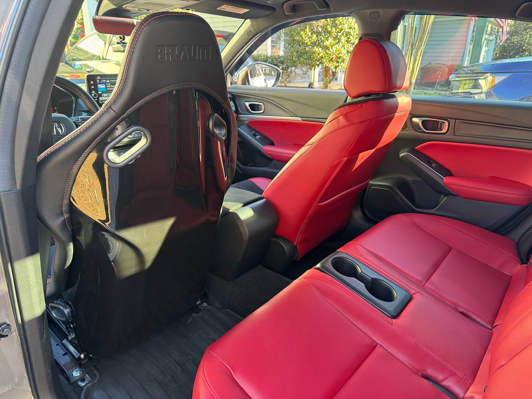

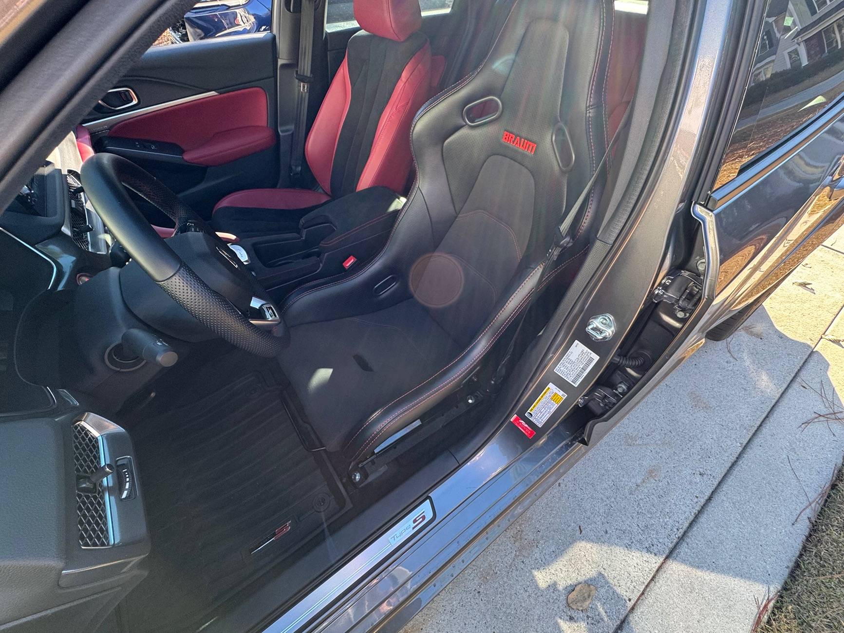

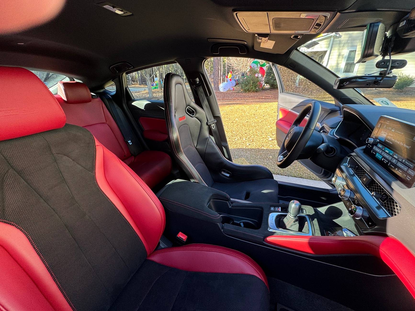

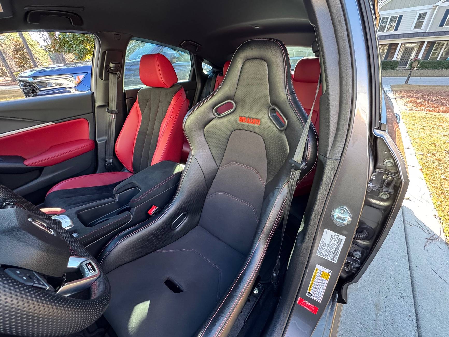

Finished up the passenger side as well. Here’s a few more pics. The two ohm resistor I put in the driver side did not do the trick as far as turning off the airbag light. And I cut the connector off L O L. I did save enough wire to reattach it when I eventually go back to stock.
I’m gonna do some more research on the situation and hopefully figure that piece out. I am using the stock three point seat belts, so the seatbelt situation is fine.

Thanks! I love it. Looks like it belongs in the car and it takes it to another level in terms of that race car feel. Colors match up nicely as well. I have 2.2 ohm resistors coming in so I can get the airbag light situation fixed. I feel like Acura kind of cheaped out on the seats. Could have sported them up a bit. The OEM seats aren't terrible, just not special like the type r. The faux leather on the Braum seats is actually as nice, if not nicer than the OEM faux leather too.

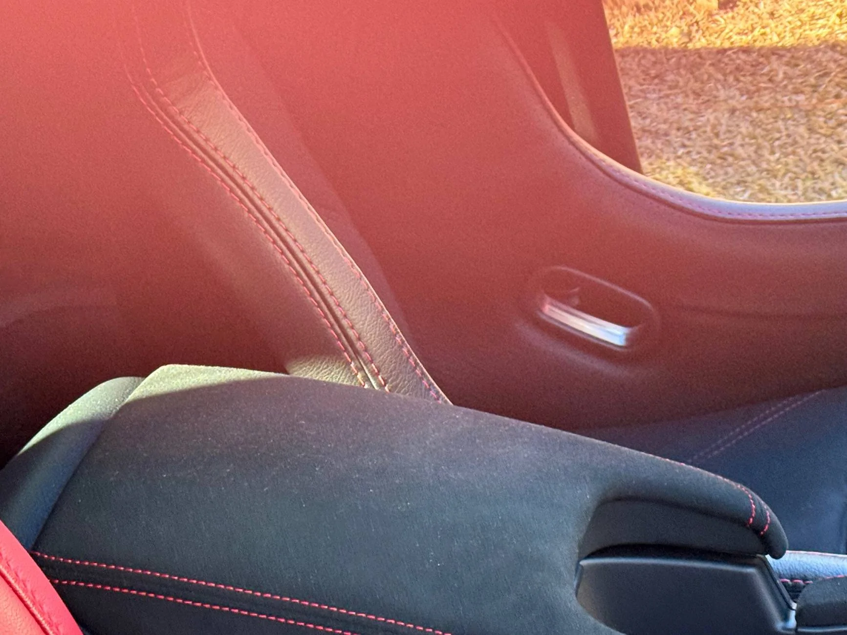

The color turned out very well with the armrest too!
