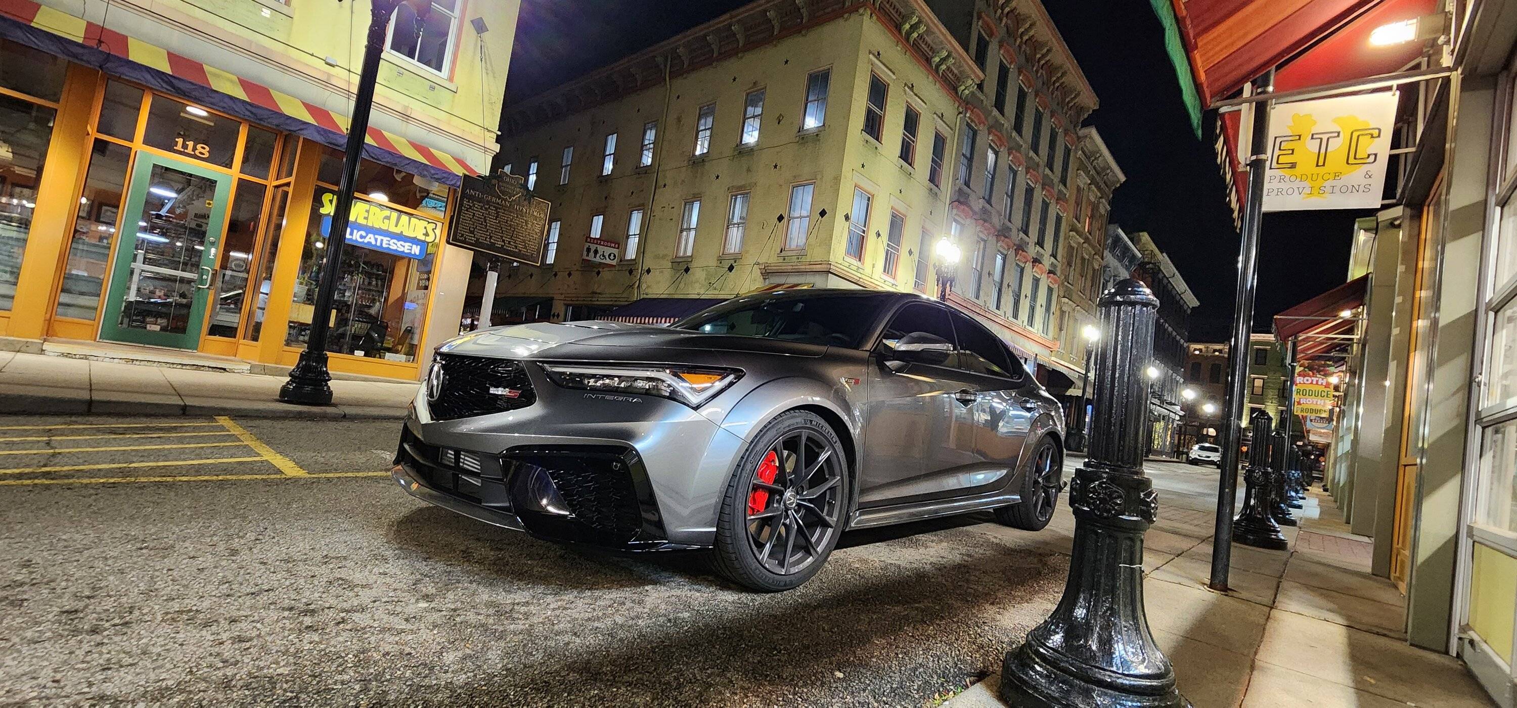

I have 265 35 19's AS4's on my ITS and they have been awesome... not as sticky as the stock tires but thats to be expected. I like the feel when hitting bumps etc with them more because with the bigger sidewall of the tire i dont worry as much about damaging a wheel. I've had them on the dragon multiple times this winter and have done fine. No rubbing at all or any issues. at highway speeds (70-80) speedo is off about 4 mph. I have almost 3k on the tires now.
