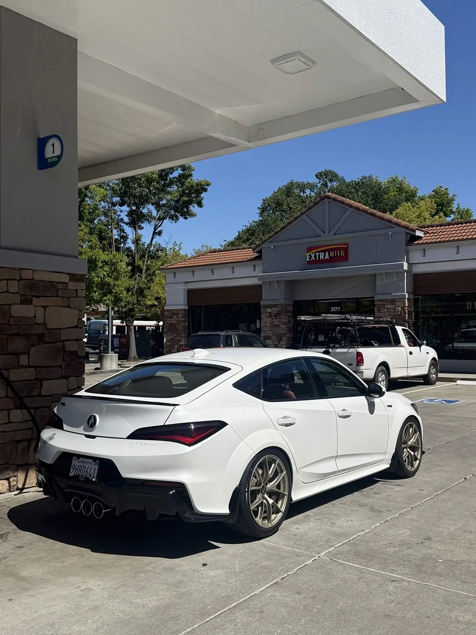

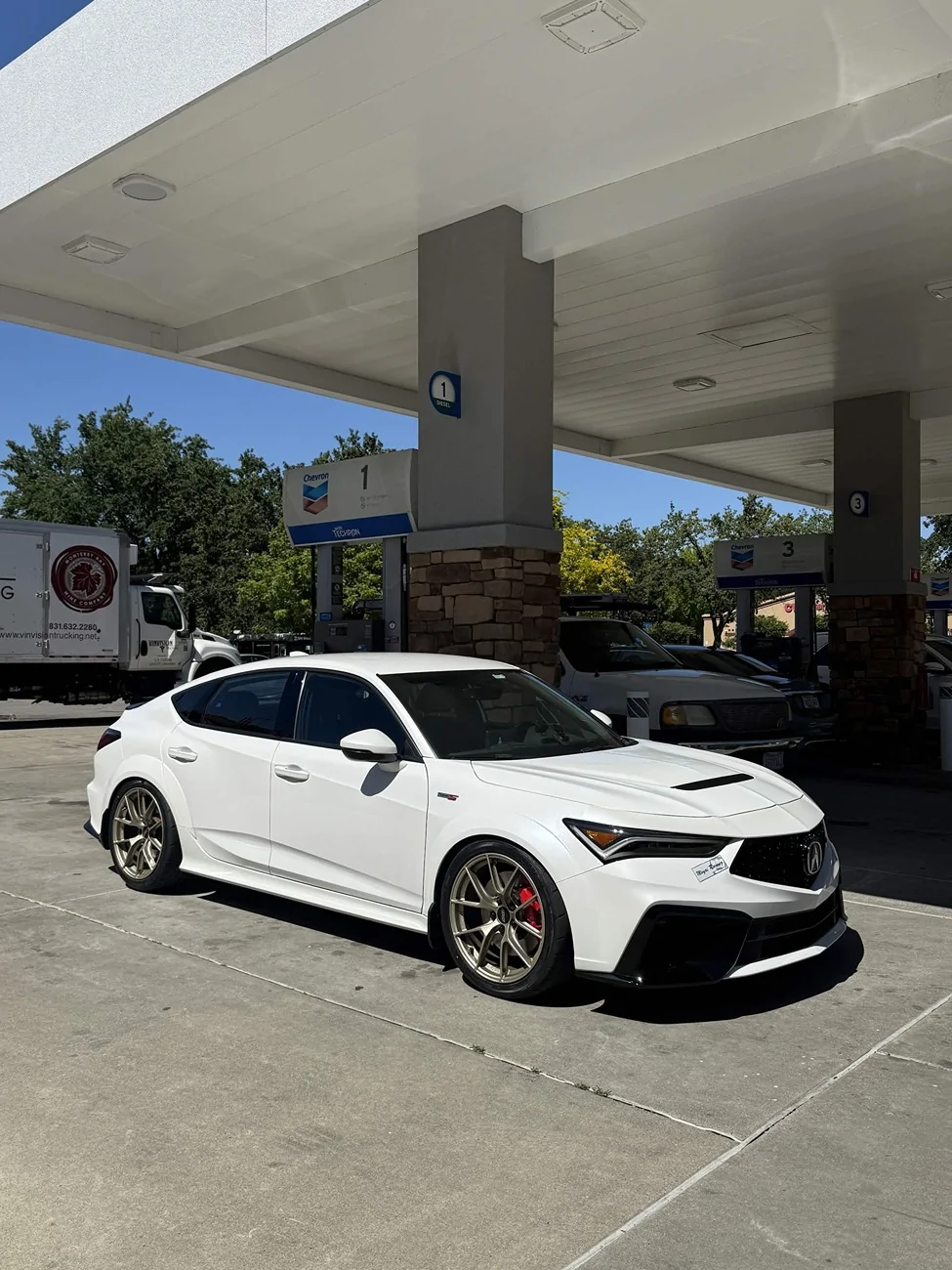

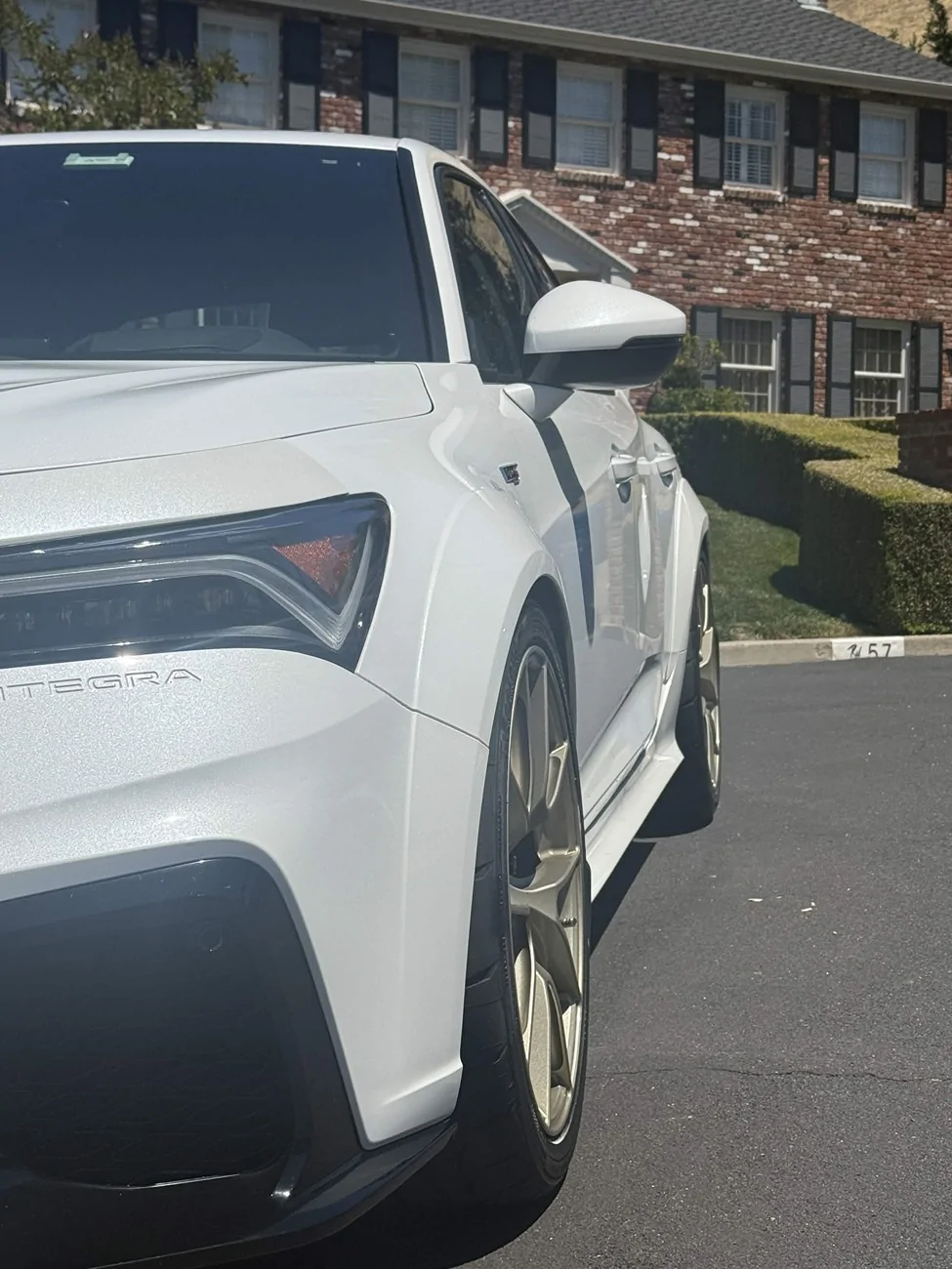

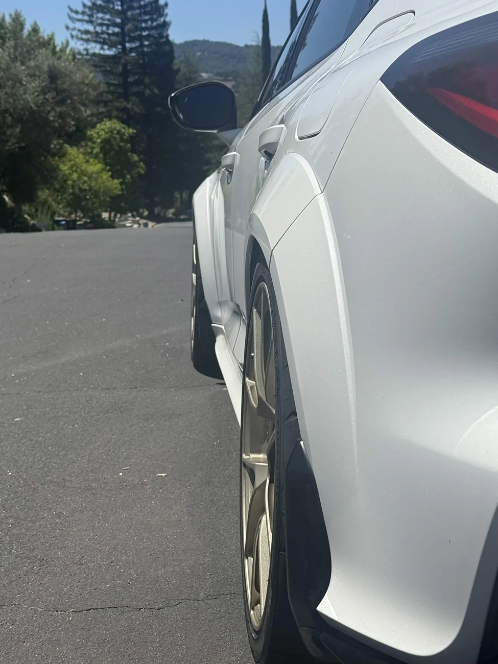

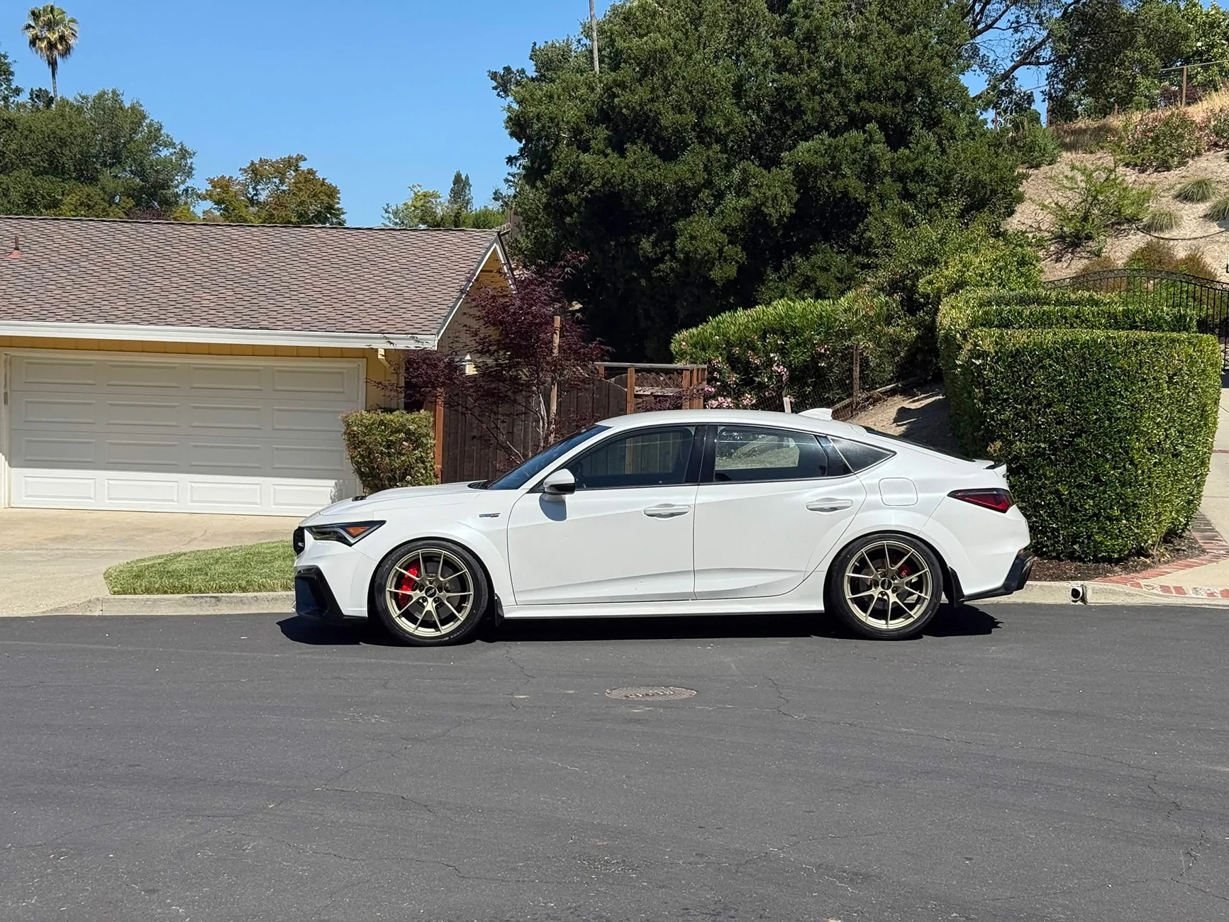

So it has been done. I think I am sort of venturing into fairly unknown territory but so far for hard road driving the car feels wonderful with the addition of the whiteline rear sway bar. But as I expected the rear camber went WAY too high. I'm sitting around -2.2 (pins pulled) in the front and -2.8 in the rear. I completely accept this as my fault because I'm running a huge tire. I think I will downsize to a 265-35 rather than a 275-35. But I'm not getting any rub with hard driving and crappy California back roads. I did not trim the bumpstops but I do notice I am hitting the rear a smidge bit but its nothing horrible. The front end feels wonderful though, very complaint. I just ran some errands with three people in the car and the ride quality didn't change. If anyone has questions feel free to ask.
I want to mention my full setup is:
Apex VS5RS 19x9.5 +45
Firestone Indy500 V2 275-35r19 I'll try to give update on these tires since they just came out in April.
H&R Lowering springs
Whiteline 22m adjustable rear bar (soft setting on stock end links)
I have ordered rear camber arms so it is going to be a little bit before I put them on. But I'm doing bump steer correction as well. I thought since I'm only doing street driving I'll just fix the rear camber and get the roll center corrected.
ONE MORE THING I want to mention that a few people have done this setup and the results are all over the place in terms of stance and rub. It completely depends on your tire compound and wheel combo. DO NOT do this setup on anything under +45 or on any 200tw tire as it will rub. I have heard that it isn't major, but I'm trying to look for something that works completely fine with daily driving.
I got extremely lucky and with this very specific setup I have no rub, nothing during full lock, suspension compression, hard bumps, and pulling into steep driveways.
