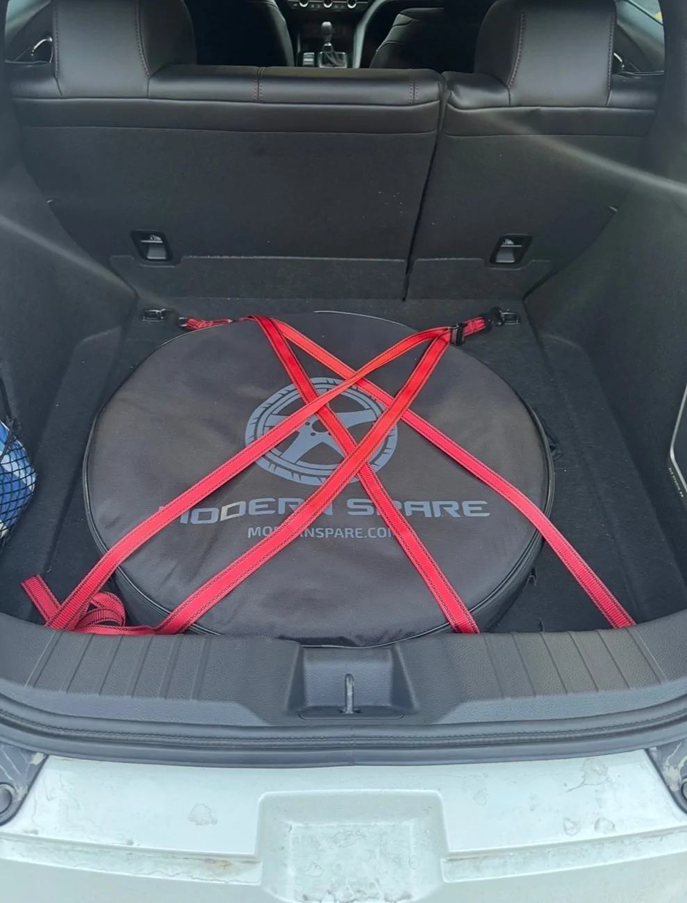

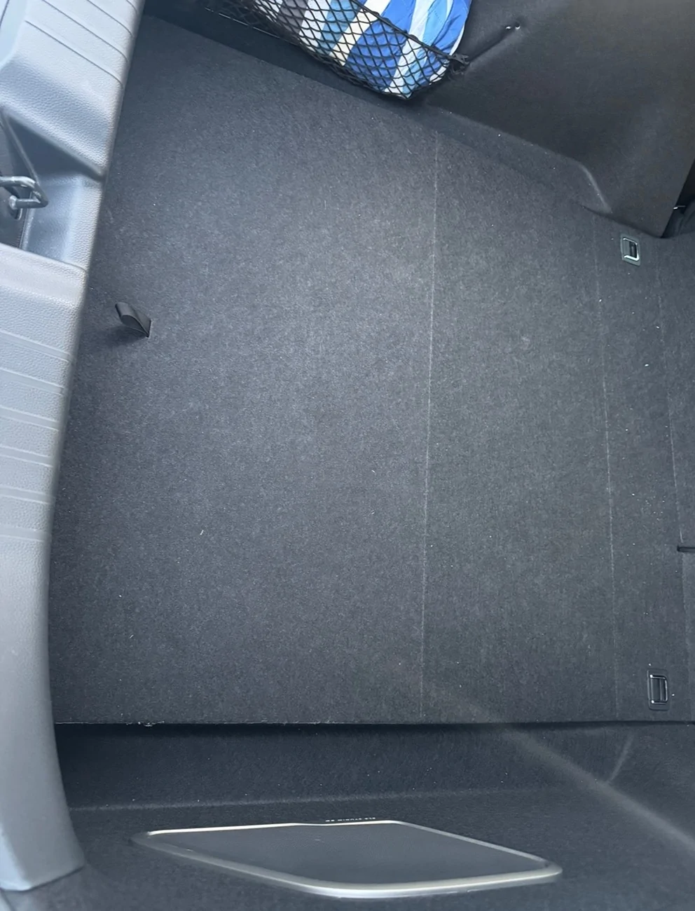

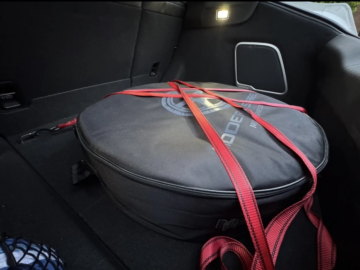

Got some pics for you guys so you can see how it fits in the hatch and under the floor. It leaves a small gap. I wouldn’t do that as a permanent solution but for road trips it isn’t bad.
Acura Integra A Spare Tire That Fits Under the Load Floor IMG_6489
Acura Integra A Spare Tire That Fits Under the Load Floor IMG_6490
Acura Integra A Spare Tire That Fits Under the Load Floor IMG_6491

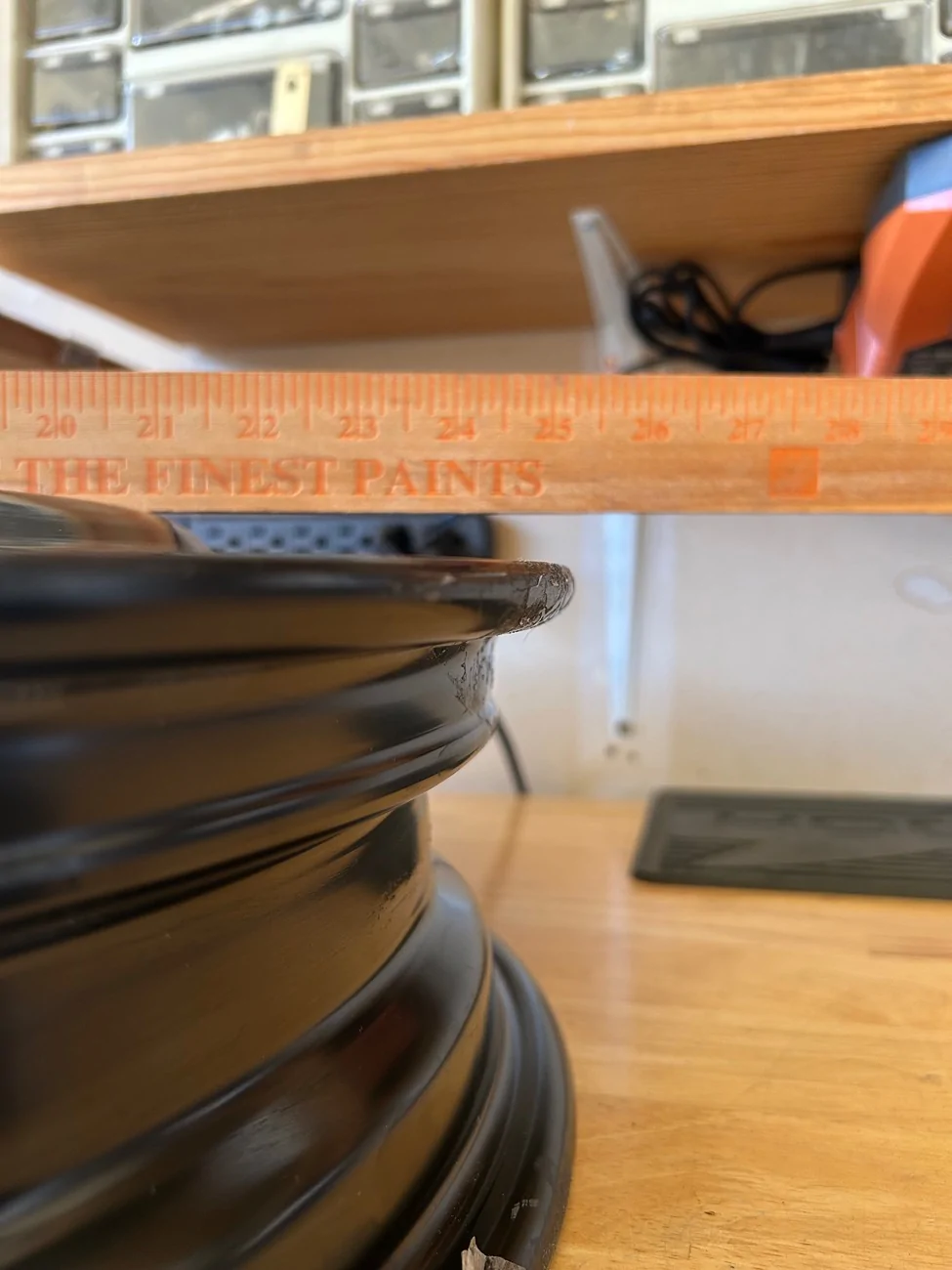

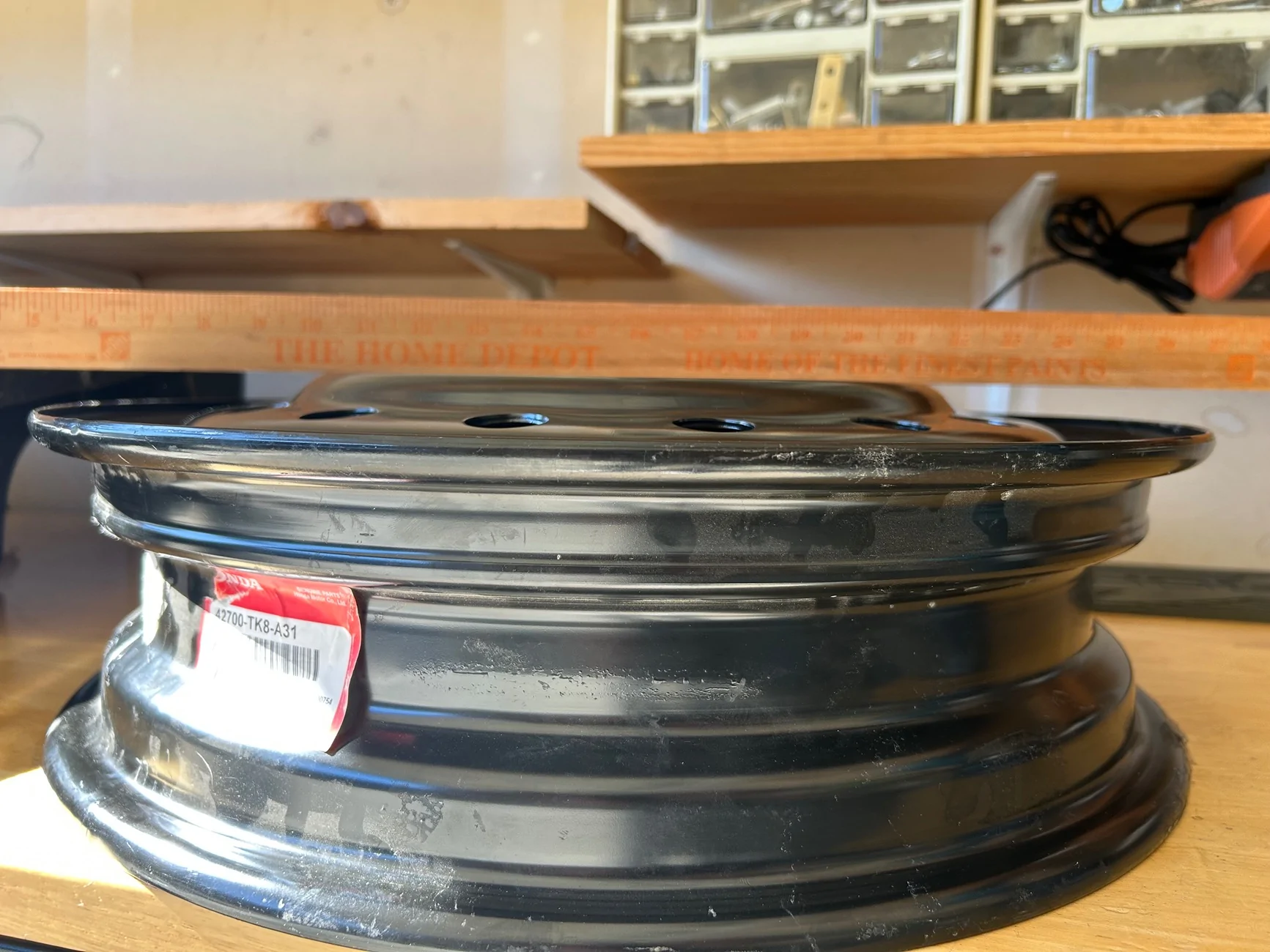

Putting together a spare tire.
I ordered this Honda Odyssey spare (42700-TK8-A31) and plan to mount a T135/80 17 tire.
However, I thought the cover would sit perfectly flat based on what I read on other forums, but no luck.
I wonder if anyone is using the 42700-TYA-A51 and if so, does it allow the top cover to sit flat?
Specifically, curious if the offset / ring of the MDX spare would be any lower profile?
Apparently, I forgot to get a picture of the wheel inside the trunk.
Acura Integra A Spare Tire That Fits Under the Load Floor IMG_1735
Acura Integra A Spare Tire That Fits Under the Load Floor IMG_1736

I don't think anything fits perfectly flat except the BMW wheel with the 17" tire, but the bulge may be minimal with this rim. The problem is Honda/Acura made the trunk pan shallower for the Type-S. We need a spare 18" wheel with a tire that doesn't exist. Everything we come up with is a compromise either in space, lug nuts, and/or only works on the rear wheels.
cavalier35
James
Jun 10, 2026
Portland, OR
2026 Integra Type S Urban Gray Pearl
thank you. I read someone pushed the tire down a bit and bent the wheel well downward a bit. Not sure it’s true, but I may have to live with it.
just wanted to make sure the MDX wheel wasn’t the better option. Sounds like it has the same profile
