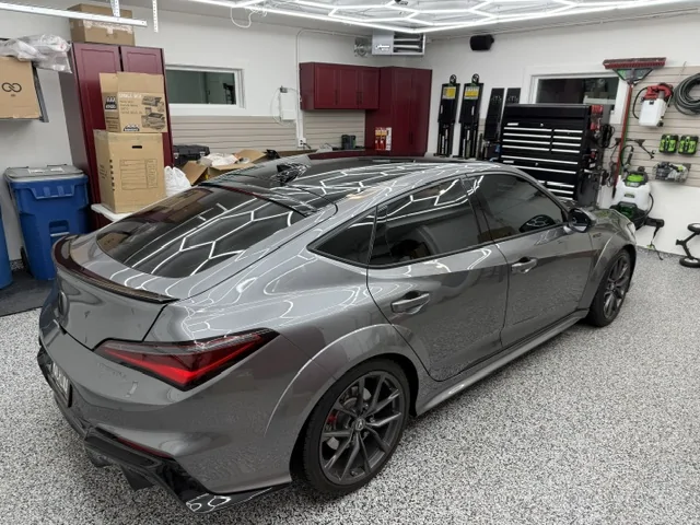

Hey folks!
I've been on here since purchasing the car in October of 2025. I've been stockpiling parts for a build, ultimately my goal was a weekend/track car. This is my first build of a vehicle; I never had the money or time in my past for it. I've put a lot into the car since then, it's definitely a blast to drive and I'm looking to get it out on the track to get seat time. The community and vendors that I've worked with have had some pretty amazing input and advice during the installation and purchasing of parts for this car, I worked with a professional shop to have them installed, and now I just need to dial in things such as suspension and I'm open to suggestions for any additions, subtractions or advice for taking this to the next level. I've made some mistakes along the way, poor wheel sizing for track and just being a noob at this in general.
My first mods (will add interior photos and dyno when I get a chance)
First Installed Parts-Interior/Exterior

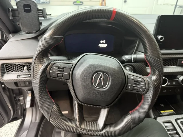

  • Acuity Stage 4 Performance Shifter
  • TTDcraft Custom Dry Carbon Steering Wheel with Black perforated leather and red stitching
  • Mugen Leather Shift knob in black with red stitching
  • Custom Leather Shift Boot - Black with red stitching
  • Mugen window visors
  • Jogon Interior Dry Carbon Trim
  • Full Body PPF and Ceramic
  • Ceramic Tint (20% sides and Rear, 50% front)
  • Front and Rear Dash Cams
  • Homelink Mirror
  • OEM Splashguards
  • Tuxmats Front/Rear and Hatch
  • OEM Rear seat protectors
Before:
Acura Integra Einherjar310's "Machina" Build - Liquid Carbon Metallic {filename}
Acura Integra Einherjar310's "Machina" Build - Liquid Carbon Metallic IMG_0751
Shop Installed Parts:

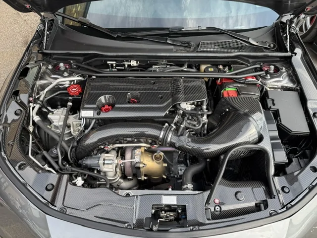

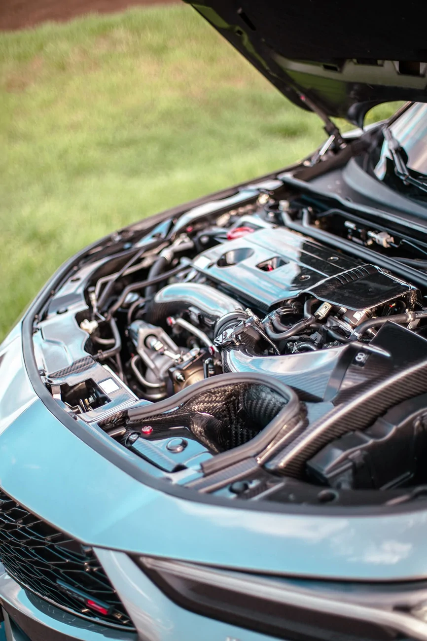

Engine, Forced Induction & Intake
  • 27Won Turbo - Kuro+
  • Infinity Design Carbon Intake
  • Infinity Design Carbon Inlet Pipe
  • HPS Performance Intercooler Charge Pipe
  • WOT/HPT Intercooler
  • Kompact Supersonic Blow Off Valve
Fuel System & Tuning Engine Management
  • Hondata Fuel System (with 1530cc Injectors)
  • DeatschWerks 430lph DW430C Compact Fuel Pump (LPFP)
  • Hondata Canflex
  • Hondata ECU Flash and Tune by Lurk Tuning in Minnesota
    • 93 octane - 350whp
    • E40 - 508whp
Exhaust System
  • 27Won Downpipe
  • 27Won Valved Exhaust
Cooling Systems
  • WOT Performance Triple Pass Radiator + Trans Cooler
  • WOT Performance Dual Oil Cooler Kit
  • 27Won Coolant Tank
  • WOT Cooling Plate
  • APR Radiator Cooling Plates
Suspension & Chassis Rigidity
  • RS-R Best-i Active Coilover Kit
  • RS-R Front Pillowball Upper Mounts
  • DSC Controller
  • RV6 Rear Lower A (Camber) Control Arms
  • RV6 Lower B (Toe) Control Arms
  • Whiteline 22mm Rear Sway Bar (with 2022 Brackets + Accord End Links)
  • Spoon Rigid Collars (Front and Rear)
  • Wunderladen Rear Motor Mount (RMM)
  • 27Won Front Strut Bar with Master brake cylinder brace
Brakes
  • Paragon 2-piece Slotted Front Rotors
  • Paragon P3 Front Brake Pads
  • Paragon 350mm Rear Rotors
  • Paragon P3 Rear Brake Pads
  • Wunderladen Rear Brake Caliper Bushings
  • HEL Braided Brake Lines

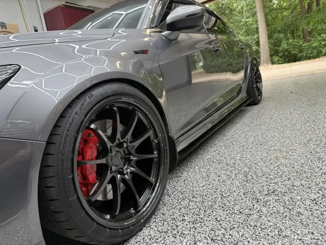

Wheels, Tires & Exterior Aero
  • 19x10 Volk CE28n plus m-spec wheels wrapped in 285/30 Continental ECS02
  • Artwork Bodyshop Aero Kit with V2 spoiler
Acura Integra Einherjar310's "Machina" Build - Liquid Carbon Metallic 692d4682653e644ed7942f60613568d8
Acura Integra Einherjar310's "Machina" Build - Liquid Carbon Metallic d23635c0bf952cfcbf120200f539d2dd
Acura Integra Einherjar310's "Machina" Build - Liquid Carbon Metallic 7b155706876f2e102c26a318387ab866
Acura Integra Einherjar310's "Machina" Build - Liquid Carbon Metallic IMG_0945

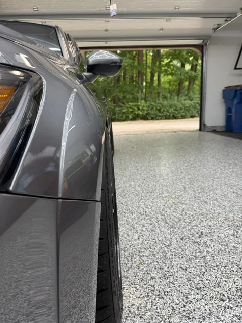

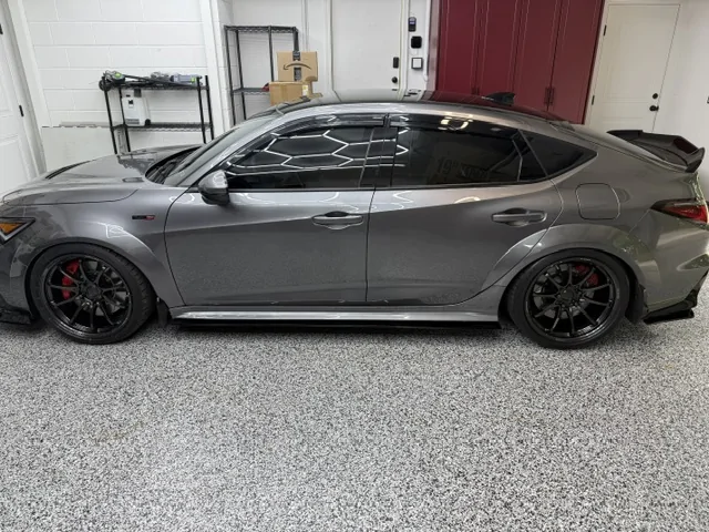

Latest Additions: New wheels listed above - need to adjust the ride height in the rear.
Acura Integra Einherjar310's "Machina" Build - Liquid Carbon Metallic IMG_1186
Acura Integra Einherjar310's "Machina" Build - Liquid Carbon Metallic IMG_1185
Acura Integra Einherjar310's "Machina" Build - Liquid Carbon Metallic IMG_1187
A video the shop made when dyno tuning the build - pretty cool touch
Looking forward to talking shop!

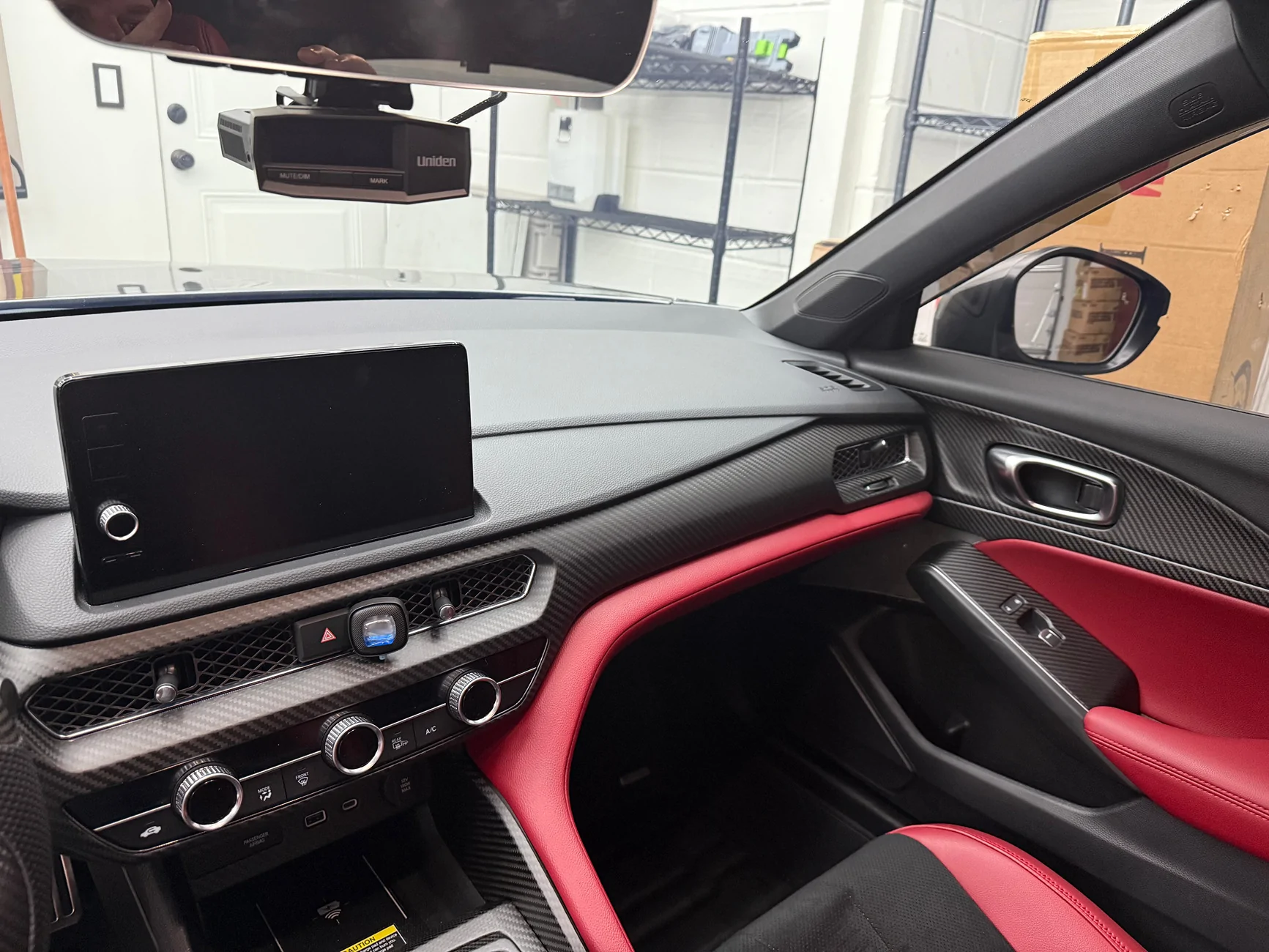

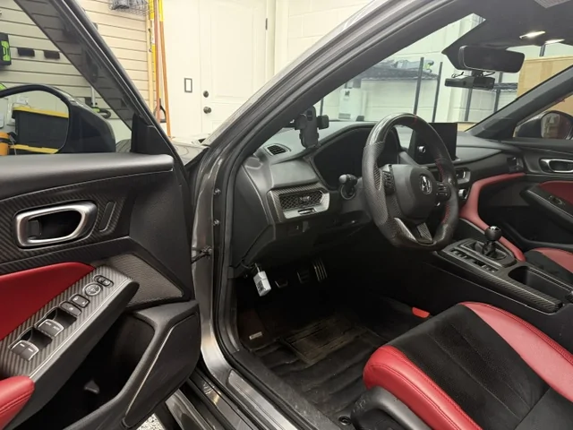

Interior:

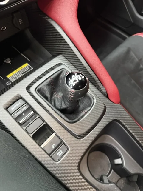

Oh you know what. May you plz share an interior pic with the shift knob? I got that same one for my nephew when he got his 9th gen si coupe and been wanting to possibly get one too
thnx if U can.

I would also like to see interior pics šŸ™‚

First time seeing someone with the God Spec Ce28s in 19s šŸ”„ . How much camber are you running?
In the earlier photos I was running 19x10.5 Apex's but just got the CE28's in, I'll need to confirm my camber; I think it was 1.5 to 2, but I should have updated numbers once I get things dialed in.

how do you like the knob vs the OEM one? I’m afraid I’m gonna miss the size of the OEM one
I have both a Skunk2 weighted shift knob and the Mugen one. I prefer the feel of the Mugen and think it matches the interior better. The knob feels a little bigger in my hand, but the Skunk2 seems heavier and is an easier throw. I am running the shifter a bit tight, and it has no play whatsoever, so I enjoy the crisp shifting where it's at now.
Thnx for the info! Now I gotta look at the skunk 2 knob….
