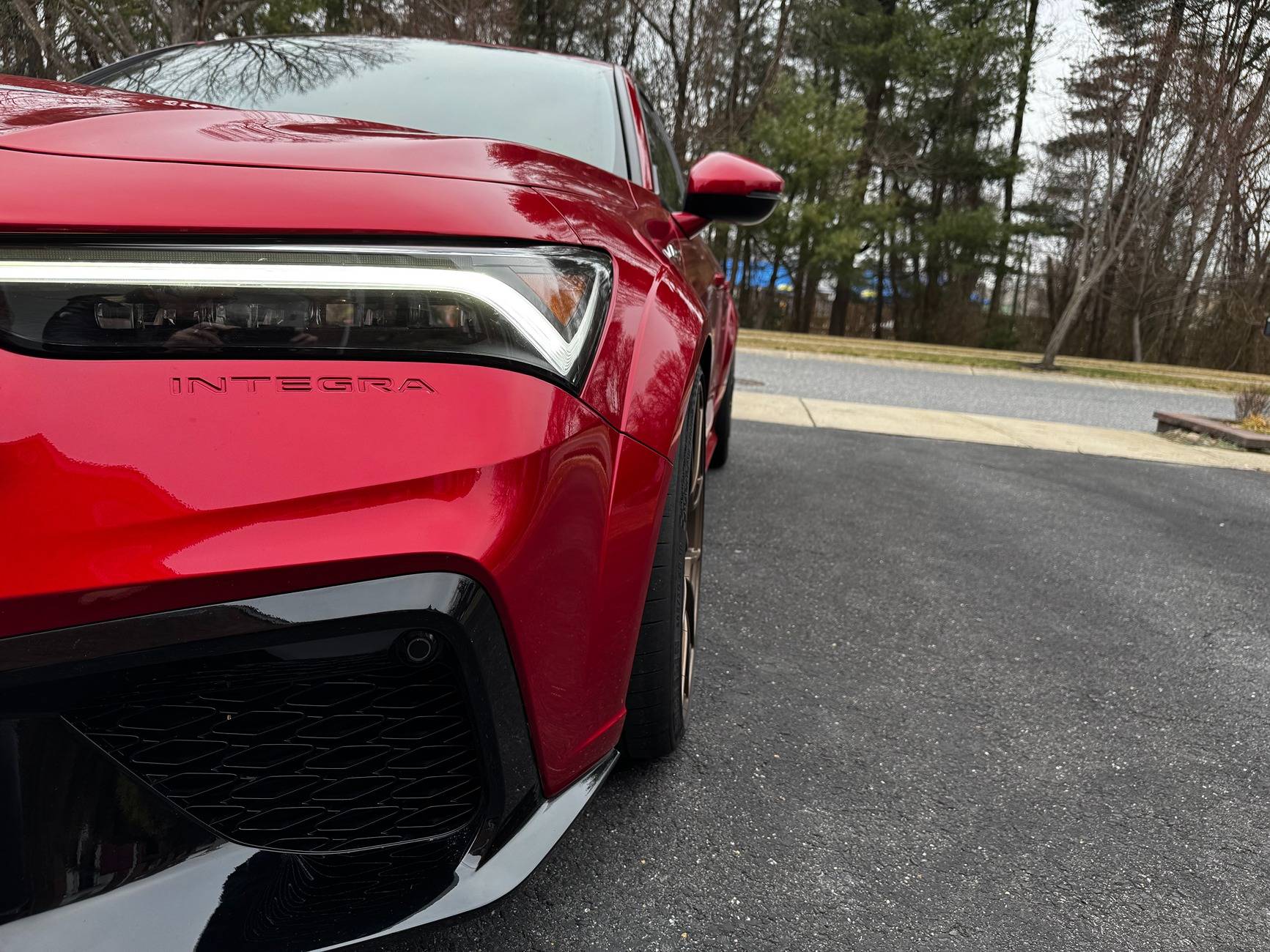

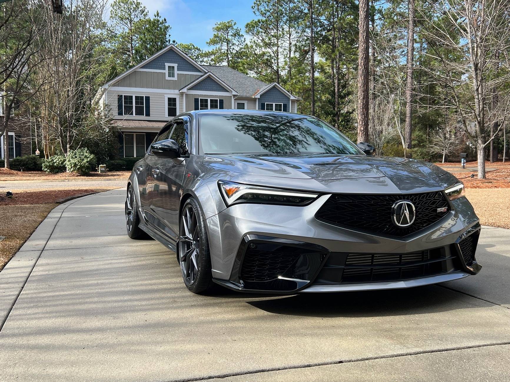

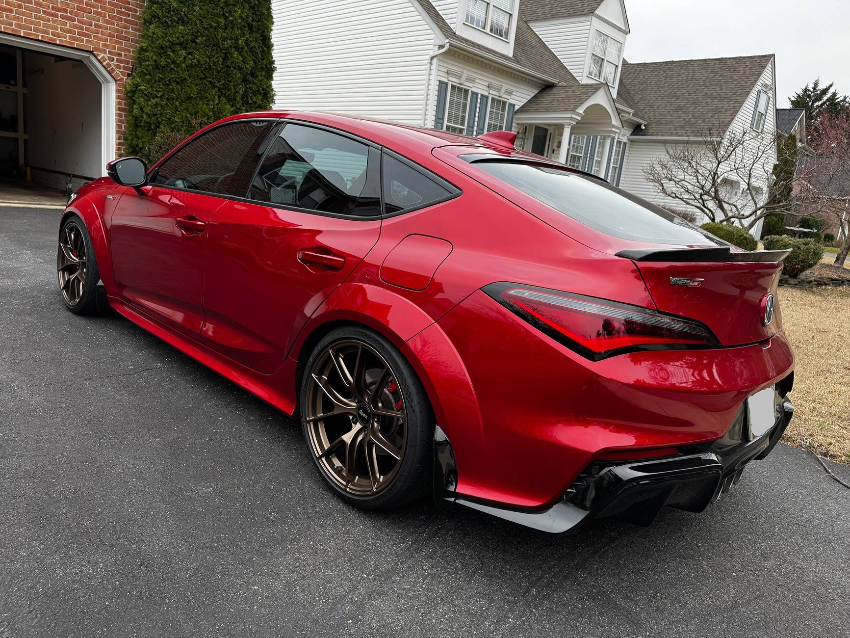

I don't have a picture that truly does it justice - I need one that shows the full front of the car from a bit of distance to show how menacing it looks with the front camber- but hopefully this helps. I have the same Apex VS-5RS in 19 x 9.5 +45, just satin bronze. Also on Eibach Pro-kit, with -3.5 camber in the front.
The car looks great with this setup. Do they make camber plates for the integra? Seems like that'd be easier than doing ball joints, but maybe not. Im excited to get into it, but im biding my time for two reasons;

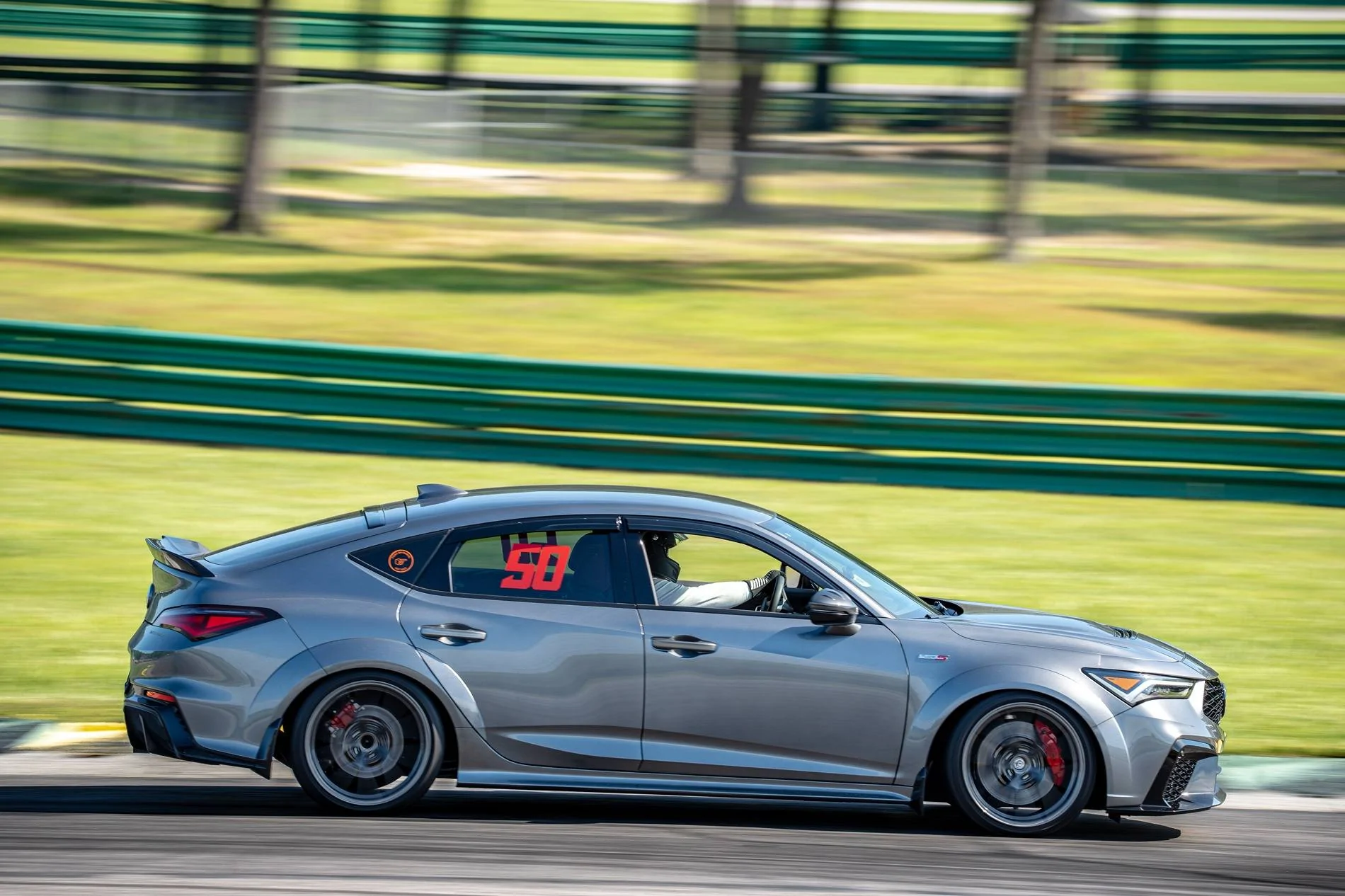

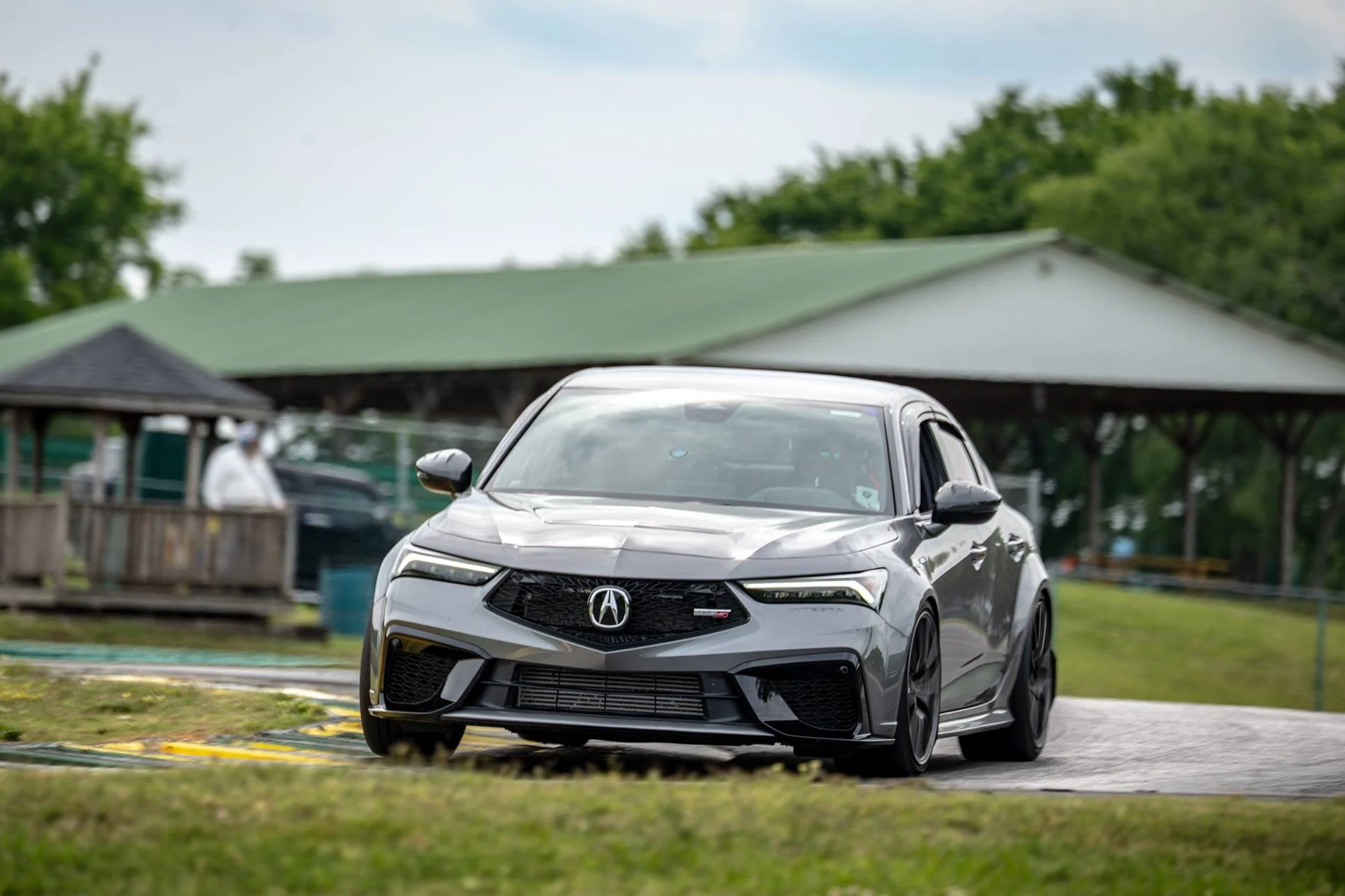

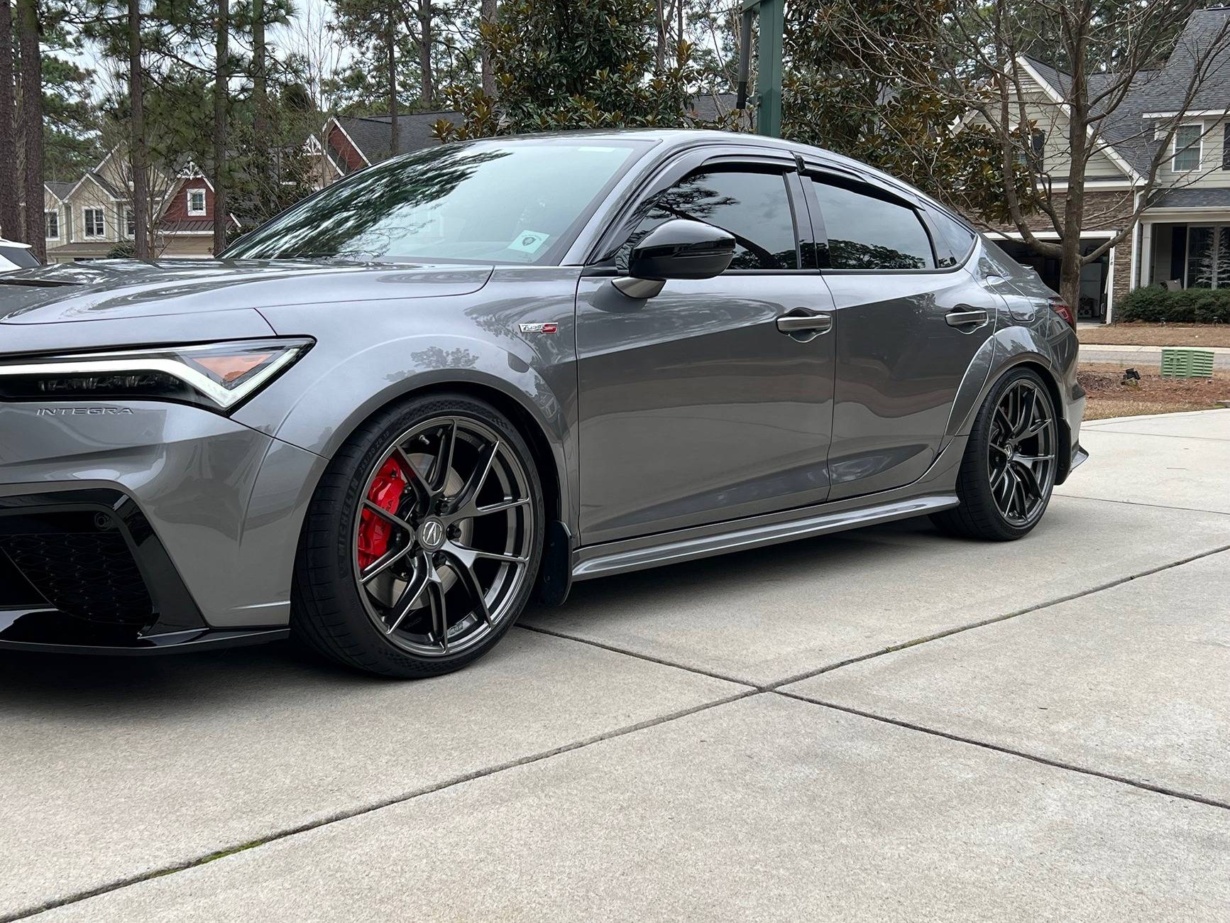

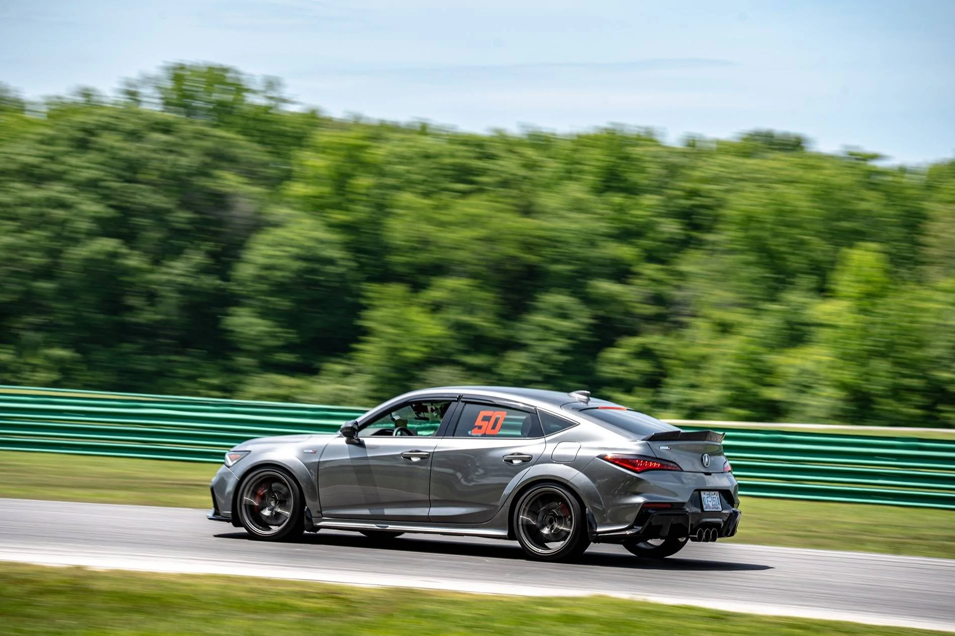

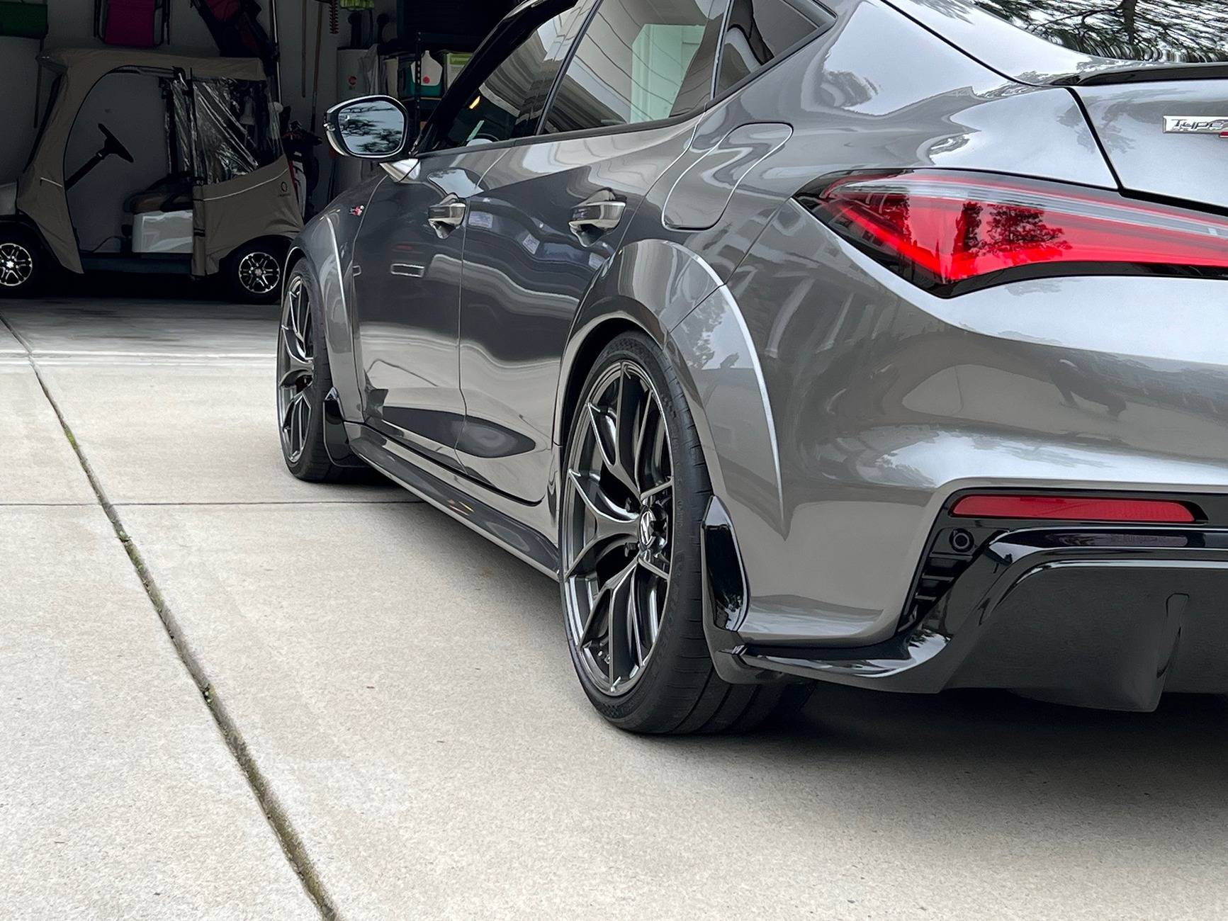

Pics: 19 x 9.5, + 45 offset. 275/30. Lowered on Eibach Pro kit. Apex VS-5RS. Looks amazing on this car IMO.
It's aggressive looking, but not crazy. A couple pics are on the track with the 275/30's.
A couple pics have the stock tires or are on stock rims with 15mm spacers, so still effectively a +45 offset.
I think this is the perfect fitment.

That's funny, because it was that exact picture of @StingertimeNC's car that convinced me to get Apex VS-5RS as well.
However now I'm in a position where I'm trying to figure out if I'm keeping them or not, because I just bought a set of 18" CE28Ns last week... ideally I'd like to keep both because a) I still love the look of the 19" Apex and b) I think I prefer the OEM Michelins on the street to a 200TW tire that I would use mostly for track stuff.
Right now I have space and don't need the money but let's see how long I can hold out...
