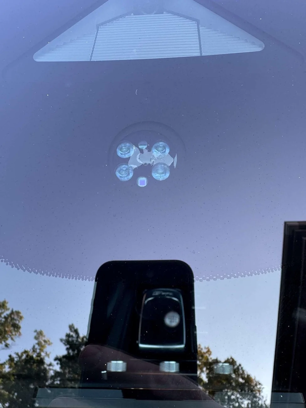

I just had my windshield replaced with OEM glass (shoutout to NJM insurance for approving it in like 30 seconds). Safelite did the replacement and calibration and my road test says everything appears to be functioning as it's supposed to but I noticed this in the sensor area. It looks like some kind of very thin something or other that shouldn't be in that area and certainly wasn't on the cracked windshield. Should I be concerned?

Looks like an air bubble. Give it some time to settle (a week max). You can leave the car in the sun or use a heat gun to try and hurry it up.
If it doesn't go away they didn't do a good enough job of sealing it up and they should redo it (safelite is hard to fight on their install quality ime, though)

Is there glass on top of or enclosing that sensor assembly that is right underneath the windshield glass? Or is the sensor assembly area a 'hole'
I thought about trapped air but it looks kind of multi segmented, like somebody slopped a blob or two of something in there.

No it's bonded. The sensor housing itself is open and a strong sealant is used to adhere it to the glass. This is also why windshield replacements require an alignment check and levelset for the sensor.
