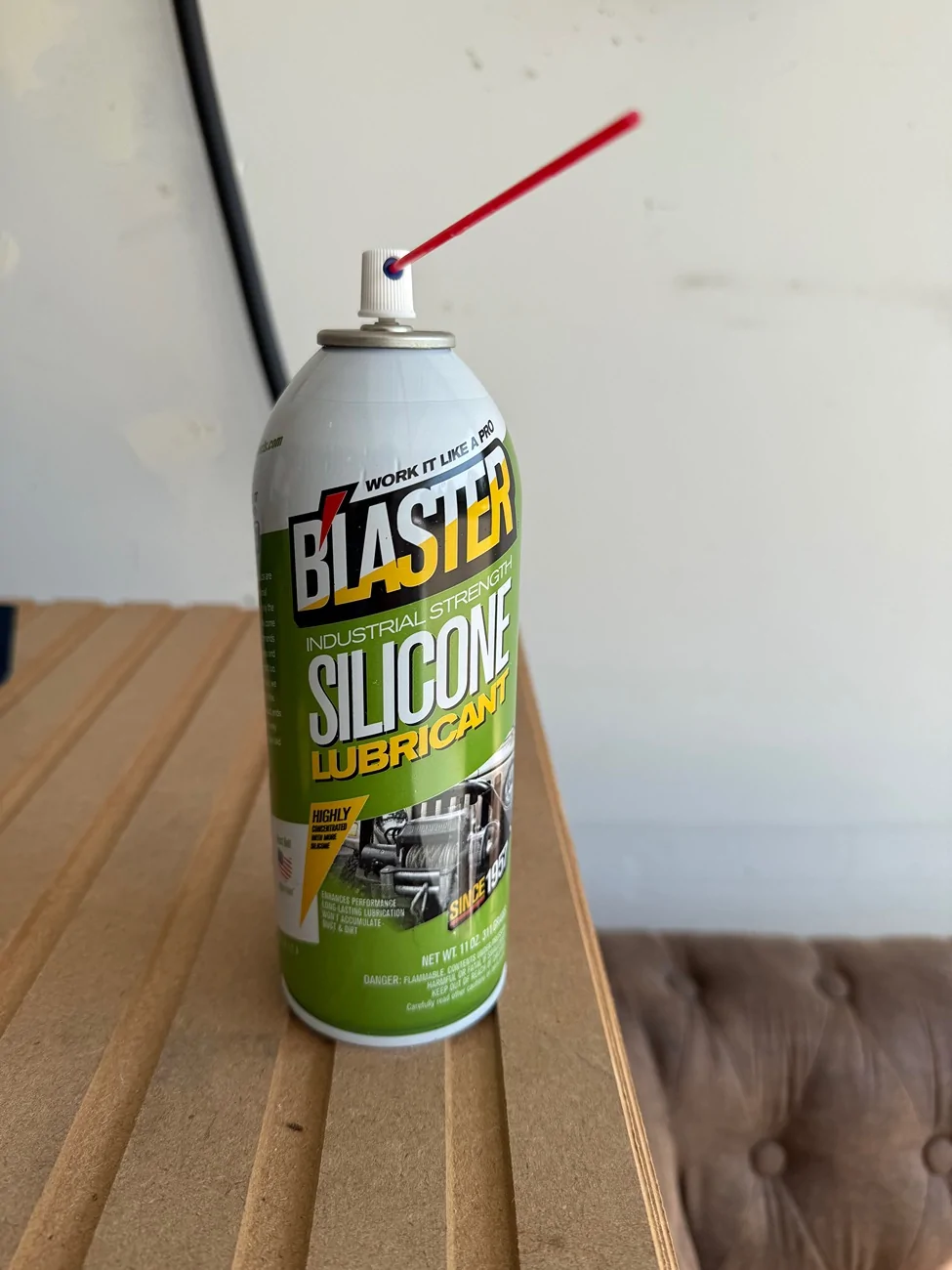

I started to notice the passenger side window roll up way slower than the drivers side. It may be due to when the car was tinted and may have flushed the grease with their soapy solution. I used a little amount of blaster silicon lubricant inside the channels and let it run down naturally.
Acura Integra Windows rolling up slowly (may be after tints) IMG_2501
After rolling the windows up and down a few times they now open and close almost at the same time. Hopefully this quick fix also helps others. I’m guessing any multipurpose silucon lubricant can work.
