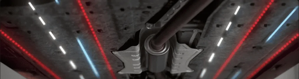

2024 Acura Integra Type-S
I wonder what areas you could apply it w/ the underside enclosure.
