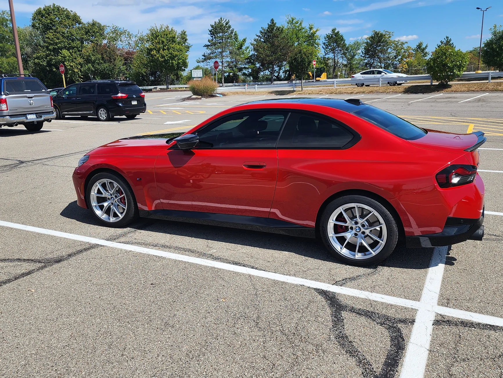

You can call Apex wheels. I know they have a BMW specialist and I would hope they have an Acura specialist. Here are 18 inch VS-5RS on my BMW. My ITS will get the same wheel. Same brushed
Acura Integra Type S wheel option 20250910_124705
aluminum.
