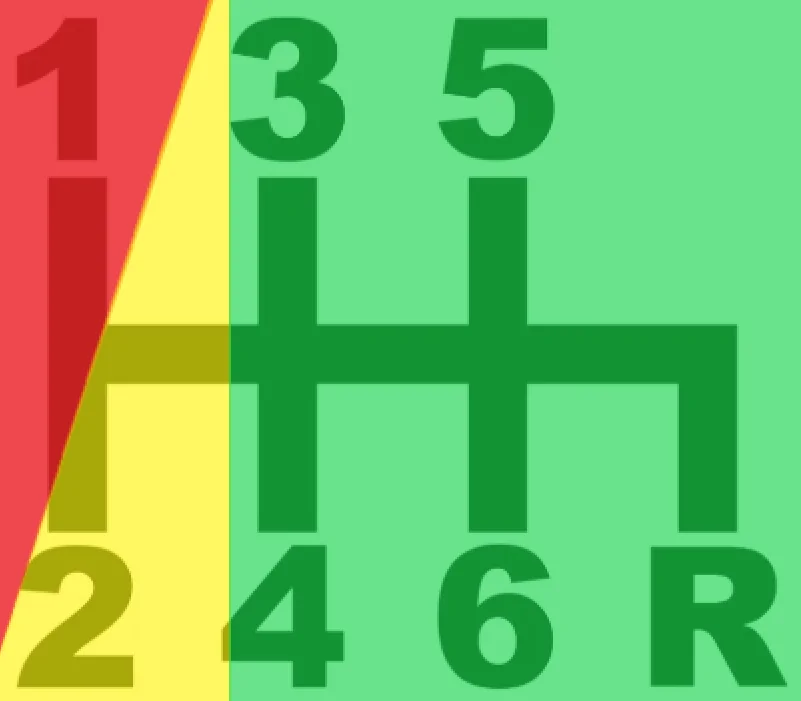

I got in my car this morning and started driving like normal. Everything felt completely fine. After about 20 minutes on the interstate, I exited and slowed to make a turn. When I went to shift, the shifter did NOT want to move to the left.
I had no issues going straight up into 3rd, 4th, 5th, or 6th, but the shifter would not move left to engage 1st or 2nd. I was able to get the car moving in 3rd and pulled into a gas station. I pulled up the shifter trim to check for obstructions or anything obviously broken, but nothing looked damaged or out of place. The shifter just physically would not move left.
I noticed the small amount it would move left was enough to pull it down into 2nd, so I drove like that. After another ~20 minutes of driving, I stopped at a light and tried again — suddenly there was no resistance at all. I could get into 1st normally like nothing ever happened.
I parked the car for about an hour, came back, and drove again — zero issues. I then drove a few more hours with multiple stops — still perfect. Later I sat in school pickup for about 30 minutes creeping forward (neutral → 1st → neutral → 1st repeatedly) and it never acted up again.
Below is the best way I can illustrate how it felt:
(Green = normal, Yellow = high resistance, Red = basically impossible)
Acura Integra Type-S Intermittent Shifter Issue Screenshot 2026-01-29 215304
From what I’ve read so far, my only real guess is the Gate Select Shift Cable was binding, and then once it was fullllllllly warmed up whatever was binding relaxed and went back to normal.
