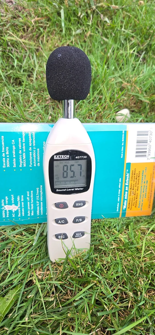

Wanted to share some sound clips of my exhaust setup for anyone looking to do something similar. As the title says, I have the TSP Hibiki valved exhaust with resonator, TSP high flow downpipe and 27Won front pipe.
This is what I used to record sound levels:
Acura Integra TSP Hibiki Exhaust, TSP Downpipe, and 27Won Front Pipe Sound Clips - 1.5T 6MT 1000005092
Revving with valves closed. Max dB: 80.5
Revving with valves open. Max dB: 85.7
