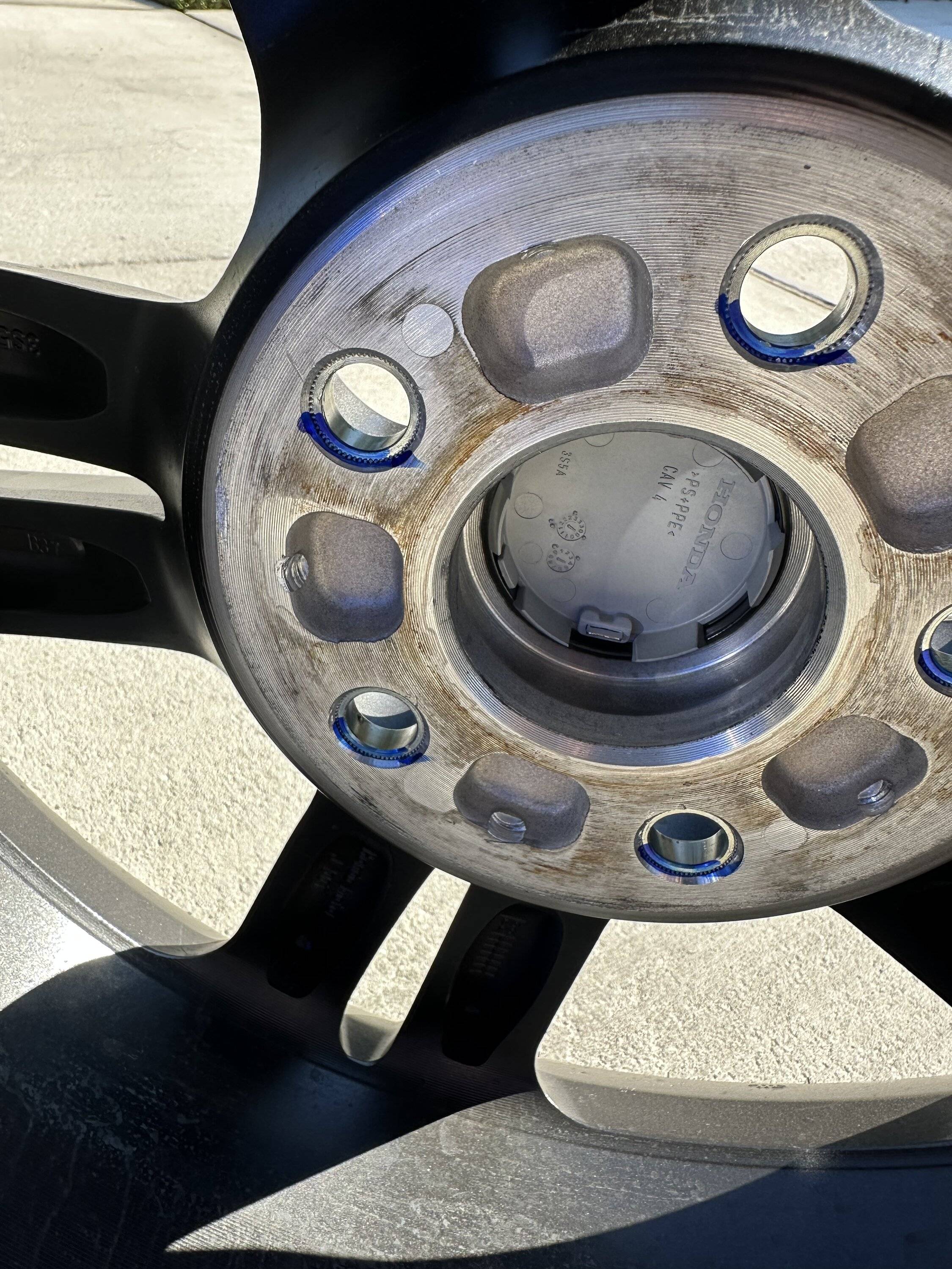

Factory lugs are a bit too long even for 20mm spacers. Notice the "notch" behind the wheel
Hmmm... I wonder what the play is then for spacers on stock wheels. Maybe just dremel out little notches in each wheel? Would prefer to not have lugs contacting the wheel like that and cutting the stock lugs would be more of a pain.

They’re on now so too late for that. I have small notches on my wheels. No big deal.
Looks much better and drive the same. I don’t regret it one bit
25mm would most likely clear but tire would stick ou a little
