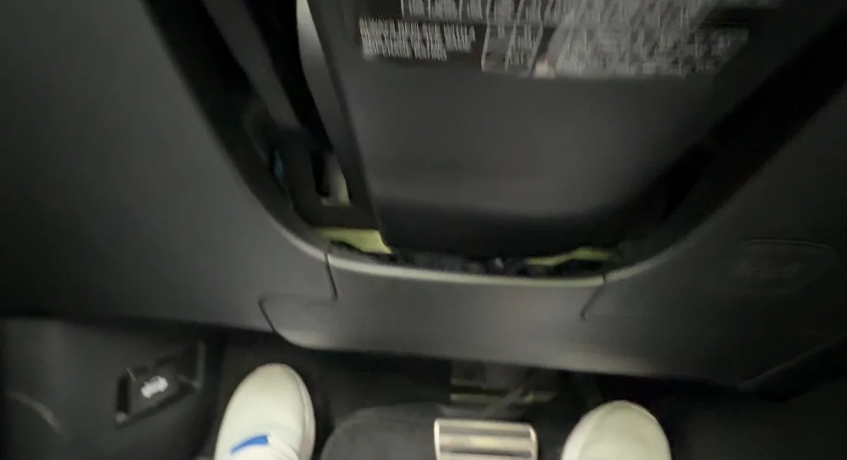

Hi, I have been noticing a rattling noise in my 2023 Integra coming from the plastic trim underneath the steering column. When I press down on the trim, the noise stops. Any idea what is causing this noise and what I can do to solve this rattle?

There are a ton of rattles in these cars. If you're pressing a panel and it stops, start by taking that panel off and putting felt tape in the mounting areas and any contact points you suspect are at play.
I've fixed about a dozen rattles the dealer couldn't pinpoint and almost all of them were just poor tolerance between plastic mounting tabs.
