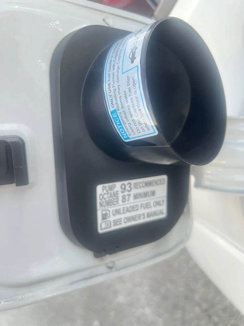

It does list 87 - 93 octane on the gas cap lid shown above. I realize to avoid 87 if all possible. I was just thinking of having a soare bottle or two of an additive laying around my place in case of a future jam during storm season.

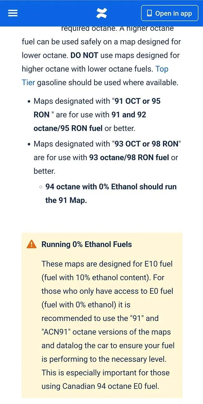

Any vehicle made after the mid 2000s is designed to run on a ratio of ethanol. Turbo cars especially like knock resistance more than burn quantity, so they seem more stable on ethanol fuels. It's not uncommon to see people blending in more e for an e30 mix on stock tunes, in some cars making more power with less heat and cleaner burn. I've also seen tuners advertise that if running a 93/4 ethanol free blend to instead run 91 maps (screenshot attached).
Personally, in my sti in the past I saw a loss of roughly 5-6% on the dyno when initially running 93 eth free, then refueling with 93 +10% (and driving 50mi to get the ecu to readjust) brought power back to normal.
