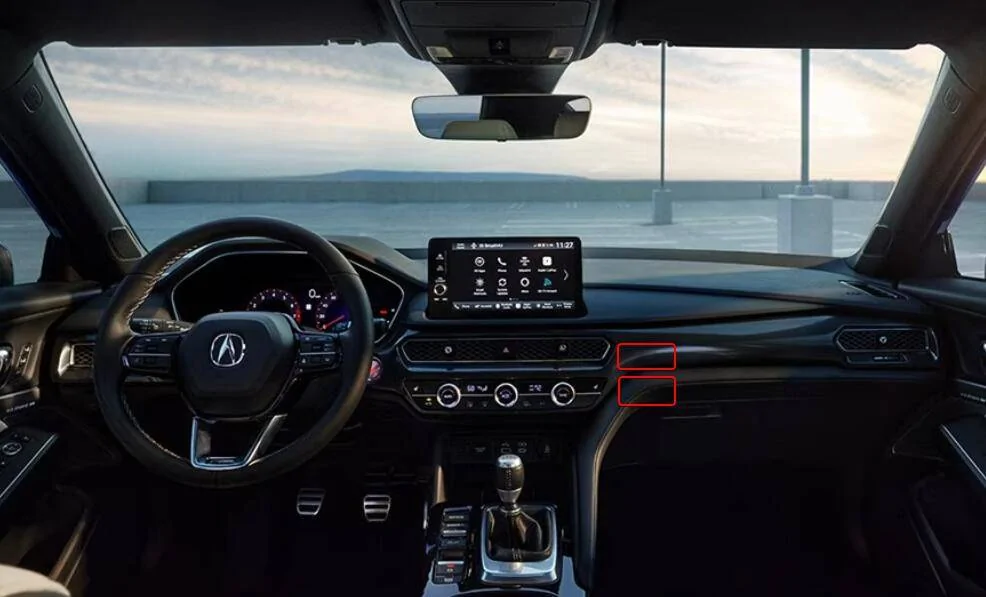

Since then, I've experienced an intermittent rattle and/or tick noise from the dash. It doesn't always happen, but when it does, it usually persists. When my wife is the passenger, she hears it too, but describes it as a "rubbing" noise, which I don't understand, because we are clearly hearing the same noise at the same times, but hear it entirely different.
If my wife puts her hand on the front piece of the dash (the one that looks like it's leather-wrapped) and applies just a small amount of pressure, the noise usually relents. The same tactic can also be done on the piece above it (the plastic piece that looks like carbon-fiber, but isn't, and entails the vents and climate controls), around the same area, and there too the noise usually stops.
The two areas I've squared in red are where applying pressure seems to mitigate the sound.
Acura Integra Passenger Side Rattle From Dash Area 1752952602858-0

I had a brutal plastic-on-plastic rubbing/binding/rattling sound from day one, which sounded like it was coming from the passenger door or glovebox. I took a bunch of stuff apart, lined pieces with felt, and no joy.
Randomly, I determined that opening the glove box and placing sideways pressure on the open bin (pushing it towards the passenger side) would eliminate the noise. So I removed the glove box bin completely for a week, but still had the noise. Then I worked my way down and removed the lower trim panel under the dash in the passenger footwell (it has the footwell light in it). That was the source, either the panel itself or something else it was rubbing on. Other than losing the footwell light, there is really no reason to have that panel, so I never reinstalled it. I have a feeling it will take a lot of trial and error tinkering to figure out exactly what was rubbing and making the noise, since that panel touches a bunch of stuff.

Thanks for that. I'll try exploring based on your description and see if I can't prove that out. Appreciate the response.

Im having this exact same issue. My gf helped me track it down, and its definitely between that footwell ceiling panel and the left foot panel on the passenger side. Haven't dove into it yet, but when I do, ill try to remember to update this thread.
To the OP, when you remove that trim piece youre pushing on, does it still rattle? The best thing to do to troubleshoot is to remove panels one by one, and then test drive it with someone. If it still rattles, just continue pushing/holding stuff until it stops, and repeat until you find the culprit. I've had multiple dashes out, and finding rattles (and more importantly, preventing them when going back together) can be difficult. Keep us updated. Good luck!
