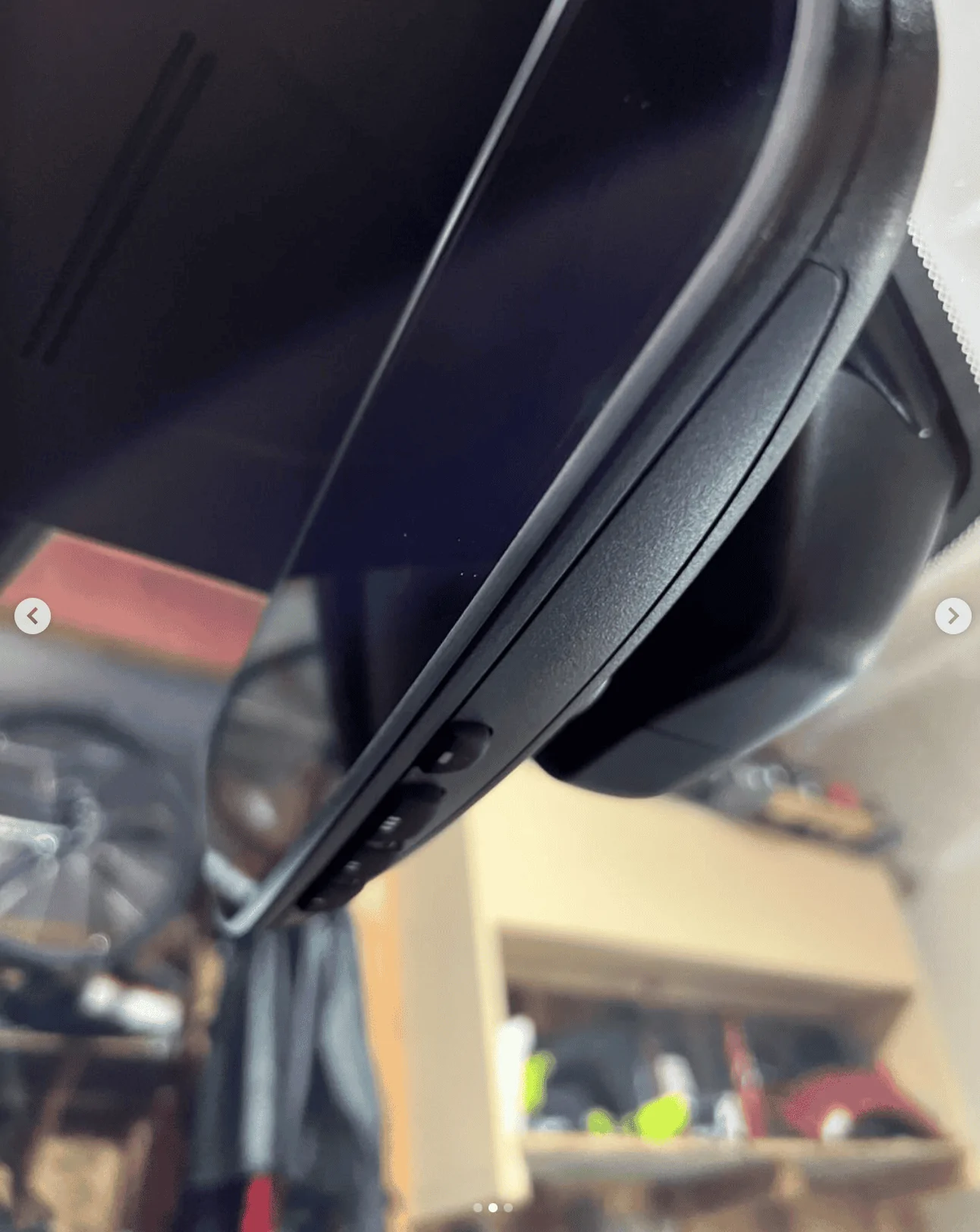

BTW The 2018-2022 Accord mirror may be "plug in play" but you still need to splice the yellow wire to red.
i64X
Jason
Feb 29, 2024
34
57
MI, US
2024 Integra Type S, 2022 Mazda MX-5 RF GT
It is not plug and play. You need to split both mirrors apart to swap over the stalk from your integra to the Accord mirror then re-assemble. While you have it apart you can easily splice the yellow wire to the red, or if you wanted the mirror to be like factory you could run a wire to tap into the fuse box that gets constant power (yellow wire). I went the easy route and spliced and as others have said its better as your car needs to be on for the garage door opener to work. With patience and all the parts on a kitchen table the job can be done between 45 minutes and 4 hours, depending on your experience with these things. I took about 2 - 1/2 hours to do mine, the 2nd one I do i bet i can get it done in 46 minutes. Check out the "Retrofit Honda Civic Dimming Mirror w/ Homelink" thead, this link is where I left my comments and photos I took: https://www.integraforums.com/forum...ng-mirror-w-homelink.50656/page-2#post-850329 Accord 2023+ mirror is exactly the same style as our factory mirror plus the homelink buttons. part number 08V03-3A0-100
Thanks for all of the info, and info in that other thread. I just ordered one of these. This will make a fun project.

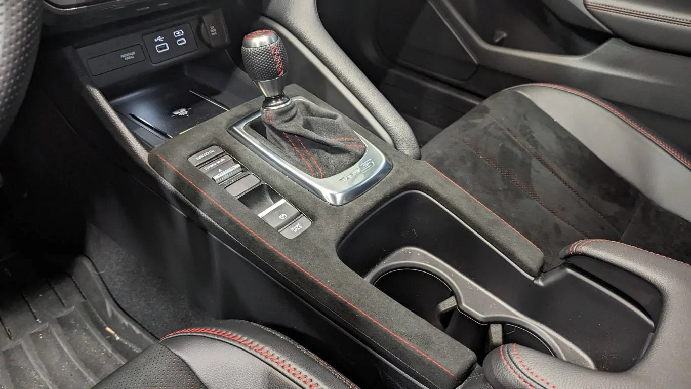

Last week I installed the Overland Designs covered shift bezel, looks way better than the piano black bezel. I shipped it Easter weekend, they got it covered and shipped back by that following Thursday. Insanely fast turn around, very pleased.
Installation is simple, removing the shift knob is the only somewhat difficult step but you should learn how to do this if you plan on doing any serious mods to your car. There is a wire clip underneath also, once you get that removed (you need pliers with a good 90 degree bend to release it), swapping over the switches and metal trim bezel is self explanatory.
Acura Integra Opinion and slightly modded Type-S Thread PXL_20240404_233712146_md
I think the car is now at 100% my mind, as far as how the car should have come from the factory. Only thing I complain about is the 2 memory position seat option, that should have been included in this car for this price point.

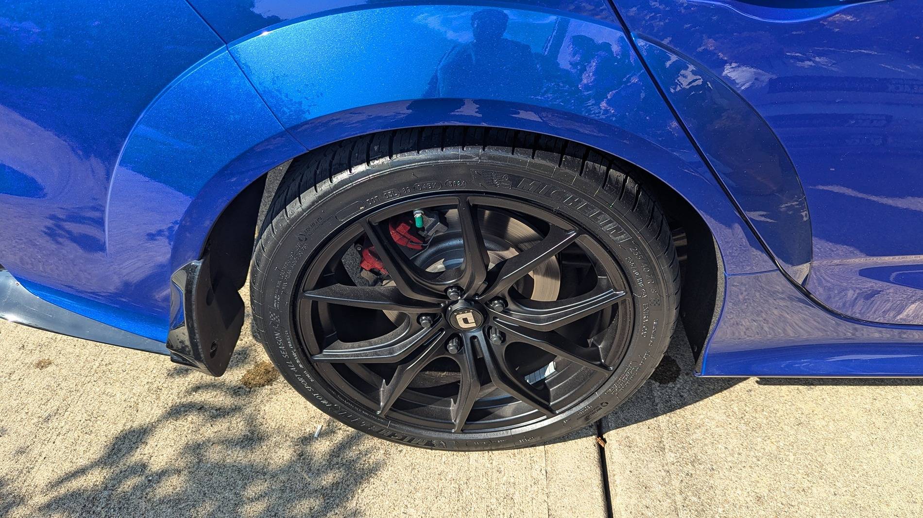

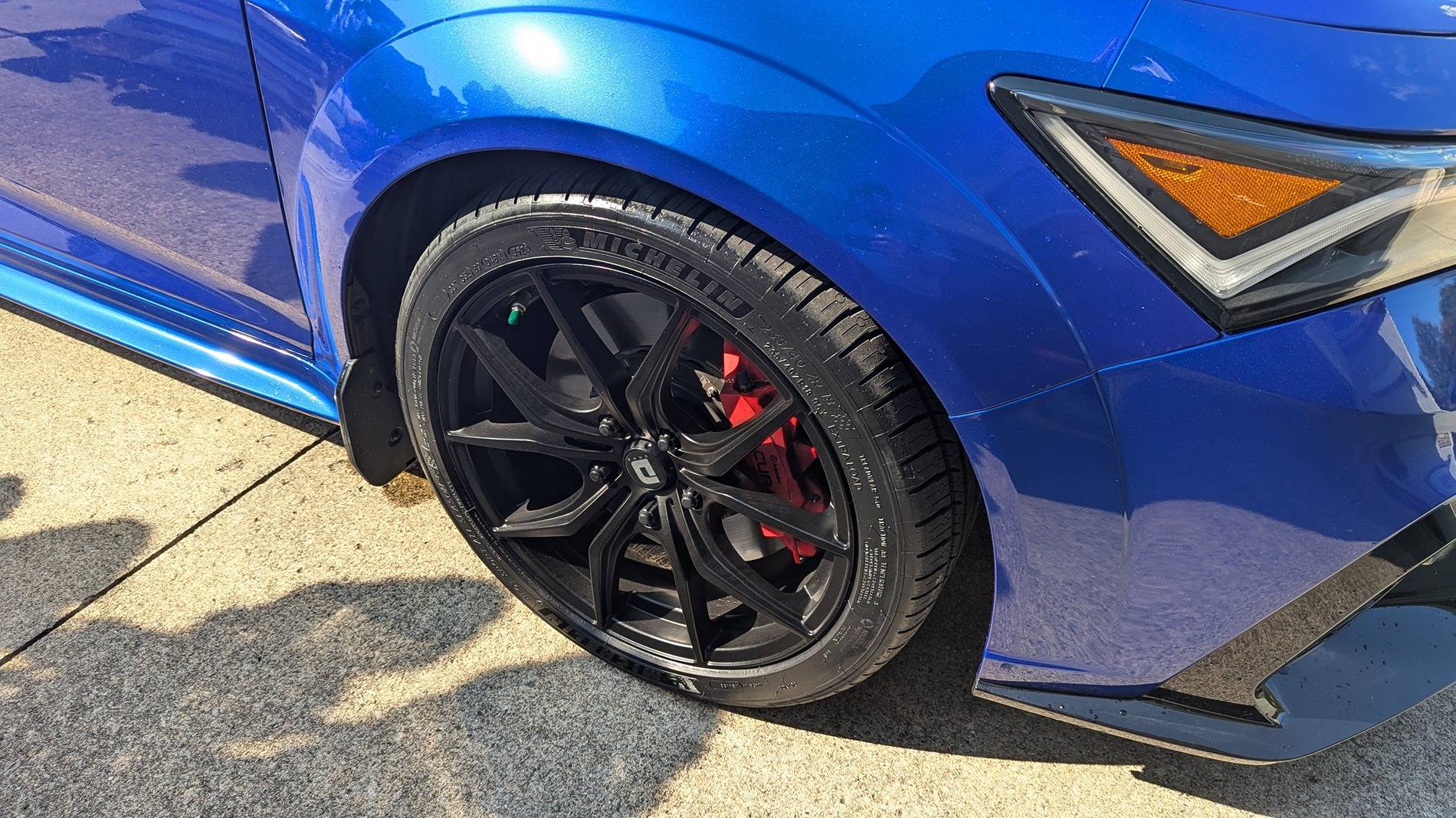

I got winter wheels and tires, I went with Michelin Pilot Sport 4 235/40ZR18 all seasonal 18" tires on Drag DR-67 18x8 5-120 40 Flat Black wheels. Definitely not as good of a tire/wheel package as factory, but it gives me m+s tires for the light snow and below freezing weather we get in central Ohio. I went with Gorilla lug nuts, factory and TPMS sensors. Tired came from Costco, they replaced the factory valve stem covers with their ugly green covers, otherwise they look pretty good.
Acura Integra Opinion and slightly modded Type-S Thread 1000008124
Acura Integra Opinion and slightly modded Type-S Thread 1000008123
