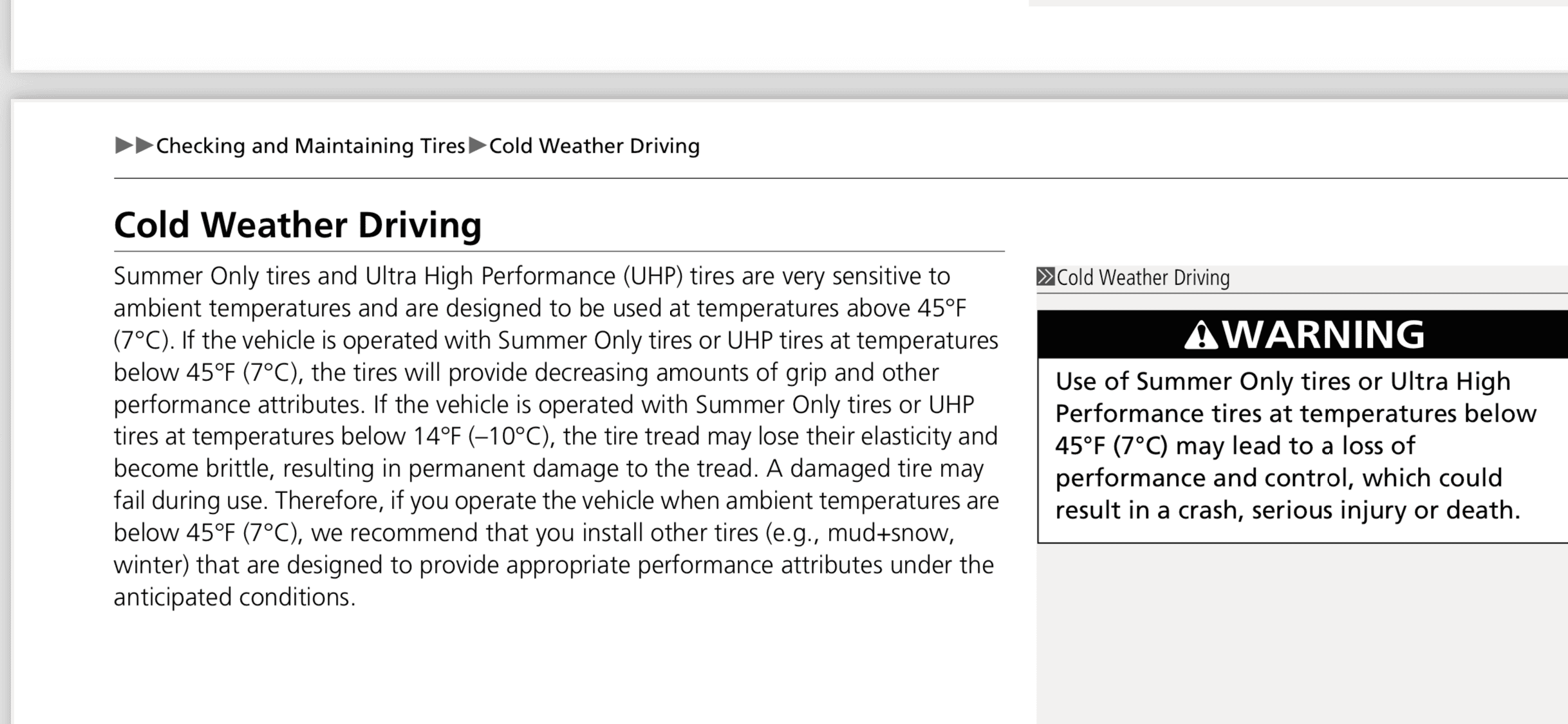

I've been using mine below 45, but.... I leave my garage in the morning, which is in the upper 50s to mid 60s, take it easy the first 5-7 miles and not push it hard in other corners on my way to work. It was noticeable the lack of grip in low 40s, rainy conditions, not hydroplaning but turning grip was low. These are leaps and bounds above the Michelin tires my '95 GS-R came with. Those were absolutely undriveable in wet and cool conditions.
The way home, in 50s to 60, it was fine.
I'll switch to my winter set when consistent cold sets in, I feel it won't be too far away.
