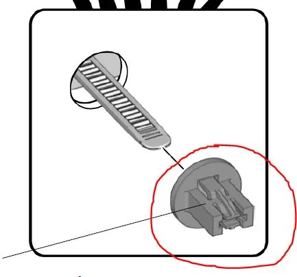

I hit the dreaded carbon fiber resin peeling and in the process of getting the spoiler remove to get it sanded down and clear coated. I'm having trouble removing these zip tie clips without breaking them. Is it possible to remove or is there a way to order a new set if I go through the route of breaking them.

cant be more than a $1-$2. id just break them and order some up.

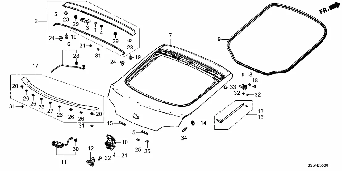

not sure if relevant to the cf spoiler specifically but here is the link that may be able to start your journey.

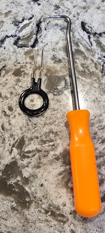

ok, I was able to remove the clips without breaking them. For future reference for anyone, all you really need is a depinning tool and and angle pick. The depinning tool holds one side while you use the pick to flip the other side opening the clip to slide off.
