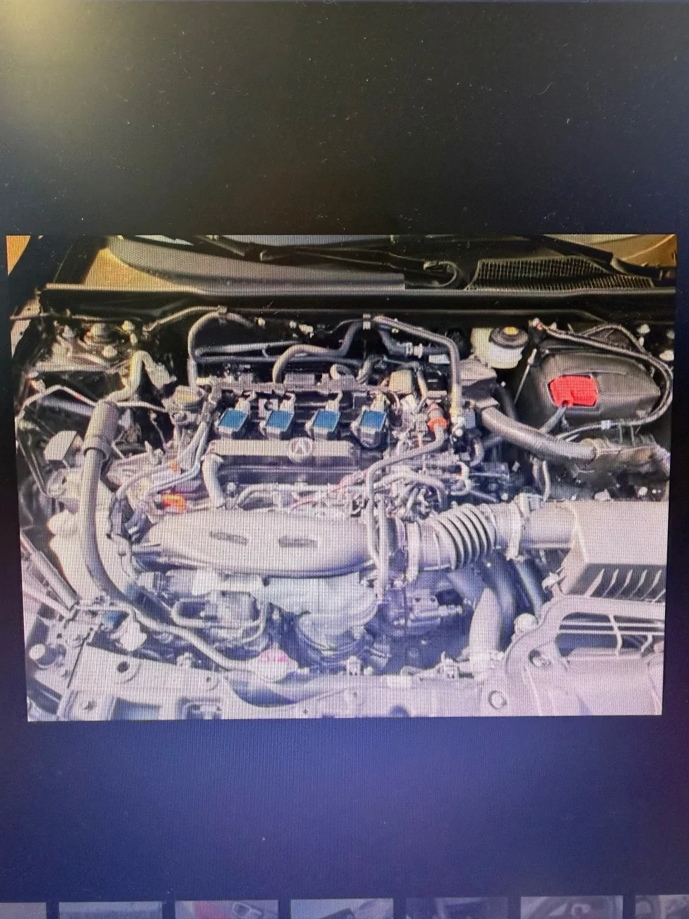

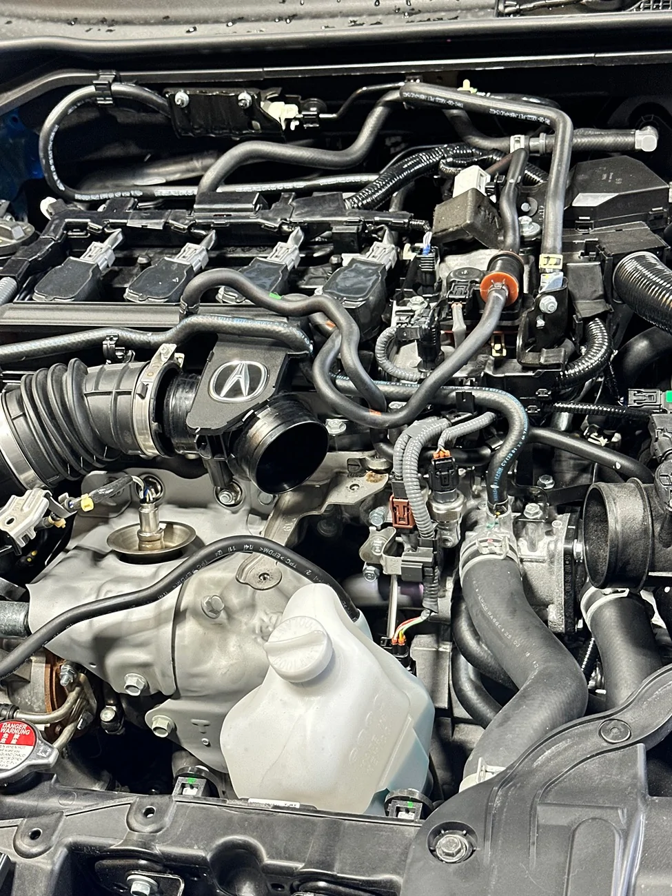

Finally got around to trying to install the turbo inlet pipe and ran into an unexpected issue. It looks like there’s a difference between the 2026 CVT and manual setups that PRL didn’t account for.
This matches the ADX part number, so it makes sense why there was questions on that earlier:
https://www.acurapartswarehouse.com/oem/acura~cover~cyln~head~12310-6vj-a01.html
On my car, that Acura ā€œAā€ breather box is part of the valve cover and tied into the PCV system with a fixed molded outlet. The problem is it sticks right into the path where the PRL inlet pipe needs to sit. On top of that, the O2 sensor and wiring are right there too, so it’s a pretty tight space.
I talked to PRL and this layout was new to them as well, so it seems like the CVT version is packaged a bit differently than the manual cars they designed around.
For now I’m holding off on the install until there’s a better plan, since it’s not just a simple hose reroute — the breather outlet itself is in the way.
