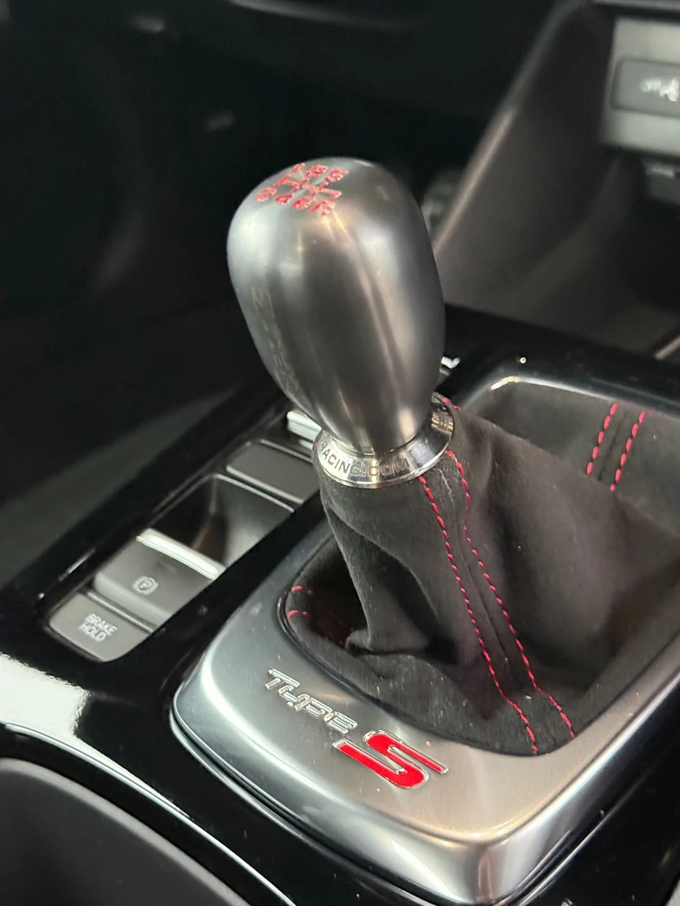

Wish I could offer up some tips, I tried everything even pulling the trim up and clipping the zip tie! I still ended up breaking the collar. On the bright side the new hybrid racing collar looks beautiful.
Wow that does look good
