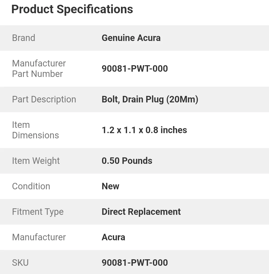

Believe the stock oil drain bolt is not magnetic, but the transmission bolt is.
M14x1.5 for oil
M20x1.5 for transmission (MT)
CVT uses M18x1.5 for transmission
Acura Integra Magnetic Drain Bolts Engine and 6MT Screenshot_20251224_083655_Chrom
