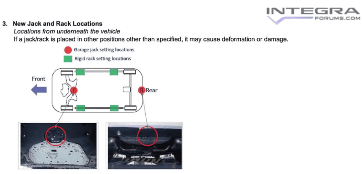

I think they are saying the pinch welds are only for jack stands..
You’re probably right because that’s what the integra type s manual says. Weird that the regular integra says it’s fine to use pinchweld but the type s doesn’t. The post above from seaside rubber says don’t jack up from the pinch welds directly but under that it says if you use a wood block or pad on your jack it’s okay? Seems really weird to me. I saw a few other people here with ITS said they use the pinch welds to jack up the car with no worries. I’ve also seen a bunch of fk8 and fl5 owners use the pinchweld to jack up the car aswell. Weird tbh
Edit: I’ve seen people jack up their cars at the pinchweld at autocross and on YouTube TheTopher jacks up his civic type r by the pinchweld to change his wheel.
3,444
2,933
I think if you get a rubber block that can straddle the pinch weld you would be okay.

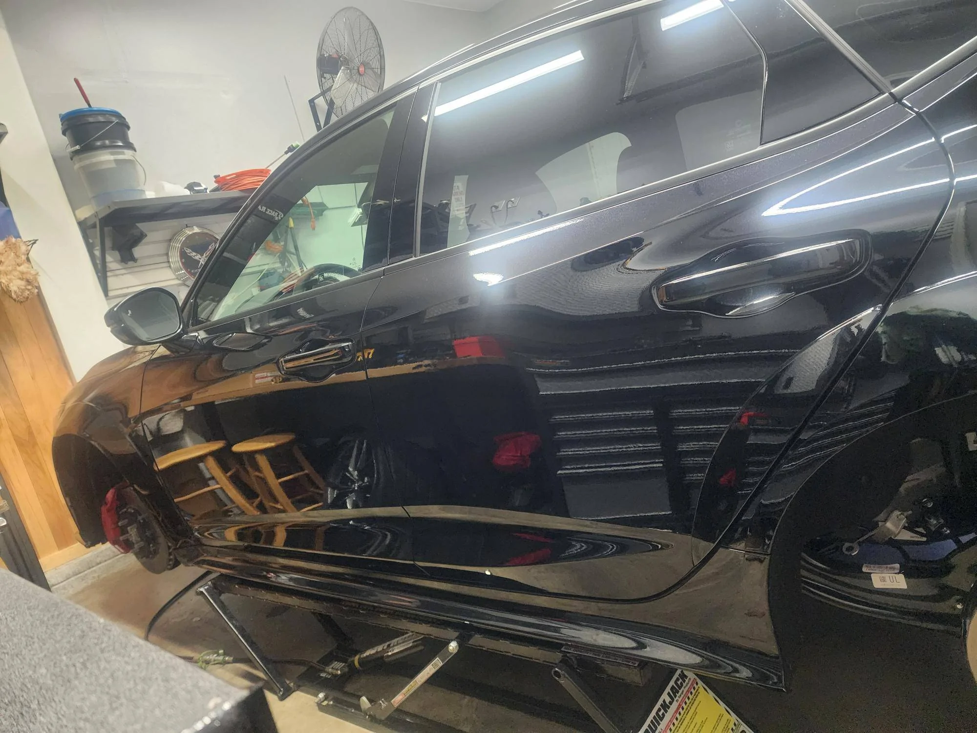

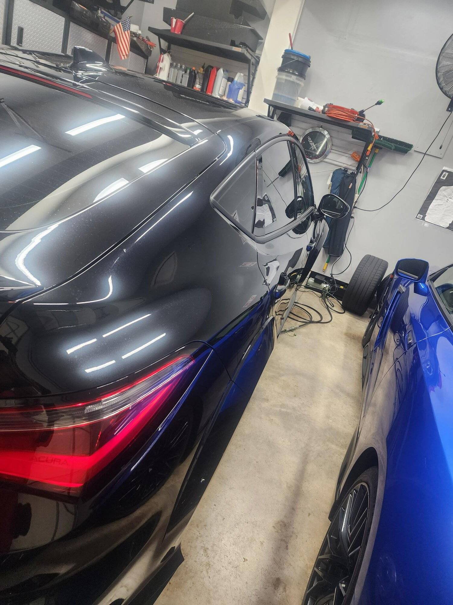

I have had one for years...Its a little sketchy with the ITS the side jacking points are almost maxed out...
Which QuickJack model do you own? I’m interested in purchasing one to store the car on in my garage. I live in a flood-prone area and lost my ā€˜23 A-spec earlier this year to water damage, definitely don’t want a repeat of that with the Type S.
