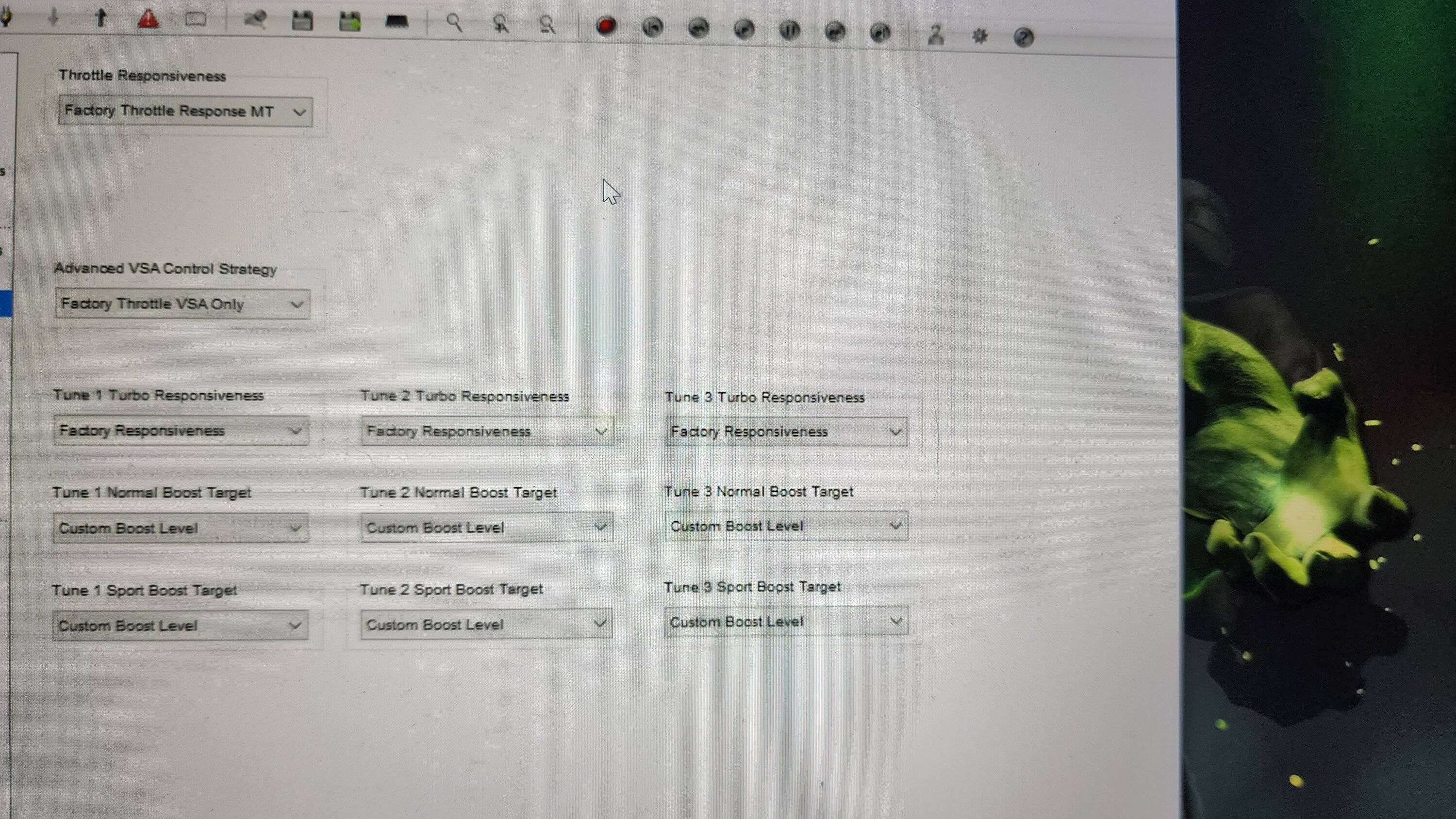

Question on these settings. First did anybody change these or leave them at factory. My question is turbo responsiveness does it mess with longevity of the turbo? And what's the difference between all 3

So I uploaded a new tune. Throttle responsiveness level 1. Normal target 17psi and sport target 19 Psi.
RB2490
Sep 12, 2016
399
299
new york
First impressions 17psi and 19psi Is that there is a more power felt in the higher rpm band. Rpms run out quicker so you have to be quick to shift or you'll bounce of the limiter by time you know it. Throttle level I doesn't really feel that much different in comfort and normal. If anything throttle feels dead in comfort but it may just be that I've been driving in sport for the past week or two and not use to comfort anymore. Sport mode feels like a wrx where the throttle is almost too much . Wife starting getting nauseous. Is there any info on the difference between throttle 1, 2, or 3. Gas mileage also was affected alot where in sport I was only getting 21-22 mpg and I wasn't really driving it hard. That's all city driving and stop and go

Did a few pulls today but it was very humid and hot. Could not get 19psi target but not far off. I notice that in gear 1 and 2 boost won't go high. Stuck at 16.5 -16.6 but once I hit gear 3I see 18psi. Is this by design that 1st and 2nd gear have a lower boost target or is it too hot to reach max boost levels?

If you're starting with one of our included tunes you have access to all limit tables in the software if you want to see how they're setup in the tune. We don't setup boost by gear by default. You can look at a datalog to see what the target was at any given point.

Thanx for the info. I'm really trying to understand everything in the tune. I've always understood tunes but never really understood the tables and etc. Just couldn't figure out why 1st and 2nd won't go past 16.7 but 3rd and 4th will
