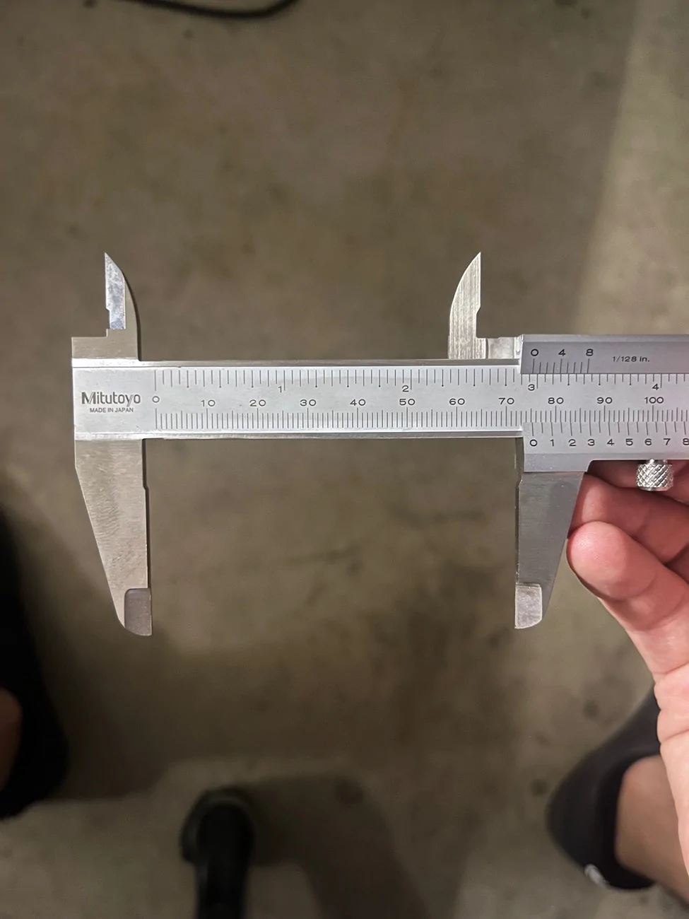

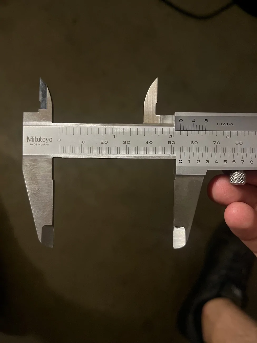

I’m showing 2.25” for the outside and 3” for the center… took these measurements right behind the exhaust tips. The center pipe is 2.5” where it comes out of the muffler, but has a megaphone shaped extension from there to the tip. Please excuse the mess around the last photo, the exhaust sits behind my desk lol

perfect! thanks for measuring!

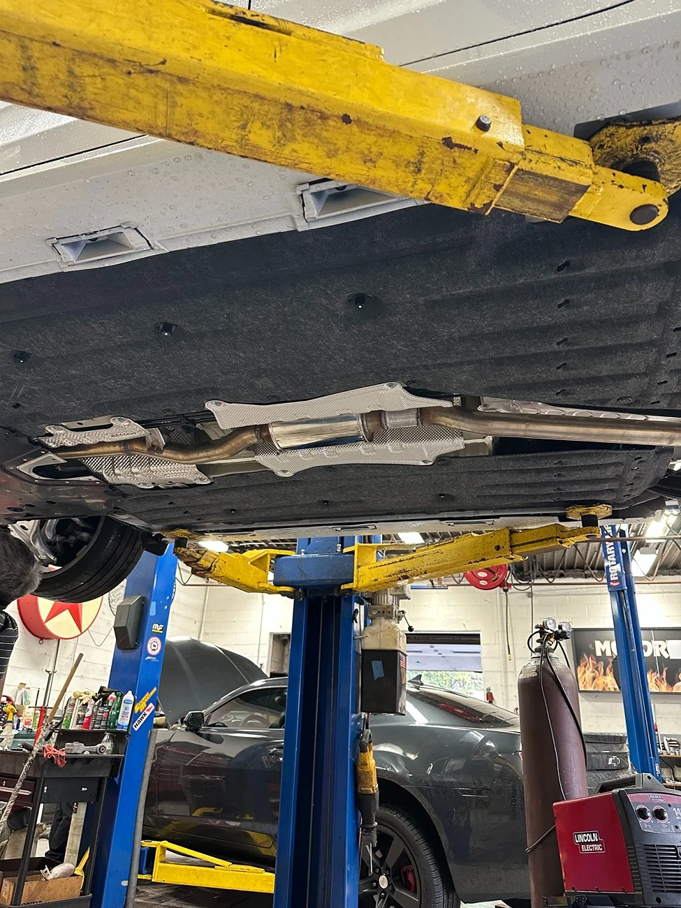

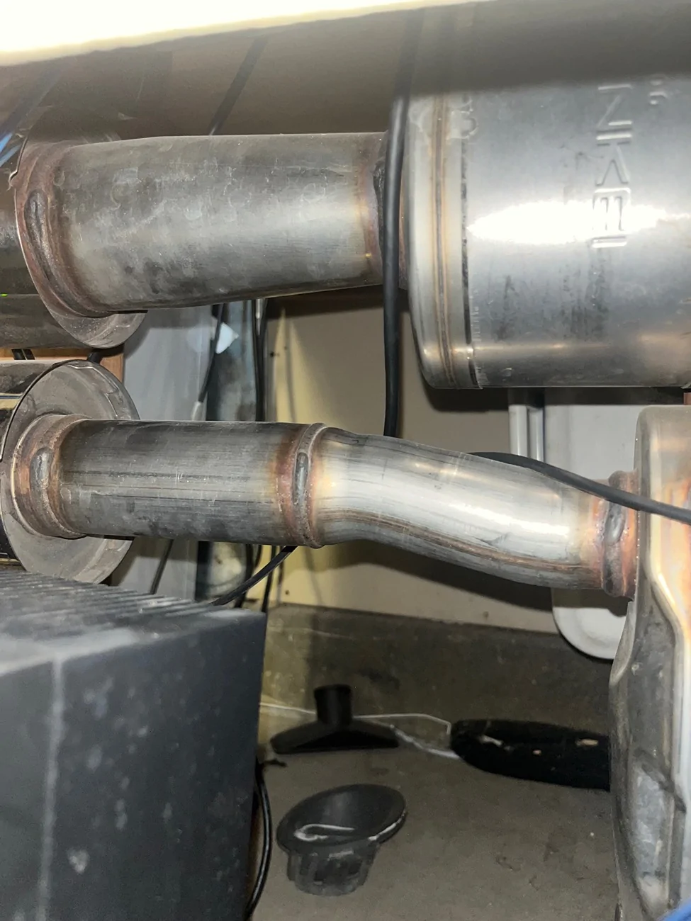

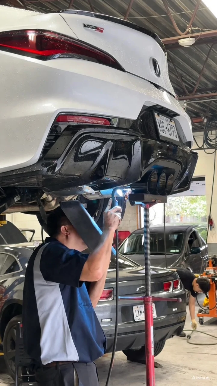

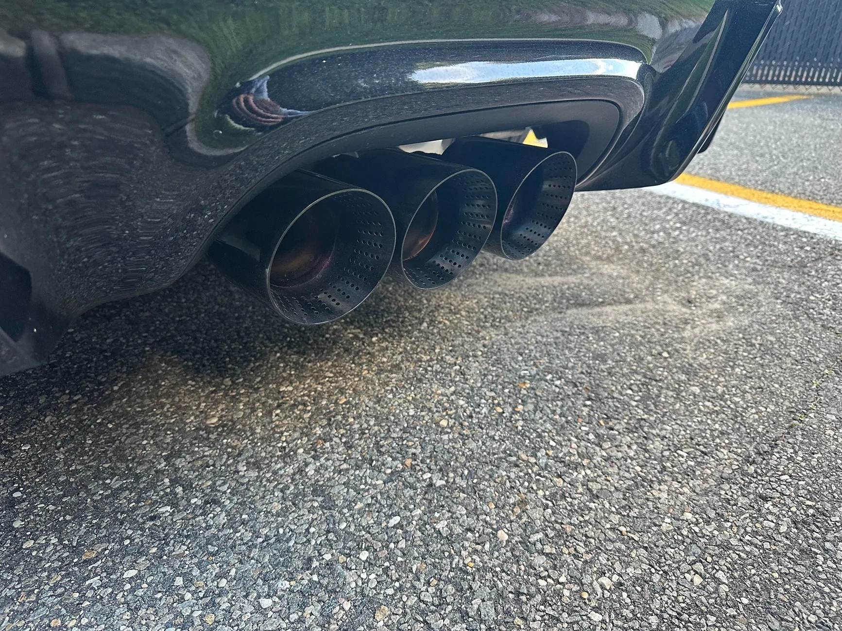

it was raining last weekend so i didnt get a chance to take proper pictures and video of the sounds. here is the resonator swap, I'm using Vibrant ultra quiet 1141 2.5" and then the tips, i got from Ali express black titanium tips (center tip was 77mm to 114M and side tips were 60mm to 114mm). you can technically go smaller for ID because once you cut off the OEM center tip, the pipe is smaller than 3". the great thing is NO DRONE from the resonator swap. it did get slightly louder but not all that noticable.

Here are a few rev’s with my my kids commentary 😂
i swear it sounds very agressive in the car but from outside, it’s actually not that loud at all. I’m surprised as it’s also my first time hearing it outside the car. The pops are louder on upshifts like a gun shot but it’s not obnoxious. I would recommend this setup to anyone not looking to spend 2k for drone.
