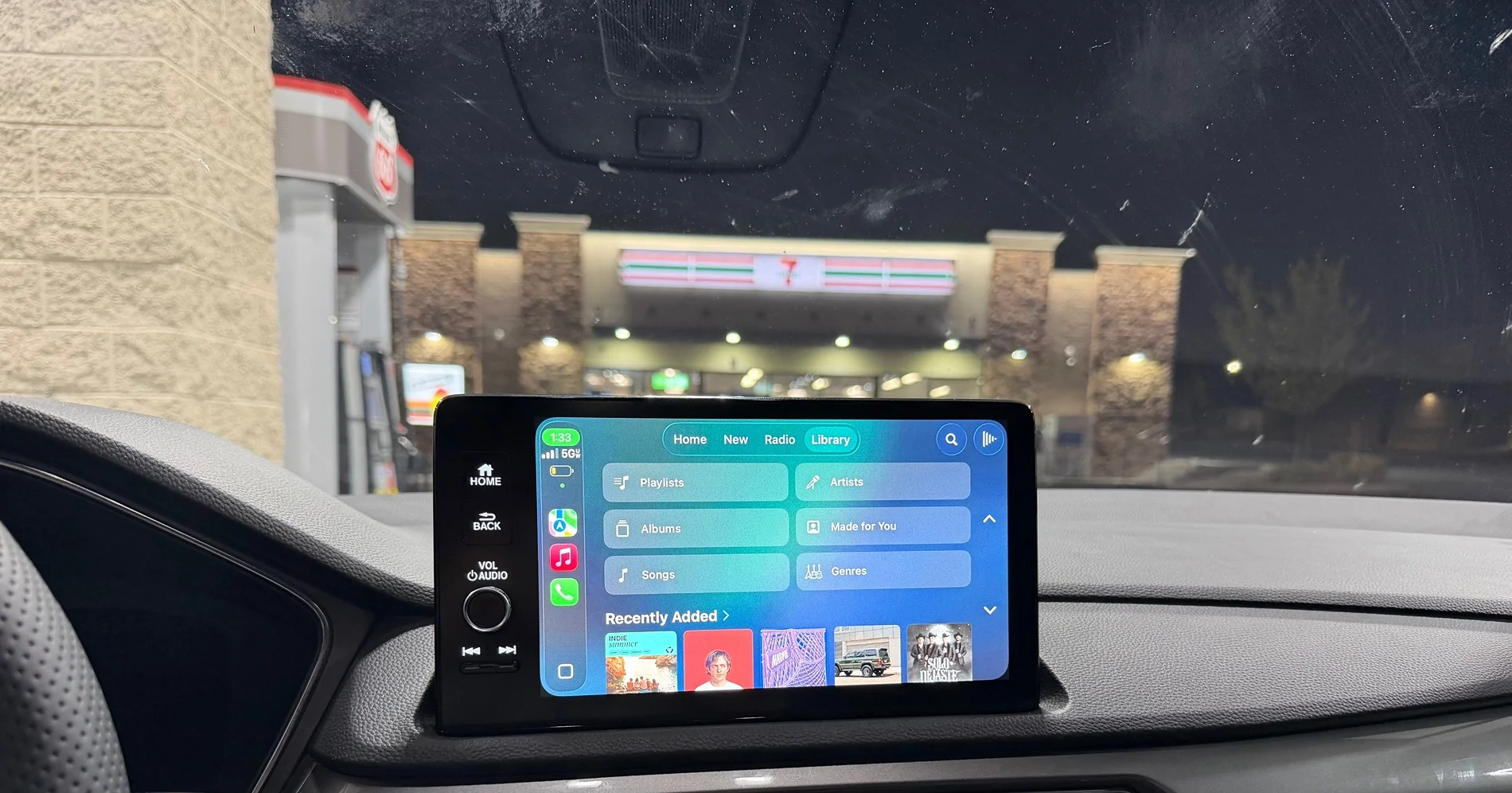

So like the title says I successfully installed the oem 9in screen in my 2023 integra (non tech of course). I worked with a guy on the 11th gen civic forum who is making a harness and I was able to test it before he starts selling it. As of right now the install only works if you use the radio module from a CRV because it had a built in amp. At some point if someone figures out how to do the install with the oem Acura amp I would probably want to swap it out. I would do it now but I have almost zero electrical knowledge haha. Anyways practically everything works! It also adds some new animations to the gauge cluster when using maps. Zero CEL’s and it even shows my vehicle VIN and all my vehicle info. You can still change vehicle settings and it all works perfect on that end. The only problem I have run into is GPS doesn’t seem to work correctly (jumps around and puts me in Florida for some reason while I’m in Utah). I tried replacing the radio module as well as 3 different antennas (oem) and the problem is the same so I’m not sure what the problem is honestly. The only thing I didn’t install was the Sirius xm because it would need a new antenna on the roof. As of right now I’m bypassing the problem by using a wireless CarPlay adapter to use my phone gps instead which works well enough.
anyways just wanted to let everyone know the swap is possible and gonna be available pretty soon!
If anyone has any ideas on the gps issue let me know! Also if anyone wants to buy a CRV radio module for the swap I have an extra I’ll sell you for not too expensive. Let me know if you have any questions! Thanks!
