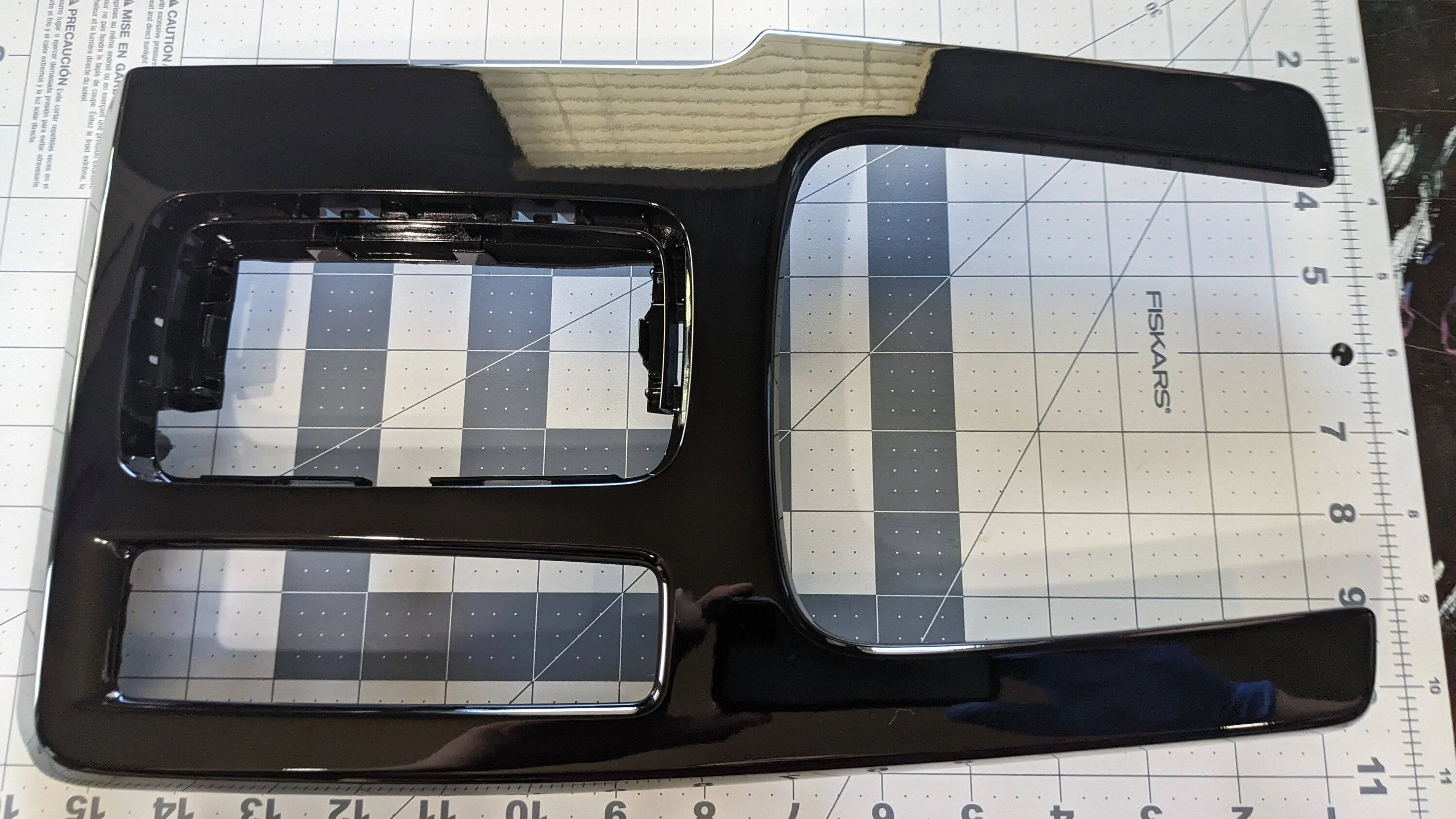

Did you just use something like a plastic pry tool around the edges to remove the trim? I've never done anything like it before and worried about breaking it.
Yep, start at the bottom and work your way forward. Took me a long time to realize that the boot doesn't slip down, instead it unclips on the bottom from the trim and you have to wiggle the trim up around it to remove.
There are three connectors for the various components that need to be disconnected, and then six Phillips head screws to remove the components from the trim once you have it out.

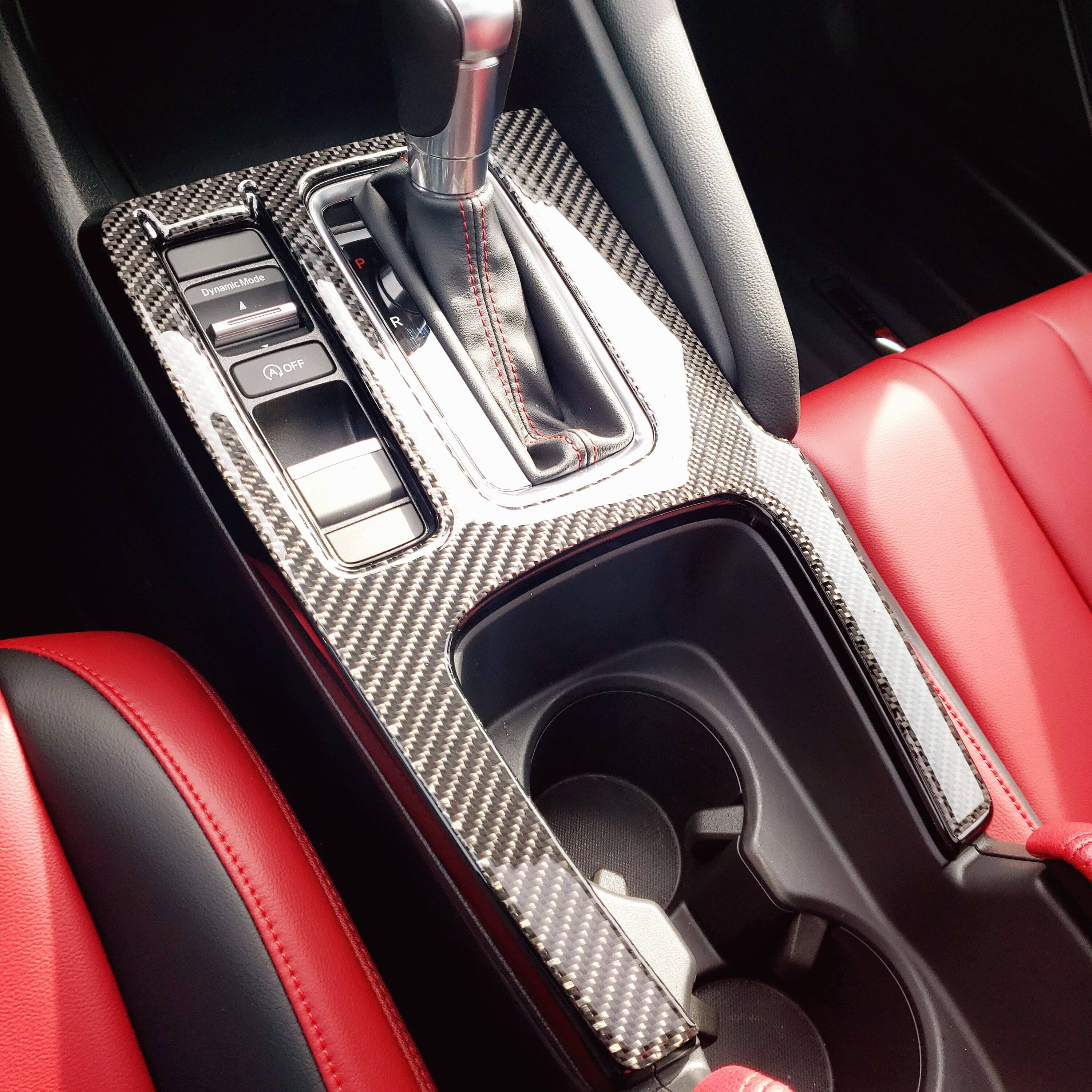

I guess I'm going to spare myself the agony of trying to wrap it, because I saw on the faceyspace that the Etsy shop AUTOCARIMAGECOM has the carbon fiber console trim piece available to order for both the proper transmission and the slushbox.
Order placed.

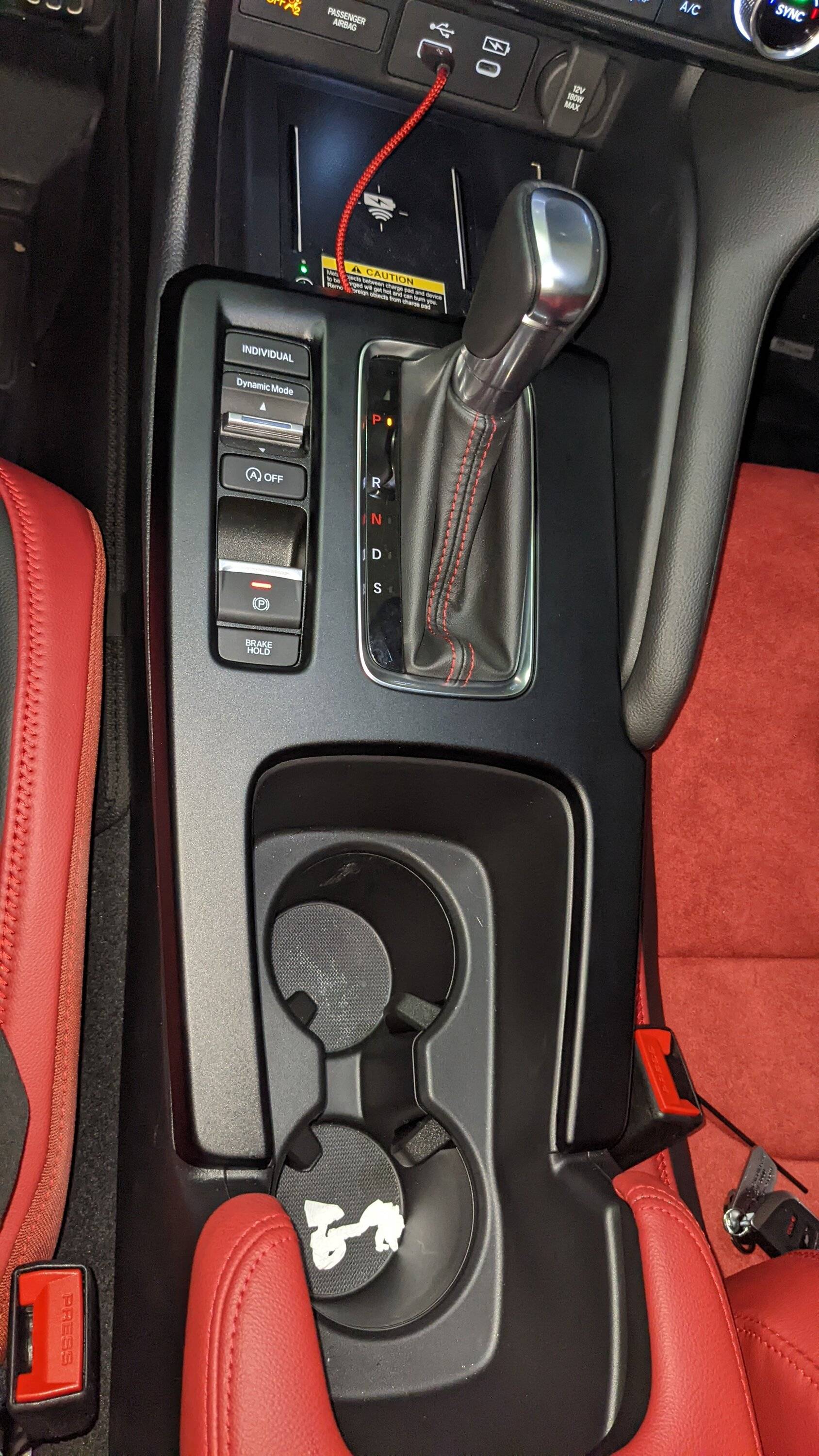

I did this the other day using the matte black vinyl suggested earlier in the thread. Mine wa a 6 speed manual. Work carefully from the back to pop up the 8 clips. Once that is up, I took out the 6 screws holding in the buttons and shifter. Didn't need to undo the connector. Worked out fine.

I ordered it before I saw this post. I was really skeptical about it, but after I got it and put it on. I think it looks pretty good
