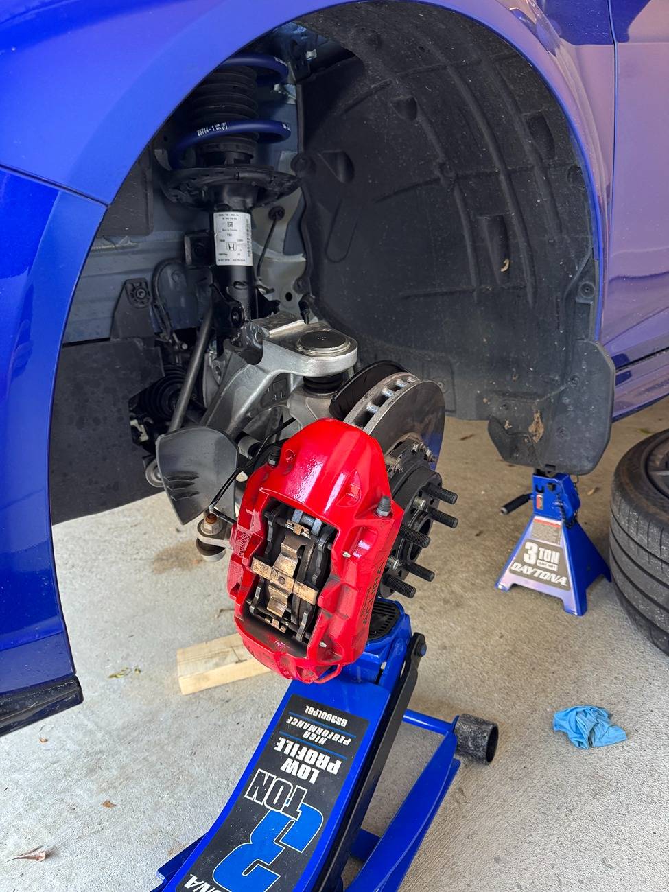

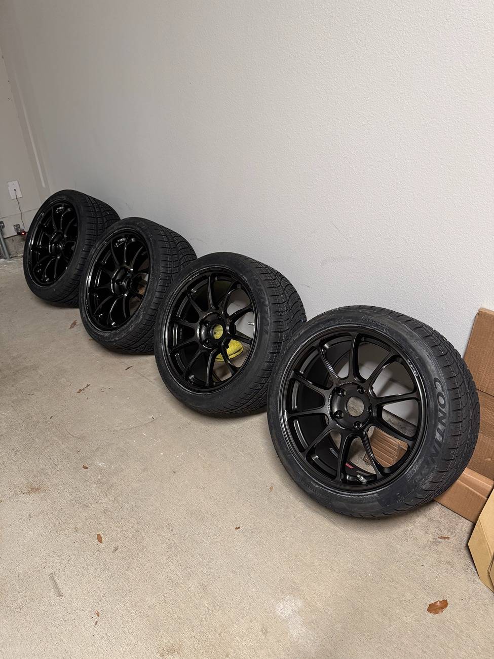

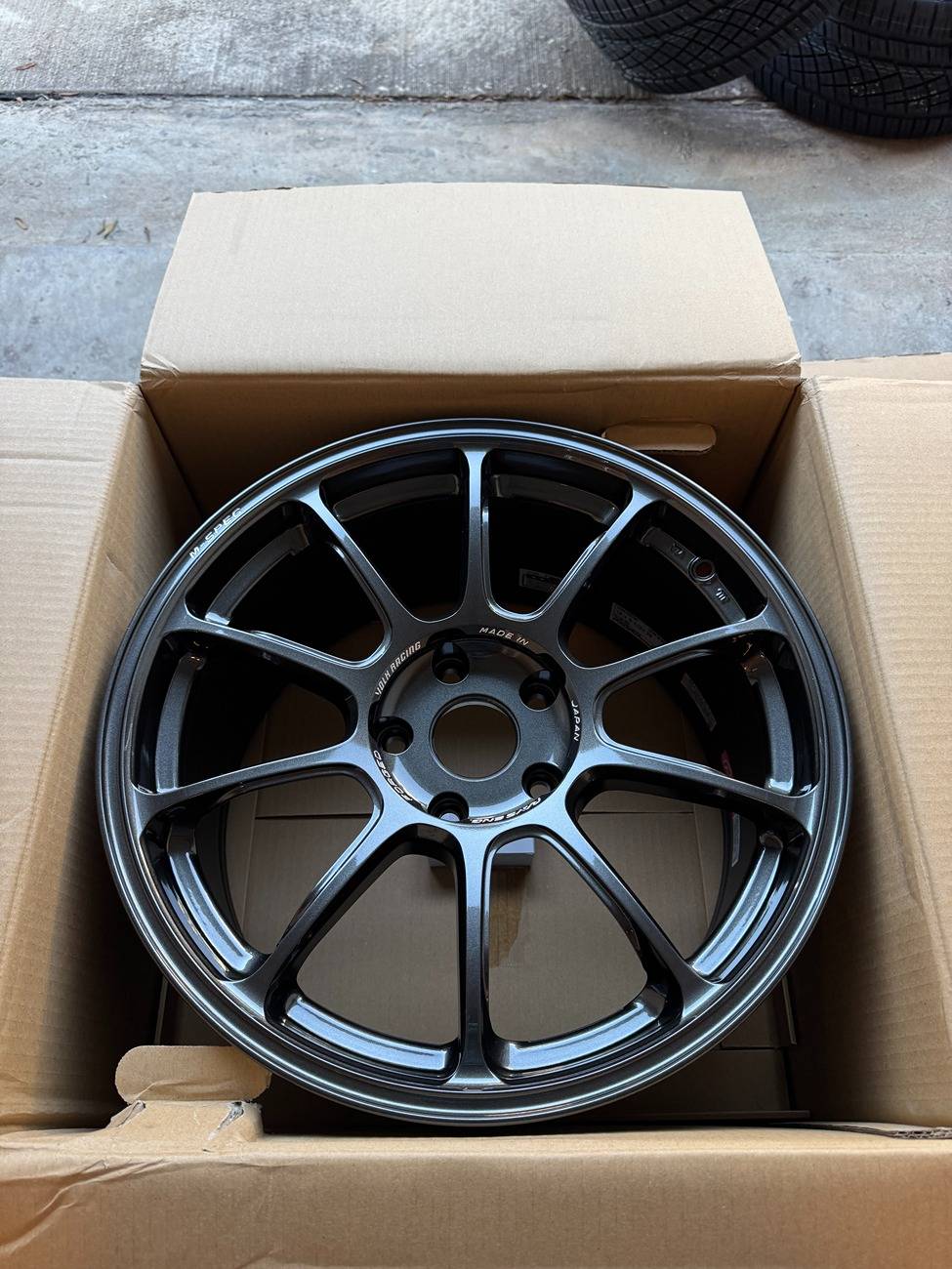

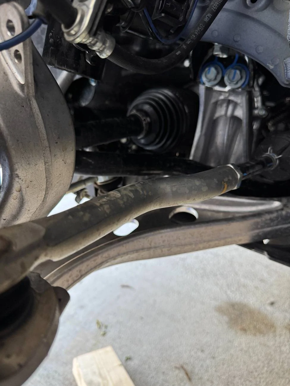

Finally got around to installing H&R lowering springs, new tires mounted on set of ZE40s. Stay tuned for new stance/wheels pic! Only PRL RMM, Acuity stage 2 shift kit, and RSplitter's full splitter kit left to install. If I'm not Iazy, hopefully will do it next month lol.
H&R Spring install:
Relatively straight forward, just a pain in the ass maneuvering the strut out. I did not have an issue installing without backing out the axle nut, axle did not pop out during install. I was however an idiot and left the car hanging without a jack or something to support it overnight - continued install the next day to see the axle indeed popped out. Easy enough to slide back in.

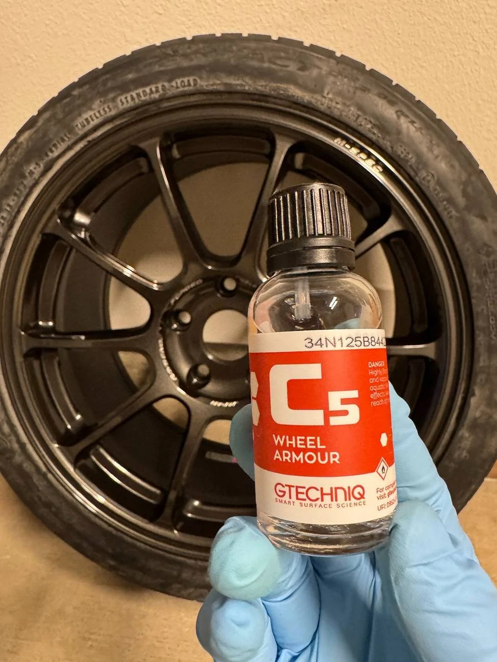

ZE40 18 x 9.5 +39, wrapped in Conti DWS06+ 275/35, and ceramic coat:
Went with GTechniq G5 wheel armour. Used 70% IPA and wiped with microfiber to clean the surface. Applying ceramic coating was easy. Letting cure overnight (instructions say 12 hours).

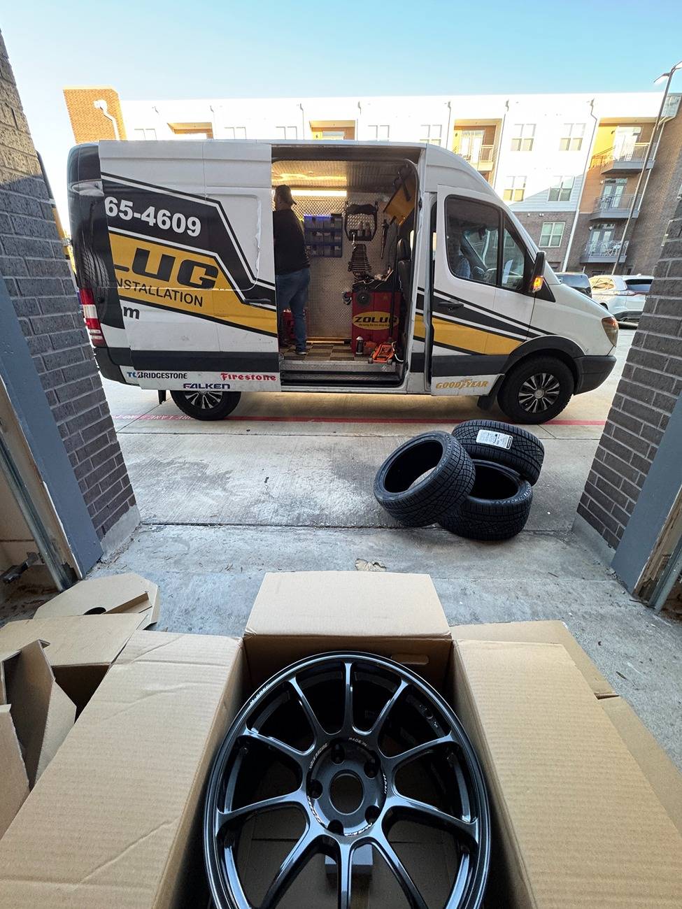

So that van came to your house and mounted the tires on the wheels?
Why tf have I never heard of this type of mobile tire mounting service... could have saved me such a pain in the ass when I was swapping tires every season.
Great wheel choice, excited to see them on the car. Keep us posted if you have any leakage issues; I've seen a few references to that when the axle backs out during spring installs.
Sure did! Paid 100 over what a regular balance/install would cost at a tire shop but thought it was worth the convenience of transporting everything ?
Thanks! No leakage issues (as of now). I was nervous about that also but the boot didn't tear and doesn't appear to have any damage... will monitor and keep you posted.

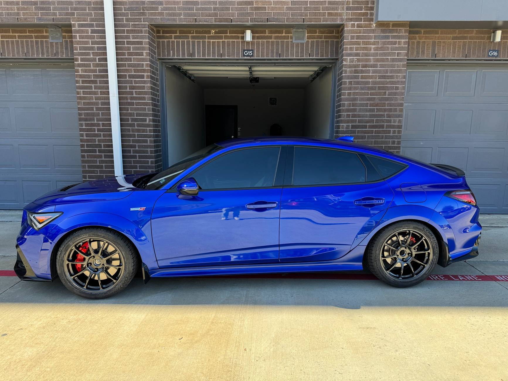

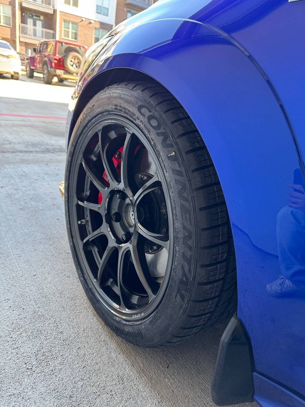

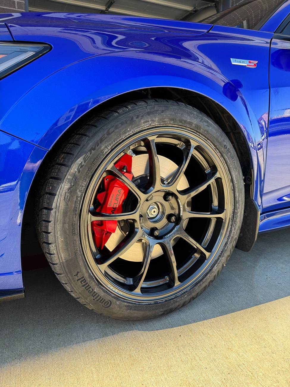

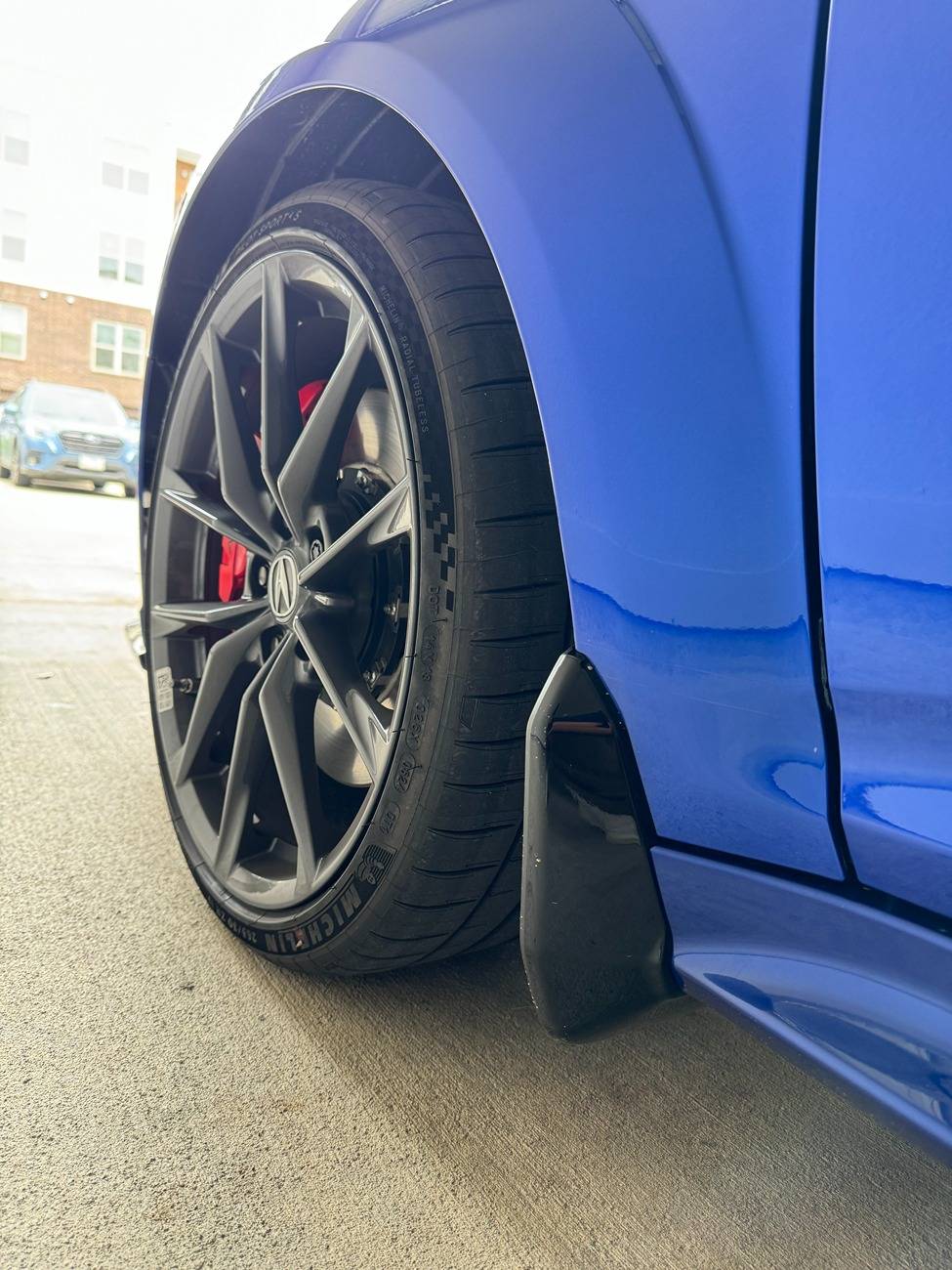

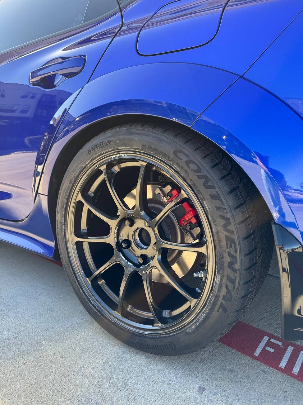

Wheels installed!!! Really happy with the moderate drop and OEM-plus set up. See below for before/after.
Post-wheel/spring install:
Wheel gap and fitment
Before:
After:
Front
Rear

The wheels really do look great, but personally the lack of center cap is painfully obvious. Do you have them coming? What's your plan there?
Agreed - I'm trying to find a set of knockoffs. Can't justify the Rays official wheel caps cost lol.
